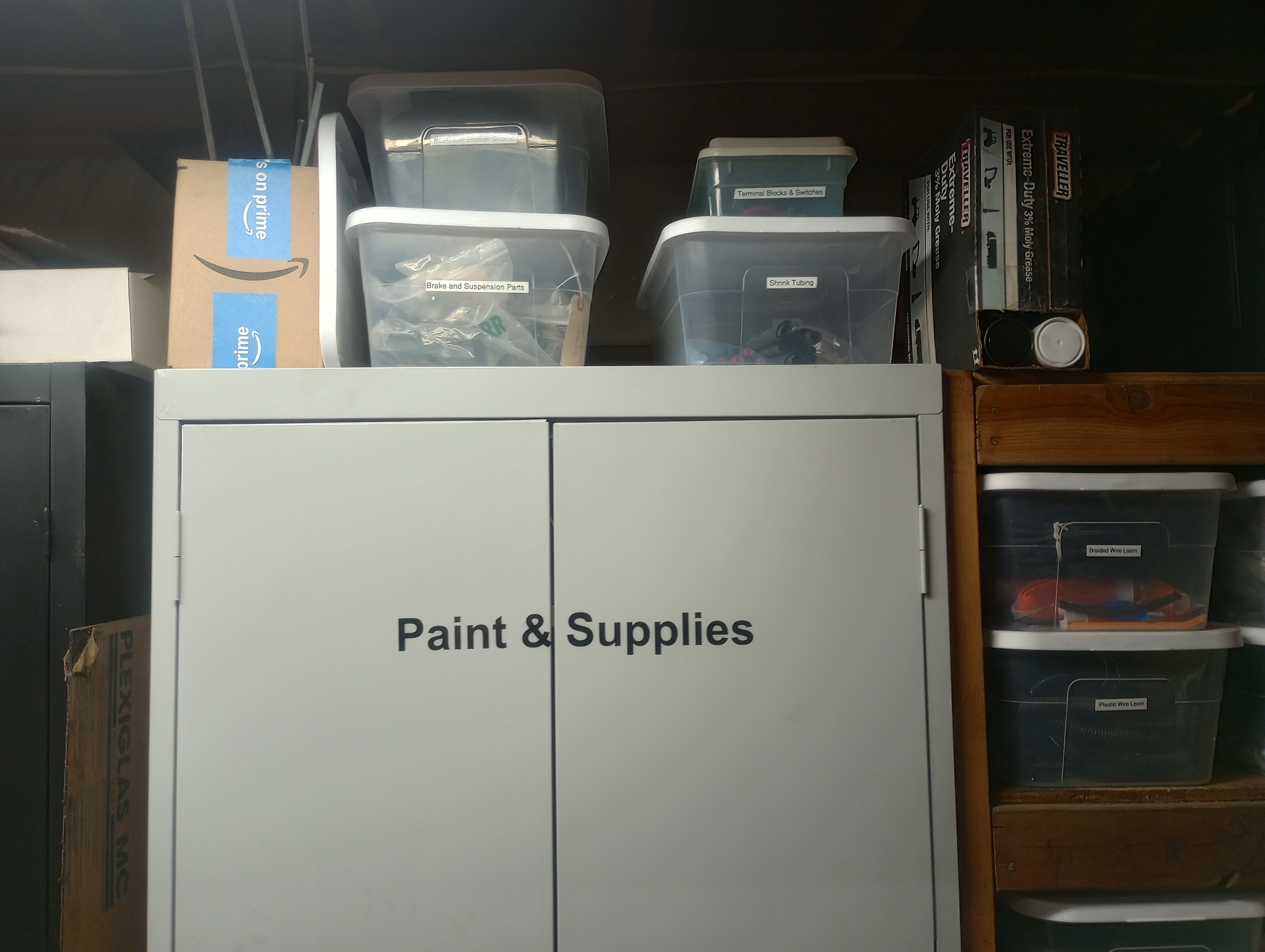

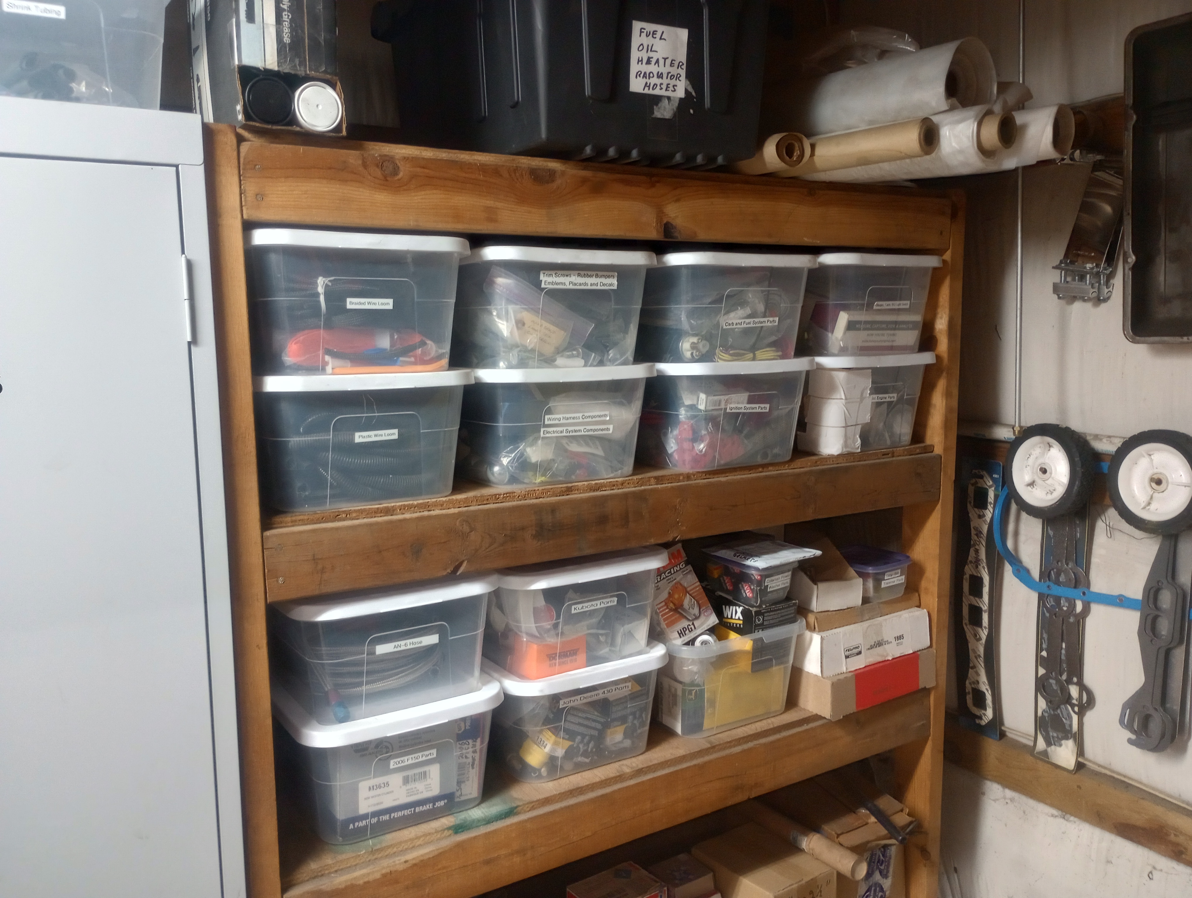

Most of my stuff is in rubbermaid tubs, all numbered, with a master list of contents of each box. Easy peasy.... except I still have several cardboard boxes that are honestly labeled "Moss's box o' crap 1, 2, 3," etc... just tons of stuff from junk drawers, dressers, small tool boxes, etc... Every time I open one it's like a treasure hunt from my past. :p
Keeping on topic... I think there's a Nova trunk emblem in there somewhere! (y)

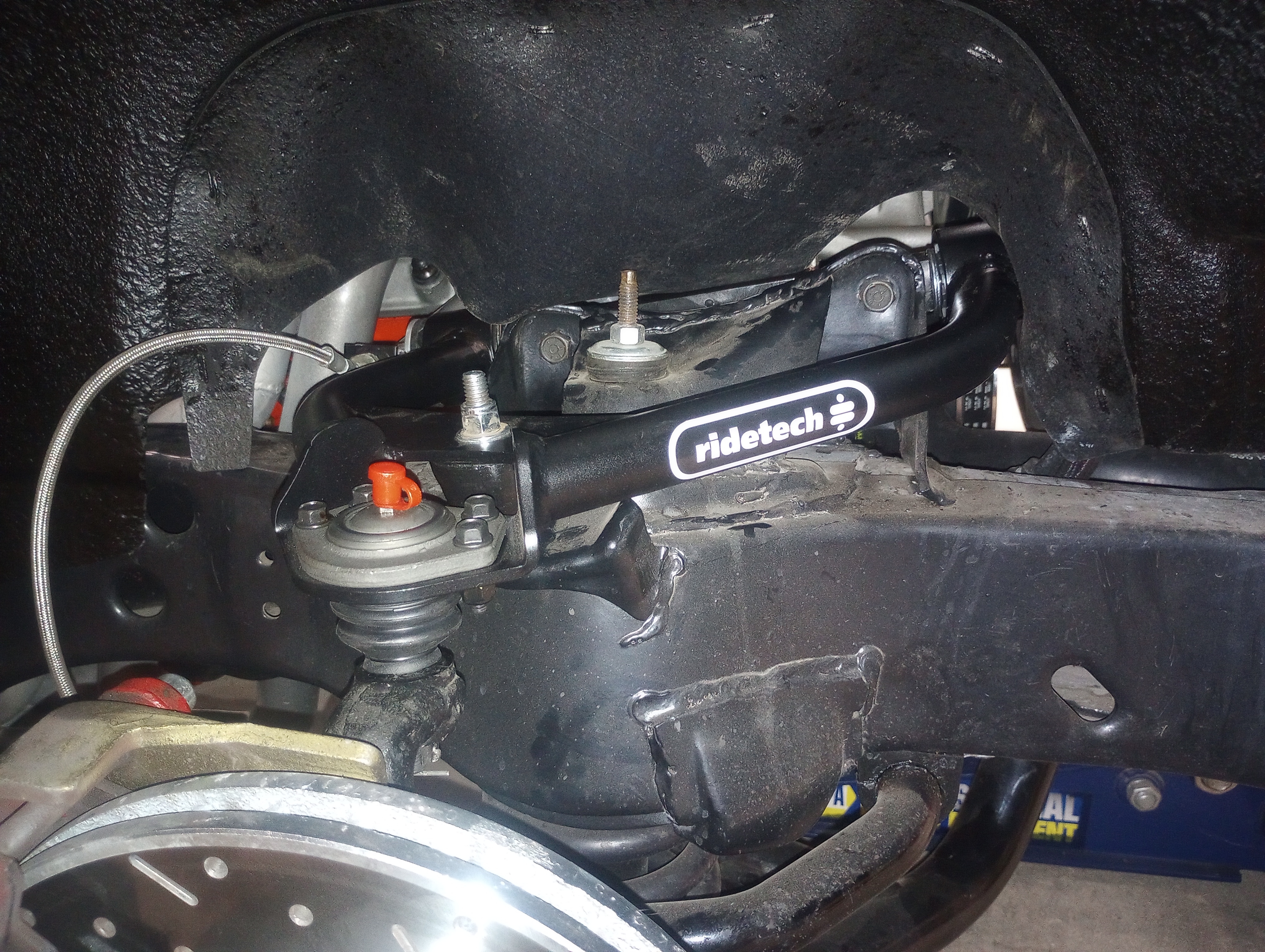

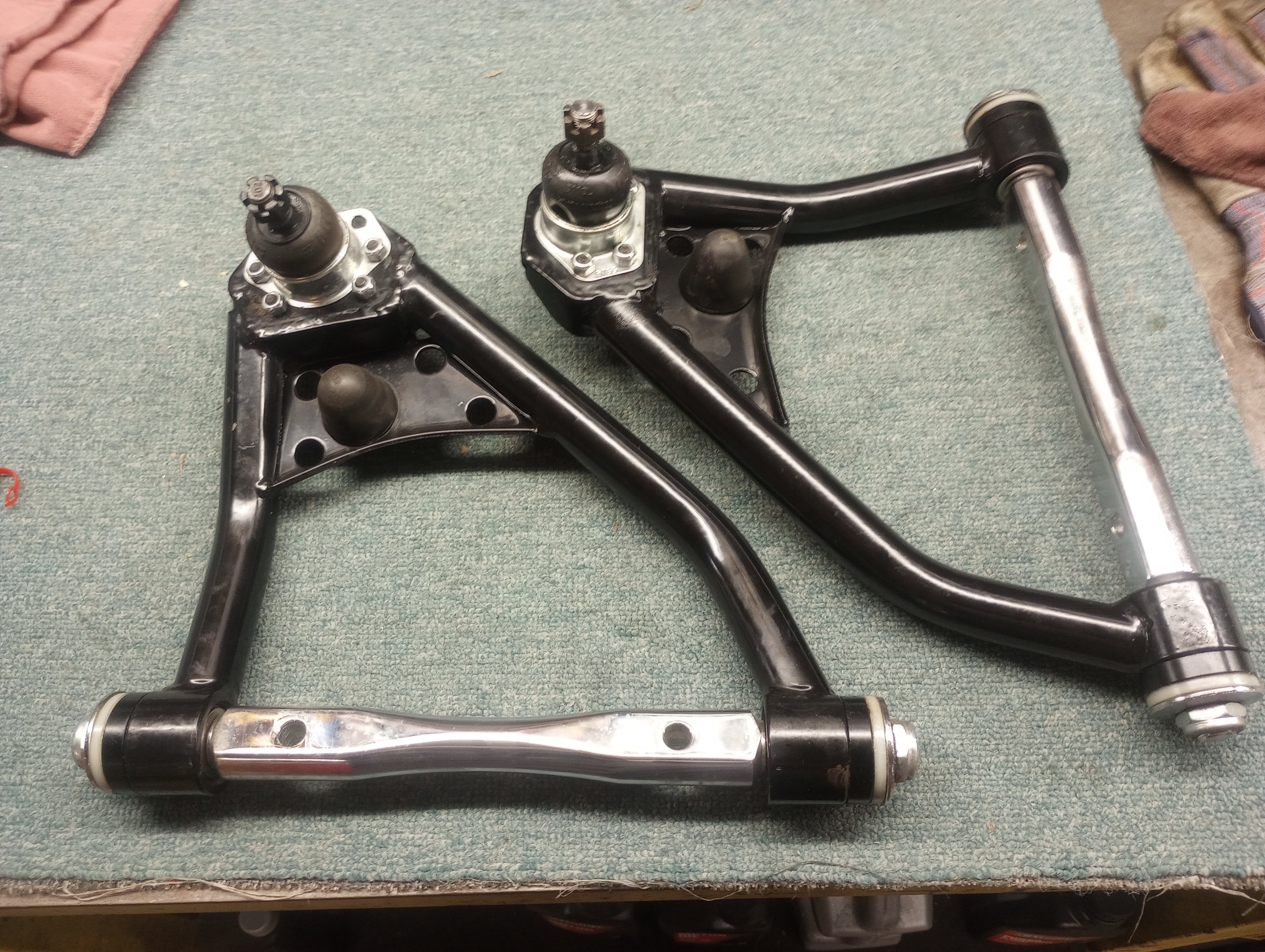

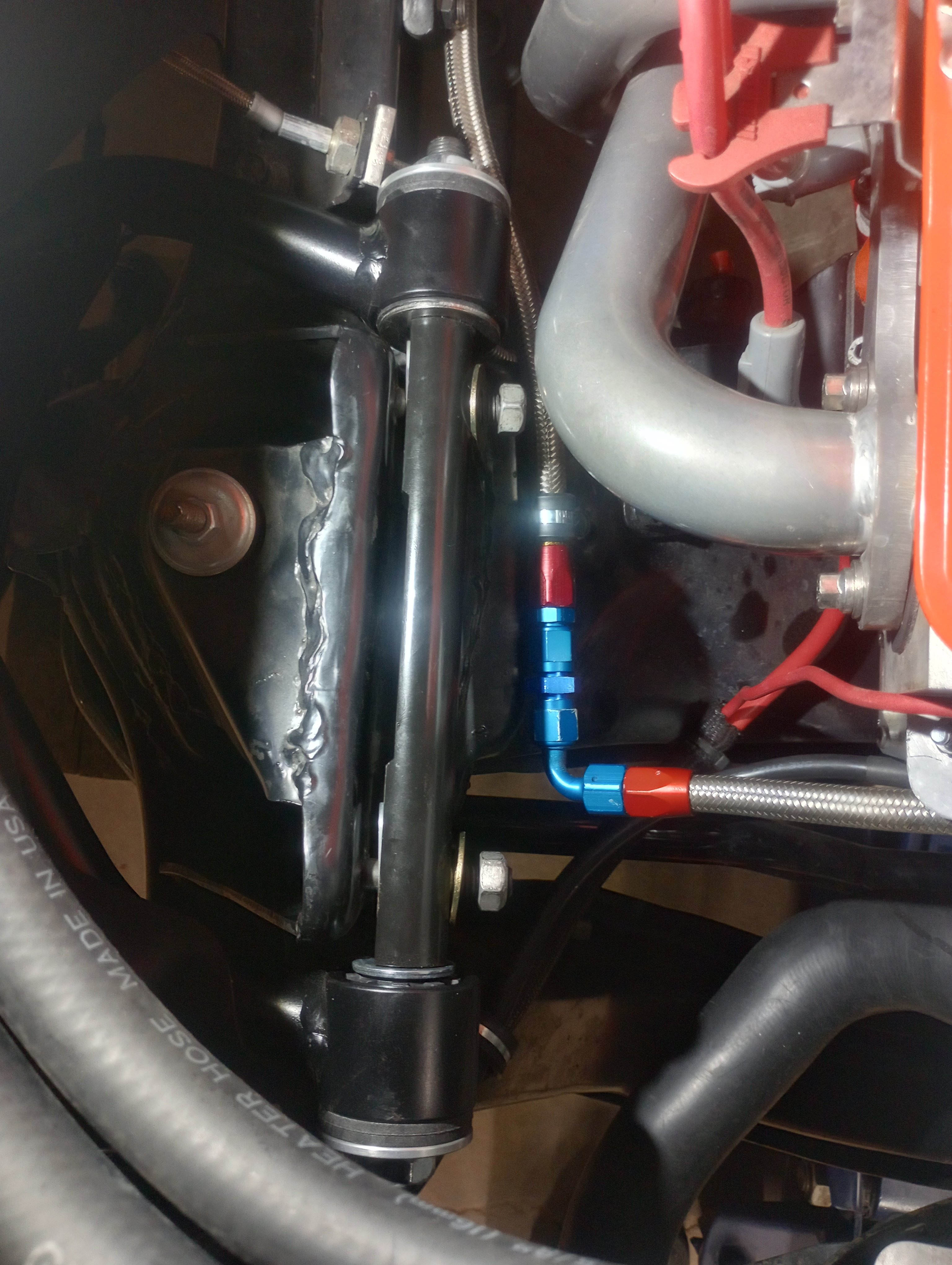

I finally buckled down and changed out the upper A-arms today. It wasn't really a bad job, especially since everything is new and not a rusty POS. Jacked it up, pulled the tire off, loosened the ball joint nut, smacked the spindle boss with a BFH to pop it loose, lowered the lower A-arm down on a couple of blocks to take the pressure off the ball joint, and took the nuts off the bolts through the cross-bar. Due to the proximity of the header tubes, I had to tap the bolts loose from the subframe bracket and pull them out to be able to remove the A-arms. The driver's side was a little more involved, I had to loosen the power steering pump and push it in as far as it would go to get the A-arm over the front bolt, as there was no room the get a hammer in to knock it out. Got them all bolted back in, greased the ball joints, put the tires on and torqued the lug nuts. Total time, about two hours.
Before I installed the new A-arms, I measured the offset from the rear cross-bar bolt hole to the ball joint on both sets of A-arms, and as I figured, there was about 3/8" difference, moving the upper ball joint to the rear on the old passenger side A-arm, which explains the amount of excess caster when it was aligned. The new A-arms are made to accept adjuster slugs that have different amounts of offset to allow them to be moved forward or rearward if necessary to adjust the caster. I used the ones with no offset, but I have other slugs with 1/4" and 3/8" offset if needed. The cross-bars are made with one of the faces that sit against the mount offset, to allow more range of camber adjustment, I installed them so the alignment shop can add shims if needed.
Monday I'll give the alignment shop a call and get it realigned. Hopefully, that will get rid of the slight pull to the left it has had since the last alignment.
The old A-arms.

I have a bunch of plastic tubs from Target that I store parts in and label them so I can find what I need. At least it narrows the search area down when I'm looking for something, normally.
