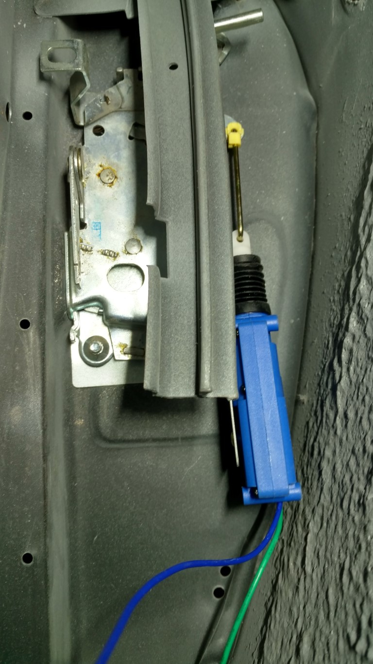

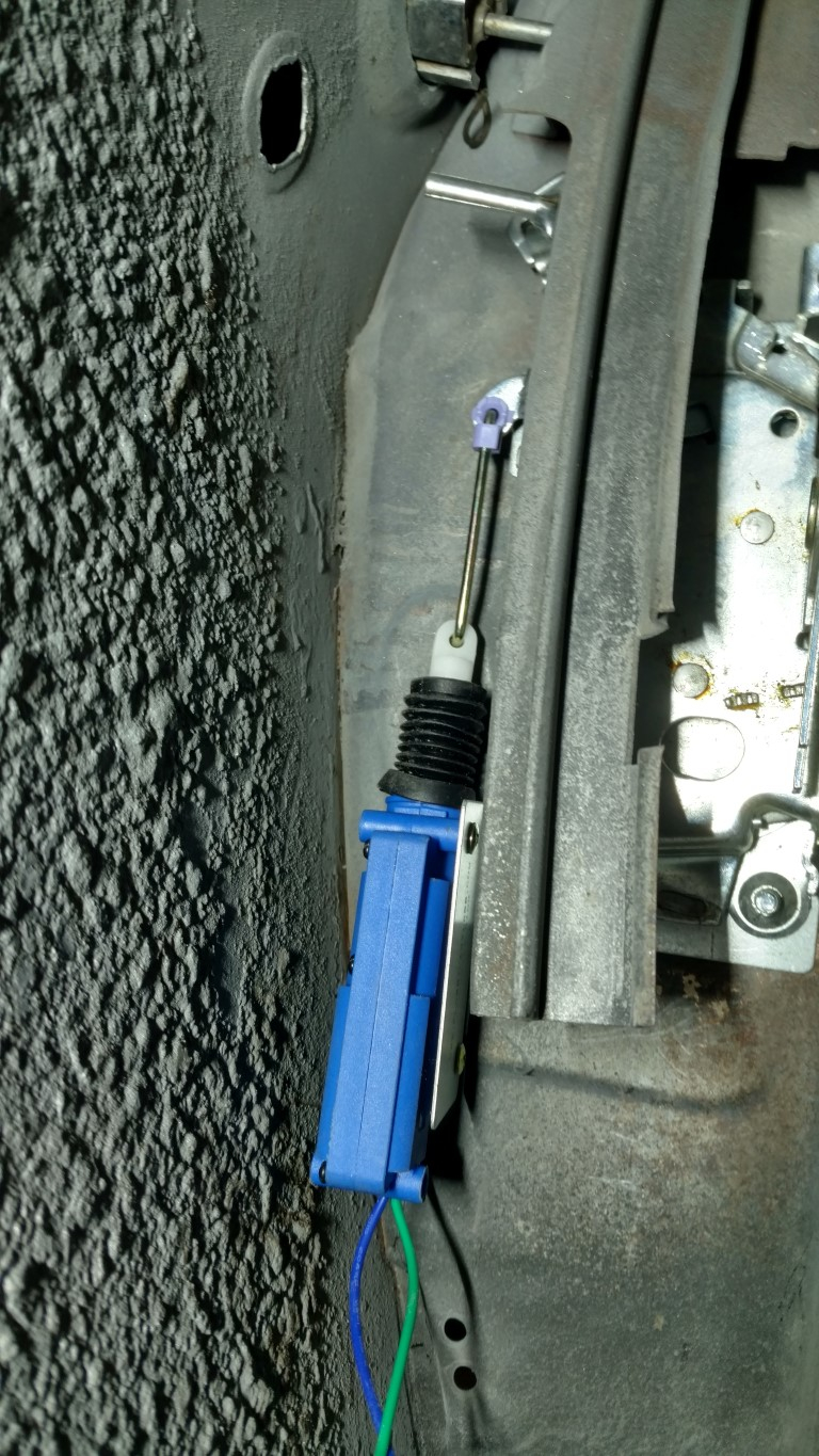

This afternoon, I got the actuators installed in both doors of the Nova so I'll have remote/keyless locks in the doors, They were easy to install, screw the actuators to the mounting brackets, remove the latches from the doors, drill out a hole on the locking lever and install a retainer clip for the link from the actuator. Reinstalled the the door latches with the actuators and was done. Was a pretty easy job.
Still need to run the wires and install the ducts from the door to the body that they run through, but I need to mount the control unit first.
I'm also mulling over putting a connector in the wires so the door can be removed without cutting the wires. I have several types that will work, just need to decide which one to use.

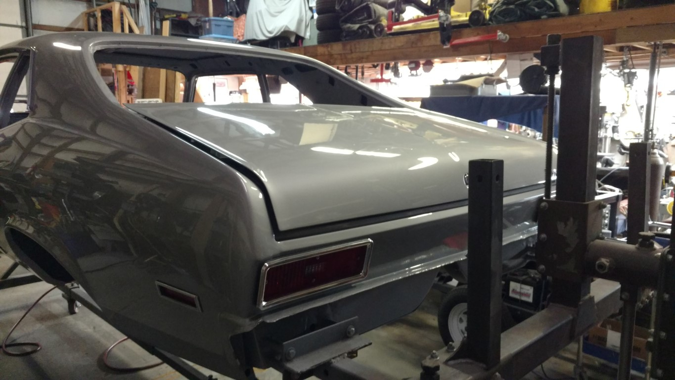

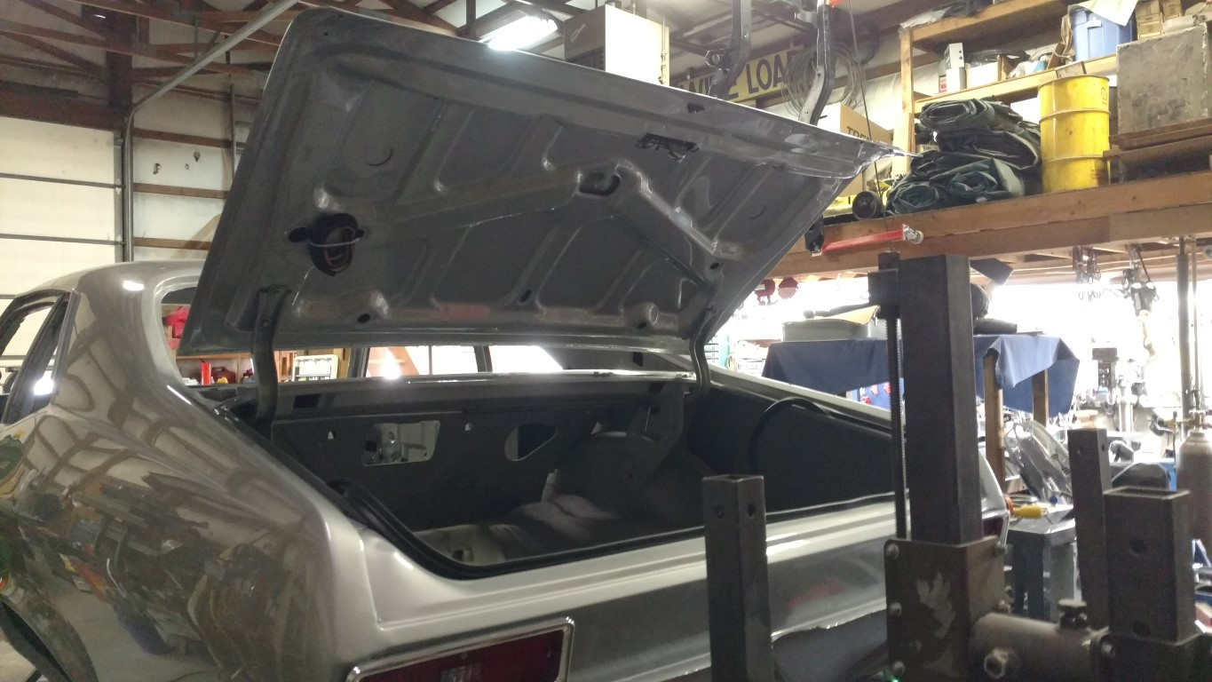

My friends came over this afternoon and we got the trunk lid put on the Nova. It took a little adjusting, but it seems to fit pretty well. The torsion springs seem to be adjusted just right, as from closed to open about a foot or so, the lid will stay where you put it. I have to repaint the catch that the lid latch locks onto, because the paint wrinkled up on it, and it looks like crap. I'll blast it and paint it again to morrow, if we don't get blown away, some nasty storms are predicted tomorrow.

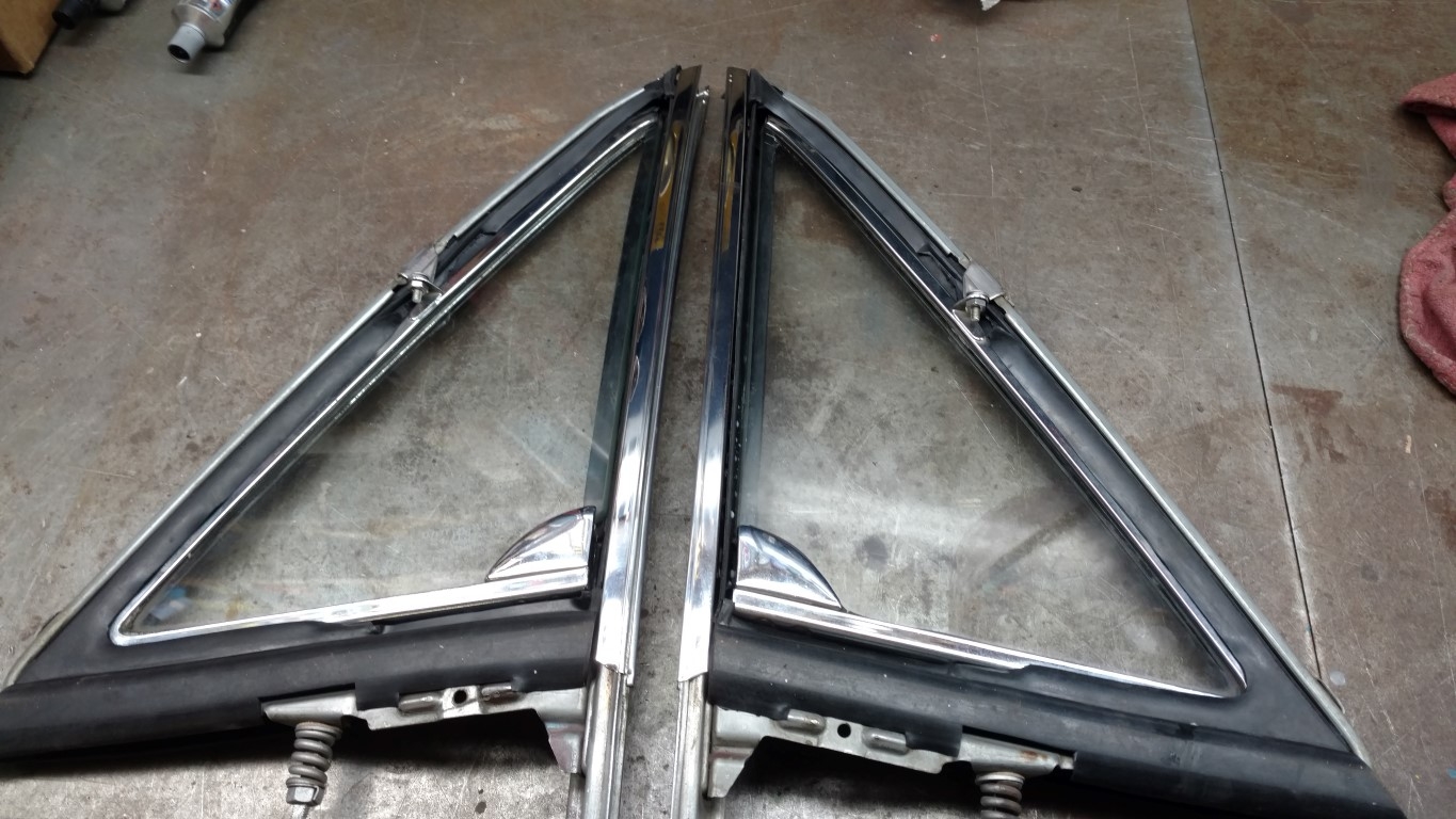

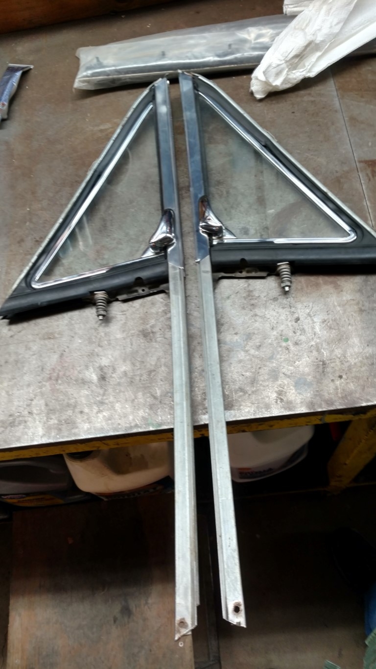

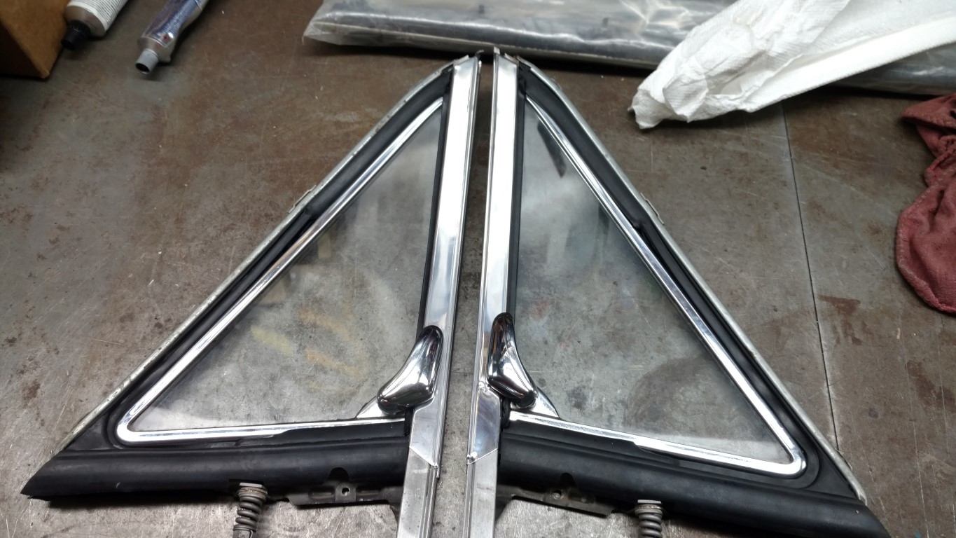

So, I have been working on the vent window assemblies, getting the new seals installed, mounting the windows in the frames, assembling the friction washers in the correct order, and installing the stainless trim on the inside and outside of the vertical tracks.
As usual, tracking down the parts takes 10 times as long, or more, as it does to install the parts. This was the case of the stainless trim pieces. After searching through every likely storage box, I finally found them wrapped in paper towels secured with rubber bands. I unwrapped them and got the ones for the passenger side installed, and the onside piece for the drivers side installed too. But, I couldn't find the one for the outside of the driver's side. Back to searching through boxes and anywhere I might have stashed it. Another search for the channel the door glass slides in came up empty too. Apparently I never ordered those, so I ordered those this evening from ChevIIOnly, should have them in a couple of days, then I can get the door glass in and get the doors fully assembled.
Once I get them done, I'll pull them off and roll the body upside down and get to work on the headliner.
