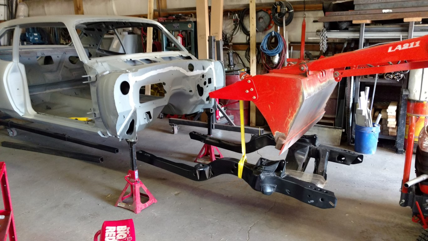

Gave the blower motor another coat of paint, let it dry while I cleaned out the inside of the car, including vacuuming out all the pieces of wire insulation and metal chip from drilling holes. After a neighbor stopped by to drop off his chipper that won't run and shooting the bull for half an hour, I installed the freshly painted blower motor, hooked it up the the battery to make sure it ran and didn't rub on the housing.
Rolled the body upside down, heard a few things roll around in the trunk, I know I lost a couple of connectors back there, and I see I need to readjust the balance as it's pretty top heavy.
Drug out the two boxes of DynaMat sound deadener I bought probably 10 years ago to put on the roof and floor to quiet and insulate the car. I set up a folding table and cut some pieces to put on the roof. I'll work on installing them tomorrow, probably. I may work on the chipper first.
By then it was after 5:00PM and I had to go to a friends house to set up a WiFi network at 6:00PM, and after sweating all afternoon, I needed to clean up and change clothes so I didn't smell like a wet dog.
