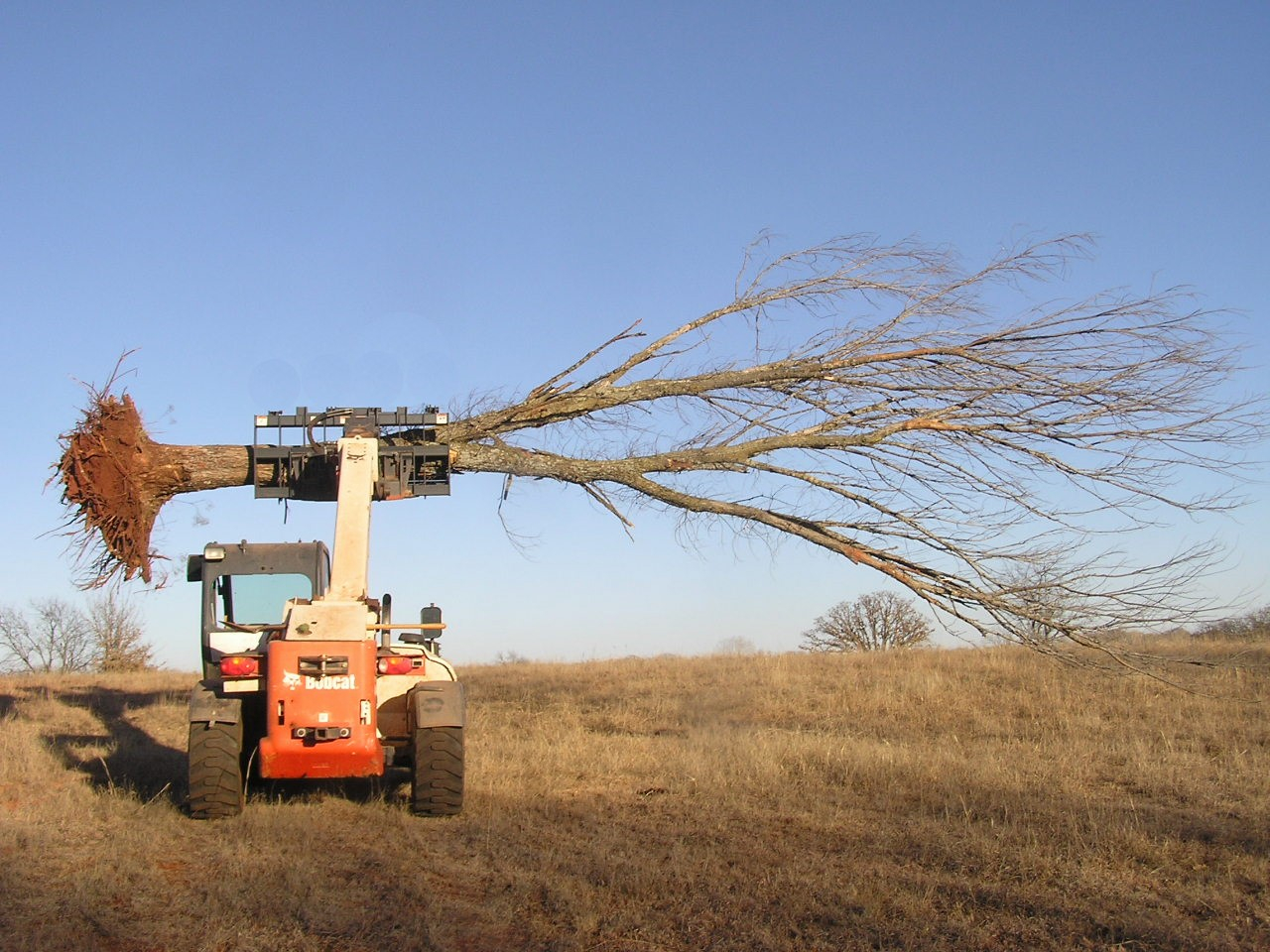

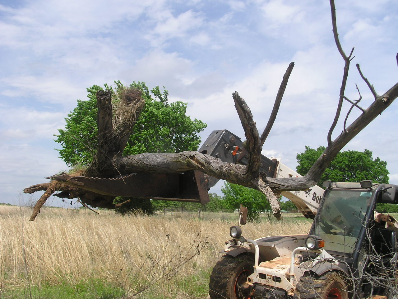

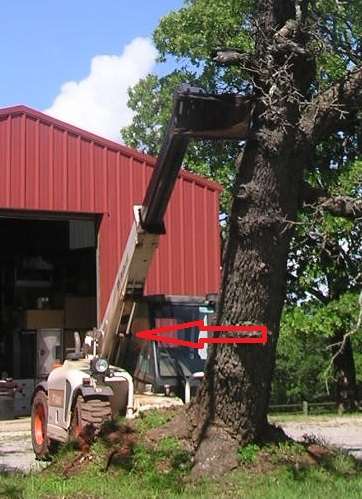

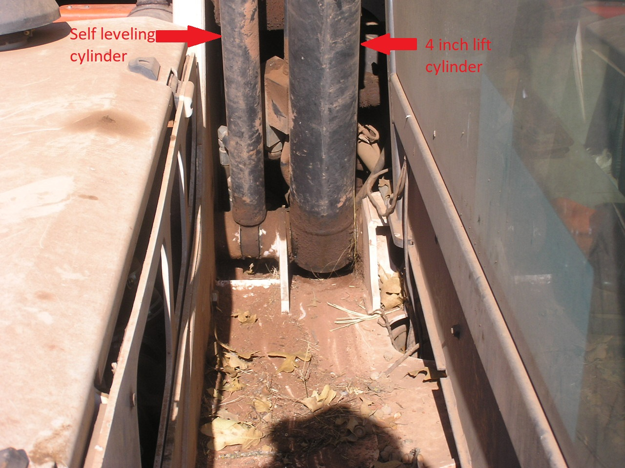

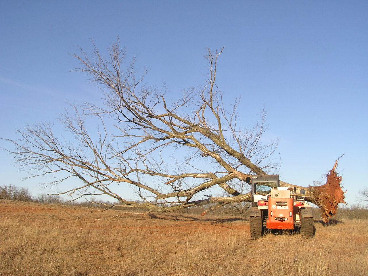

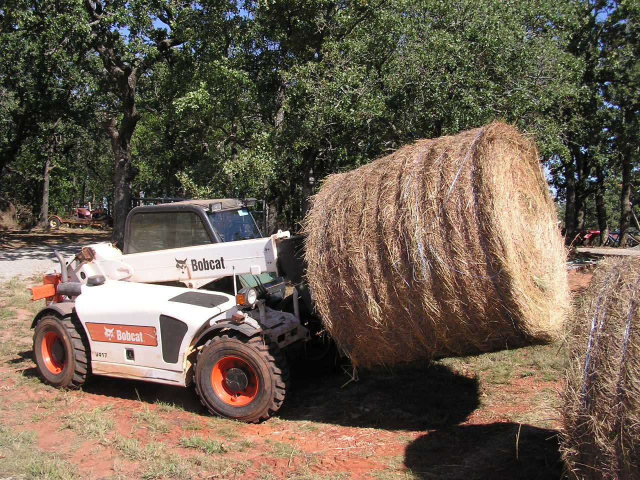

I have the "PERFECT" loader for me: Compact telehandler
It has a self leveling loader:

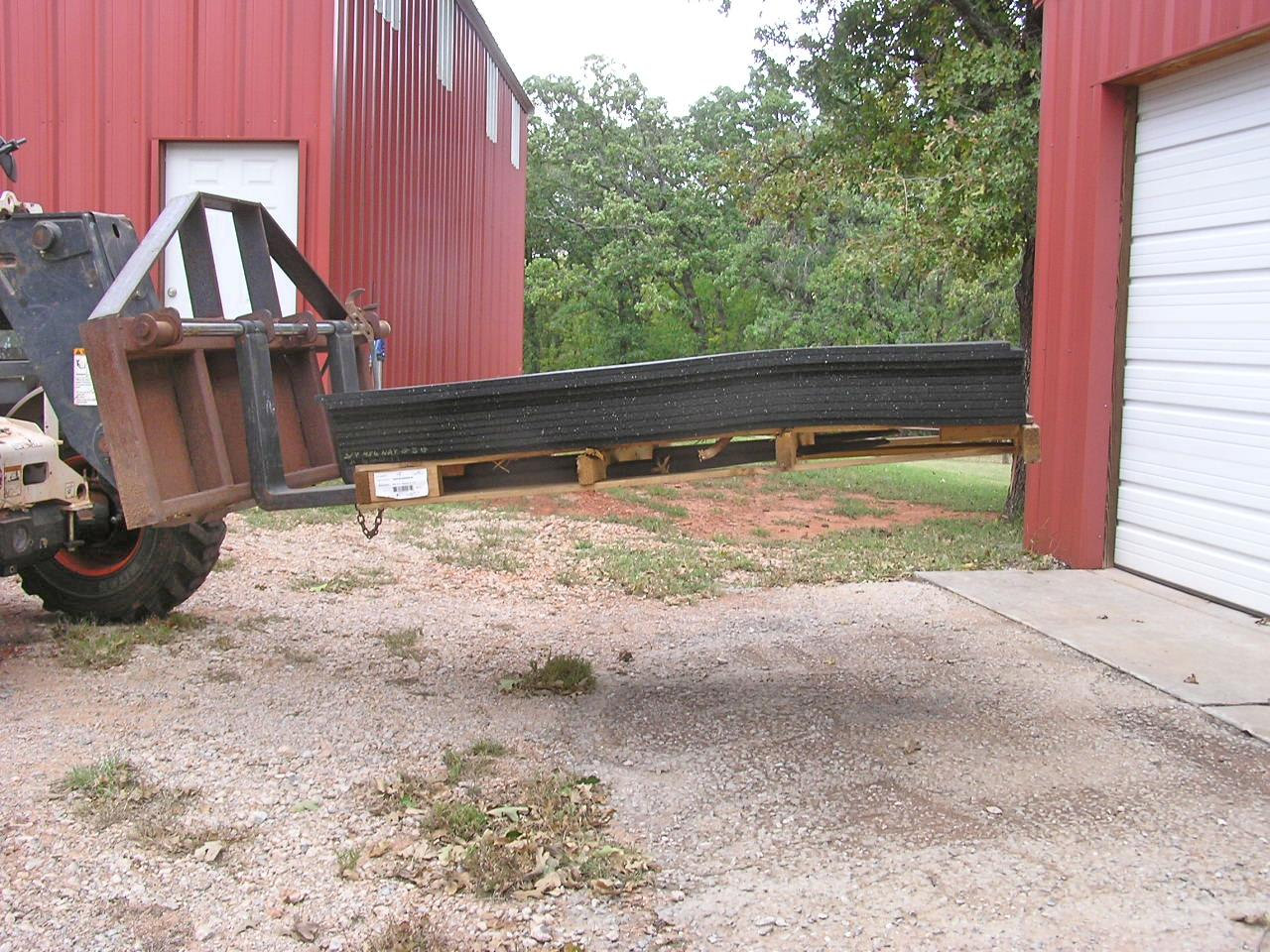

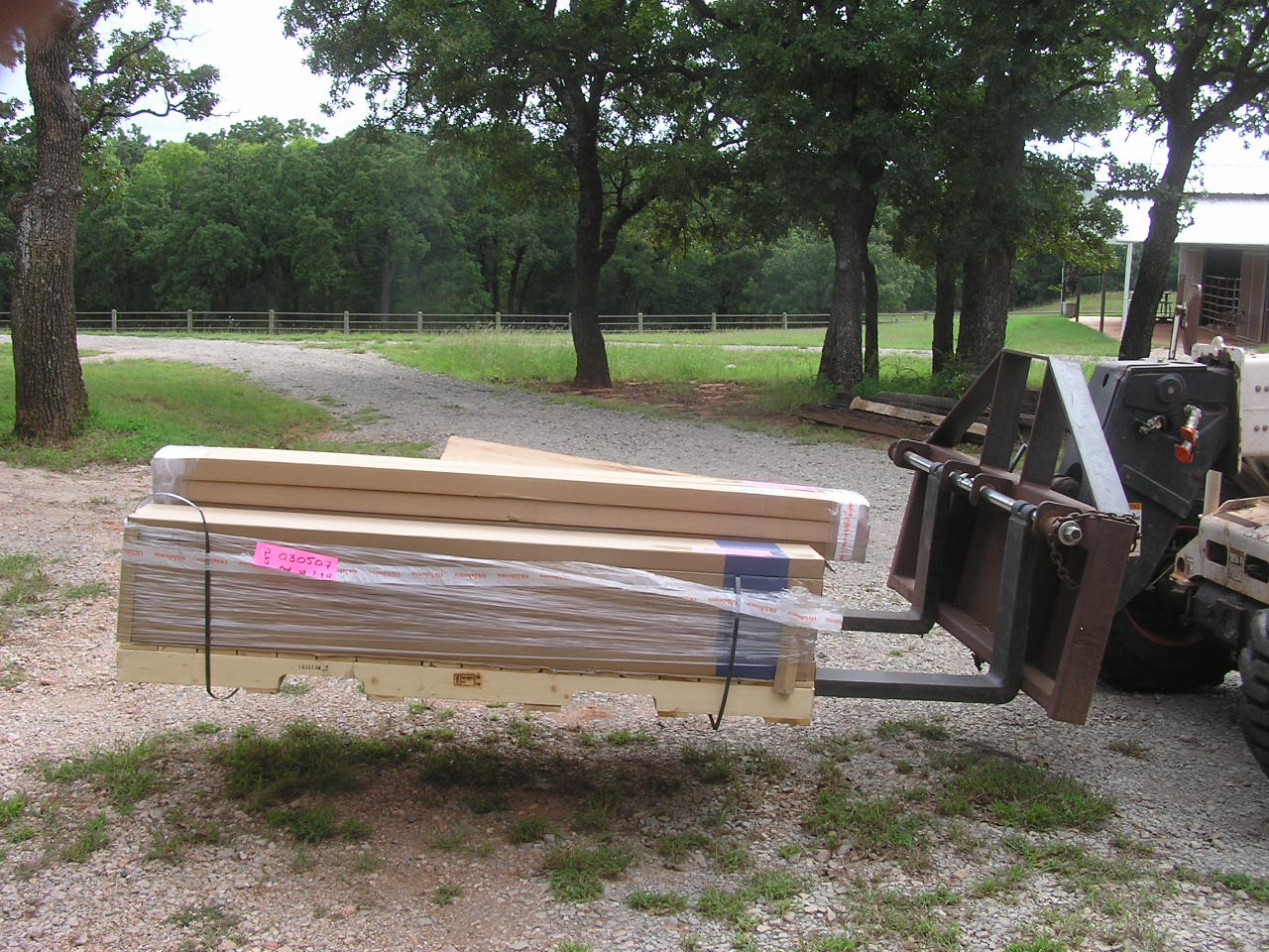

Real handy with the 6' forks:

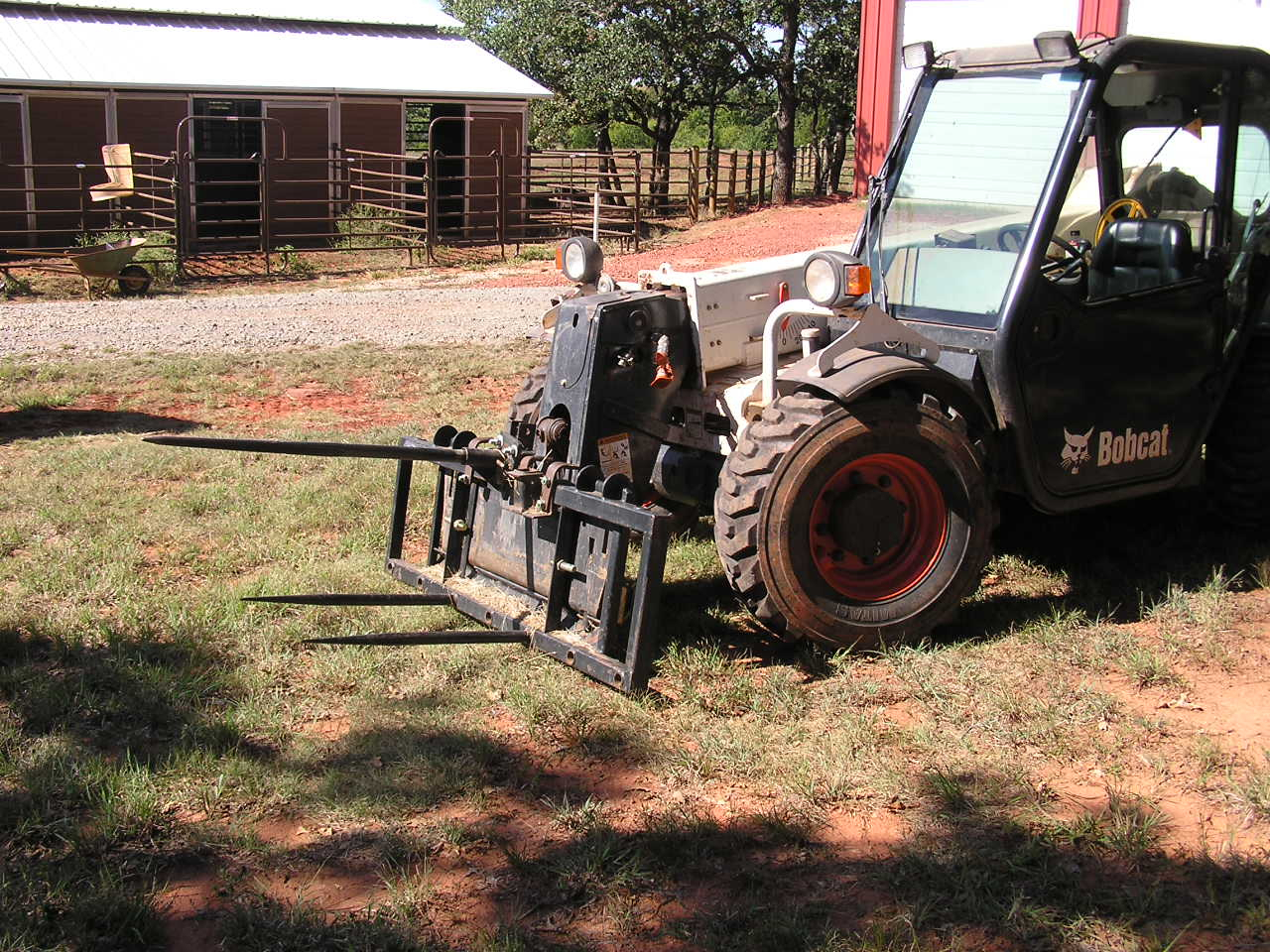

And the bale spear:

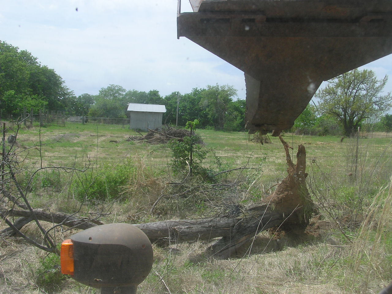

And for taking trees to the burn pile:
/ Resolving self leveling dislike #85
/ Resolving self leveling dislike #86
Yep, I remember that feeling from before I got the little compact telehandler:

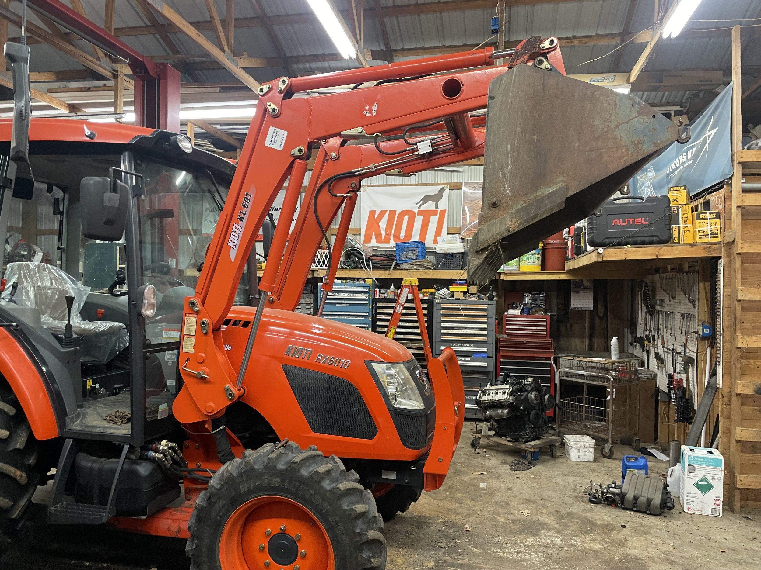

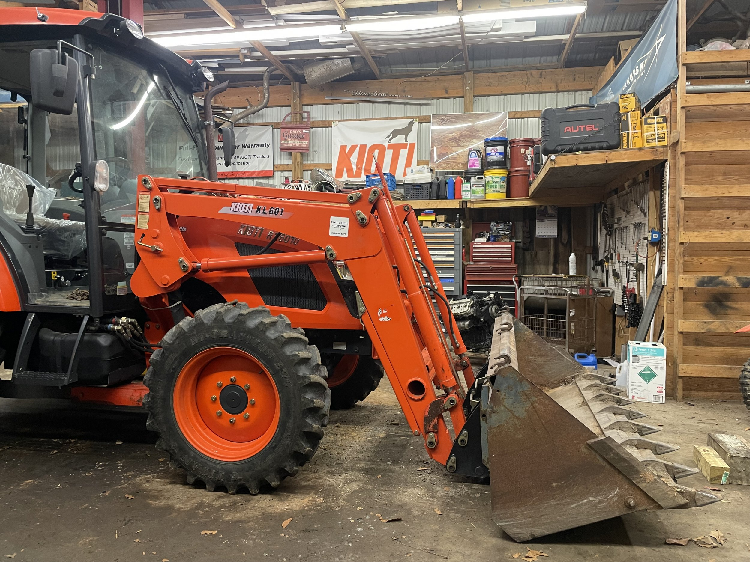

I got some pictures of my self leveling loader this morning;
at full dump;
and at full curl back;
Even with the less expensive and clumsy bale fork that sits on the bucket edge there would be no proble
with a bale falling off.
I like the self leveling 90% of the time.
When I'm chasing the last of a pile it would be nice to have more curl back to get what was in the bucket to the back and chase some more.
Loading out of a pile I have no problem getting a full bucket.

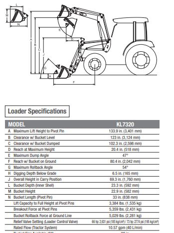

The self leveling loaders on this side of the pond, seem to get way more curl that what I've seen on this thread.
image;s=1000x700

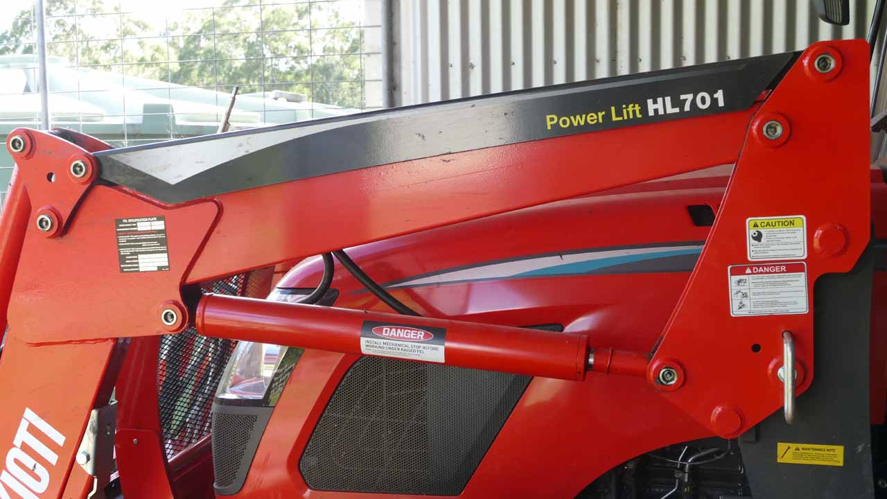

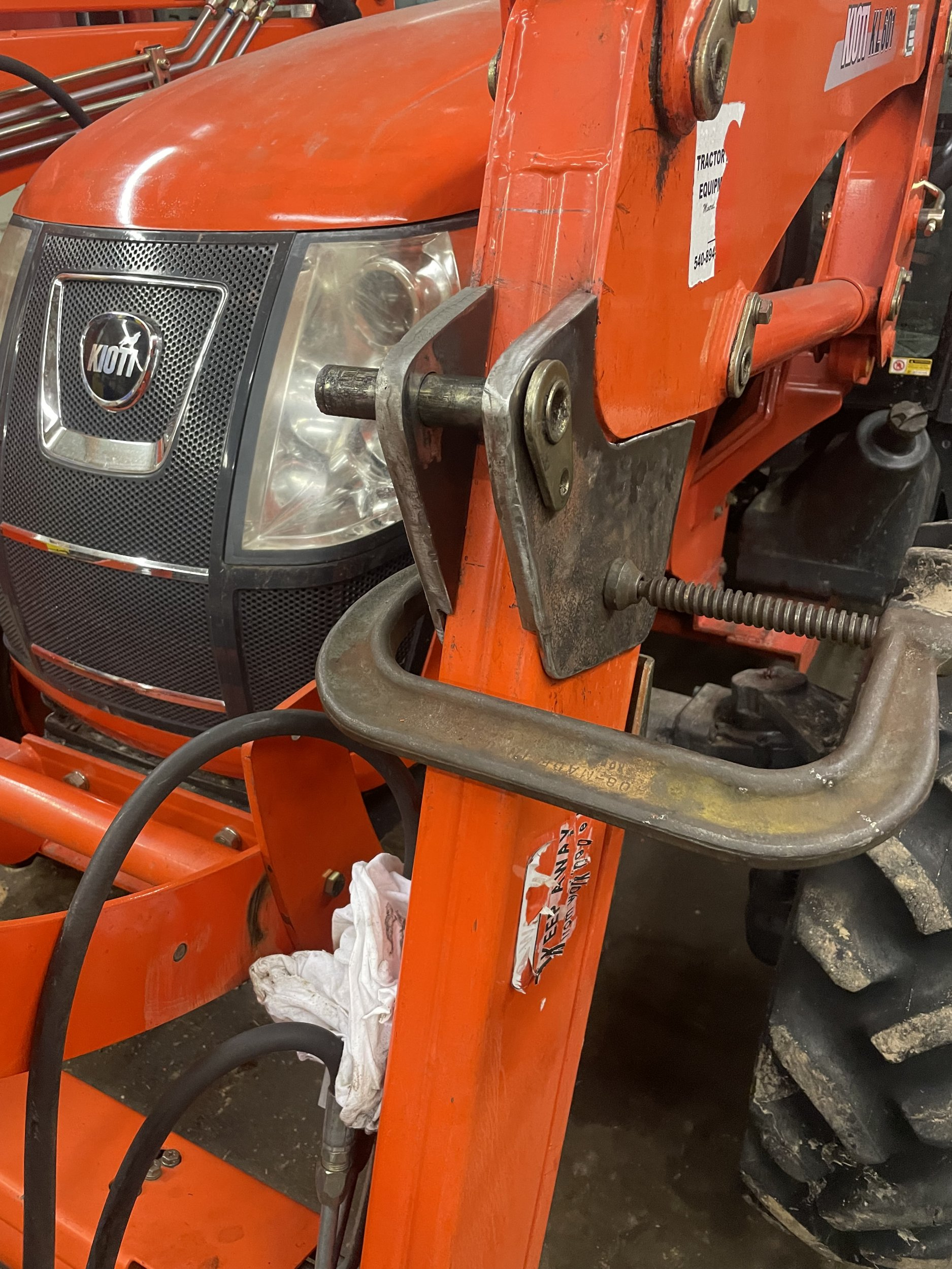

Started fabricating the parts to mount the new cylinders, the cylinders are 2 1/2" bore X 20" stroke with a 1 1/2" ram, this should allow me to stay within the 80% stroke rule for the cylinders. I have been checking measurements and dry fitting everything to make sure I am able to achieve what "I" am looking for in a usable loader. One of the pictures is of the template for the cylinder mounting brackets.

/ Resolving self leveling dislike #92
You do nice work, and I don't doubt your plan. Help me understand how putting shorter cylinders on increases roll back?

Exactly, my quick attach plate with the self-leveler, fully retracted at floor level sets at 90 degrees to the floor, I am looking to accomplish somewhere in the 70 degree range, that should allow plenty of rollback for the bucket.
#96
Airbiscuit, forgot to mention that while the cylinder length is actually shorter the actual ram extension is longer by about 6 inches. Most or at least half of the dump/curl function on a self-leveling loader is done by the mechanical movement of the triangular brackets pushed by the raising or lowering of the loader arms.

The 1.5" diameter rods you mention on the new cylinders caught my attention wondering if that is going to reduce the curl force significantly. The 1.5" rod inside 2.5" bore leaves only 3.14" (just a coincidence?) of area.
1.0" diameter rods would leave 30% more area but would also bend much easier. I suppose 1.25" diameter rods are a happy medium with 2.5" bore? (Just thinking out loud here)
I'm betting that you've considered the area of the 1.5" rods and feel comfortable with it?
/ Resolving self leveling dislike #99
I don't have an opinion on the rod size. All I know is that the curl function on every loader I've ever had has always been way more powerful than the lift function. I always attributed that to leverage and geometry.
#100
I did ponder the 1.5 dia rod vs the stock 1 3/8" rods and after discussing with the cylinder tech support group we felt this would be a good choice.
