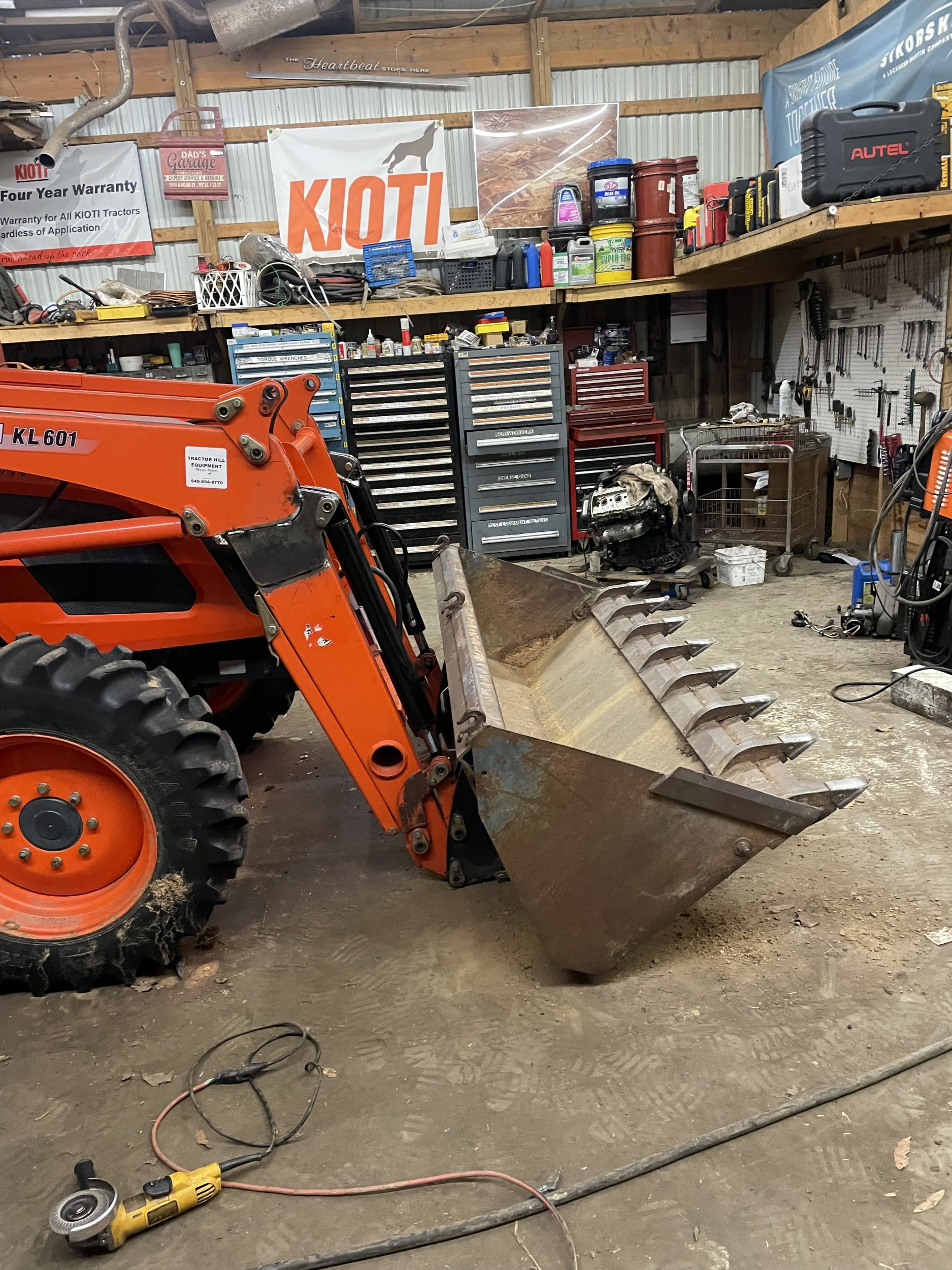

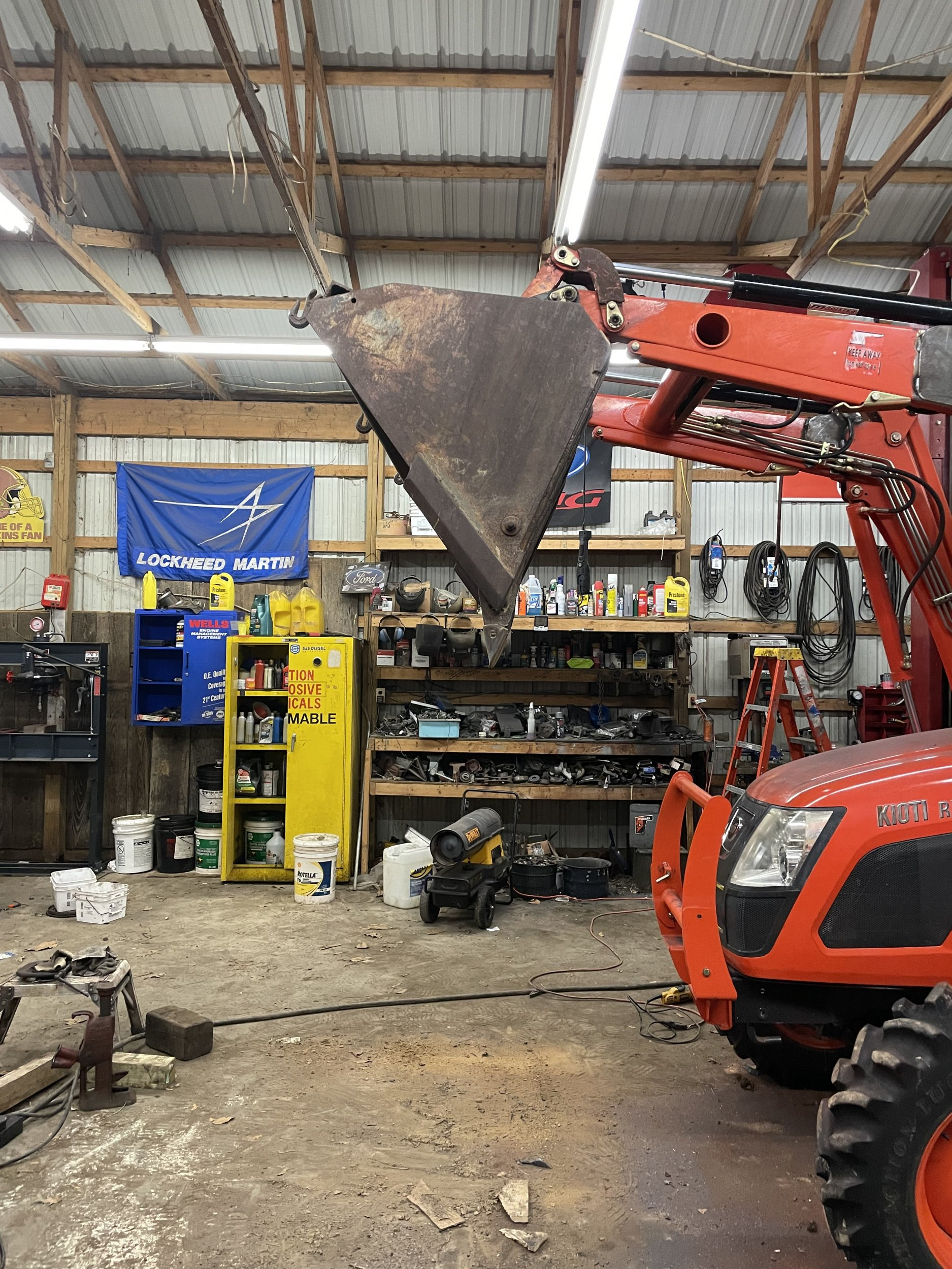

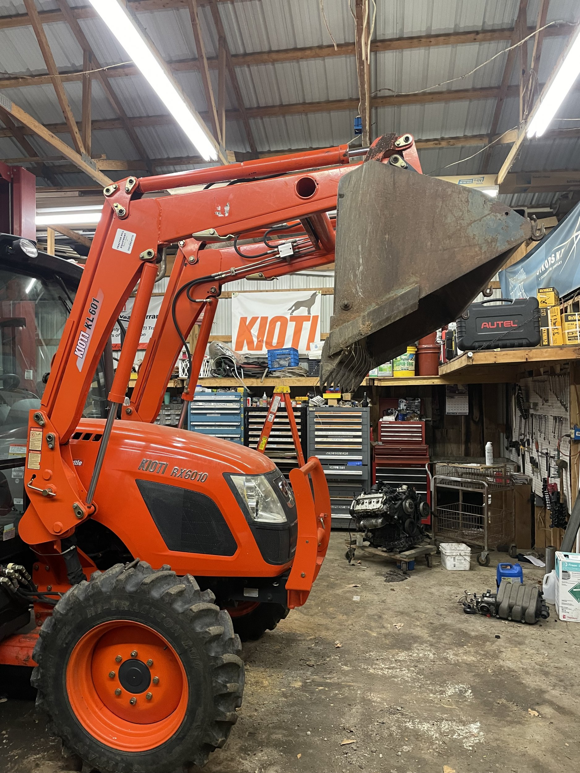

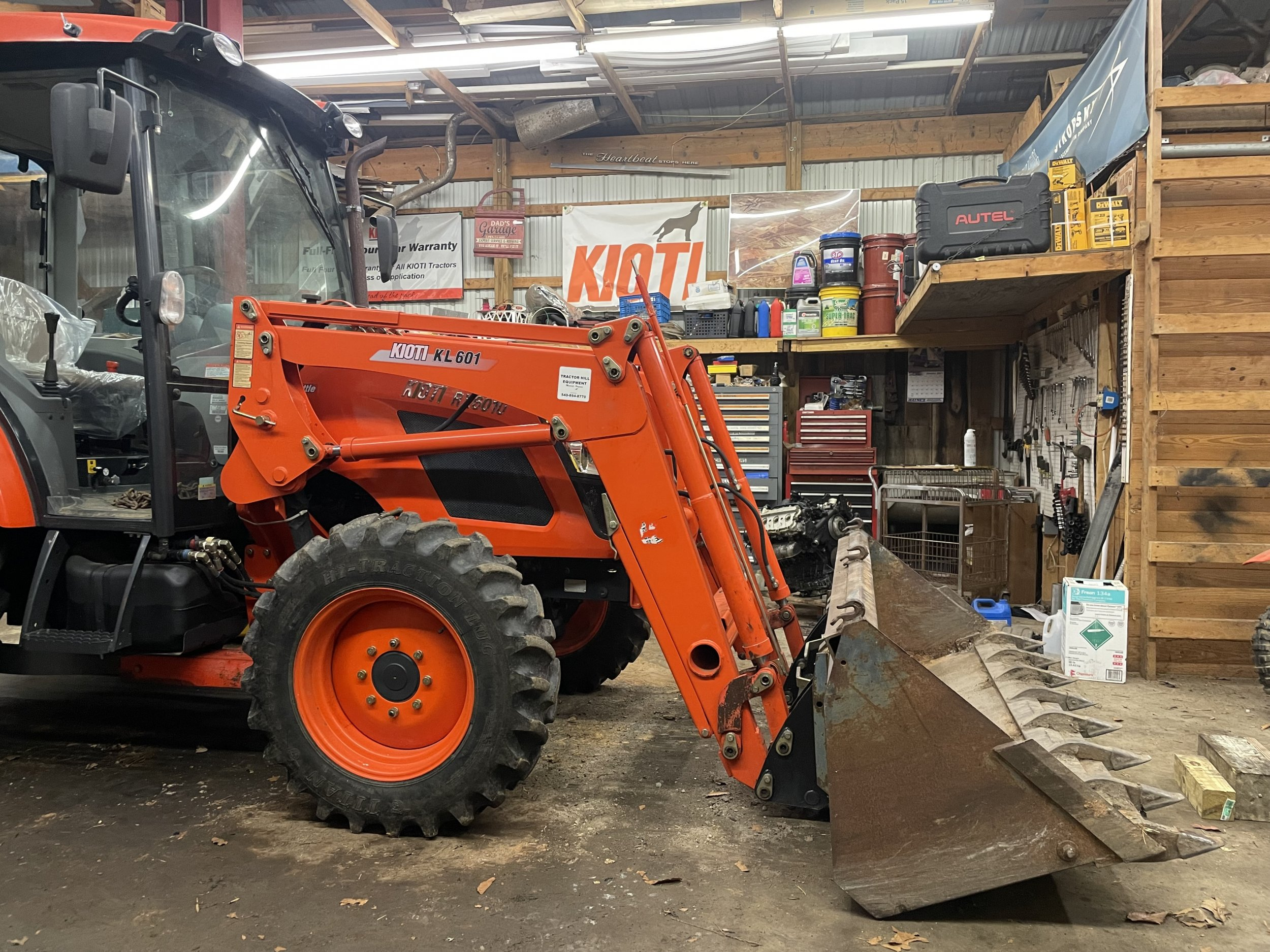

Update: Finished tweaking fabrication of cylinder mounting brackets, tack welded and performed an empty bucket dry run today and the results are what I was hoping to achieve. Pics attached of the before and after mods showing full curl and maximum rollback and the difference is like night and day. I am very pleased with the outcome and plan on welding everything up tomorrow.

Enjoy her
/ Resolving self leveling dislike #109
Why, that's perfect!

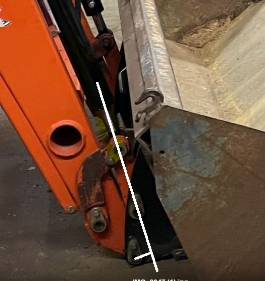

I notice that there is very little lever arm left as shown in the pic. (distance from the line of action to the bucket pivot point) Do you think that might be an issue?
A load at the end of the bale fork, for example, will put a much larger load on the cylinder when fully retracted as shown. My little Kubota B9200 with it's loader is like this and the bucket is fairly unstable in this scenario.
Just asking as now is the time to check this prior to "welding her up".
