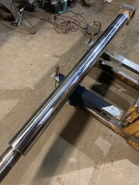

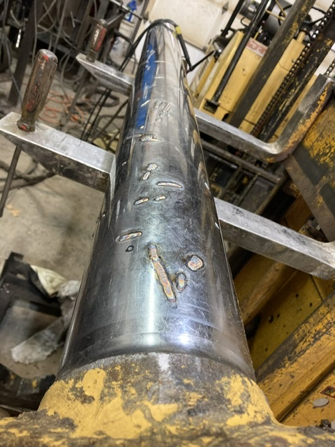

Here’s one of many I’ve done this past couple of weeks.
This bucket cylinder rod today from a 88k lb Cat machine. 130mm rod x approx 7’ long. It’ll be going back together in the am.
Edit: from a 145k lb machine (Cat 365)

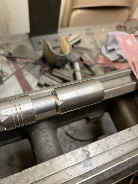

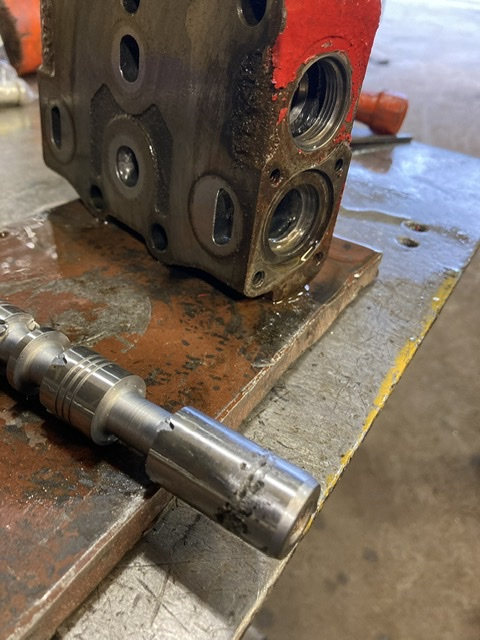

And another weld up on a valve spool. This pic shows the corrosion before.
   / Resealing stabilizer cylinder, nick in rod. Fix, ignore, replace? #27
…….and here’s the finished spool just before final polish, ready to go back together.
