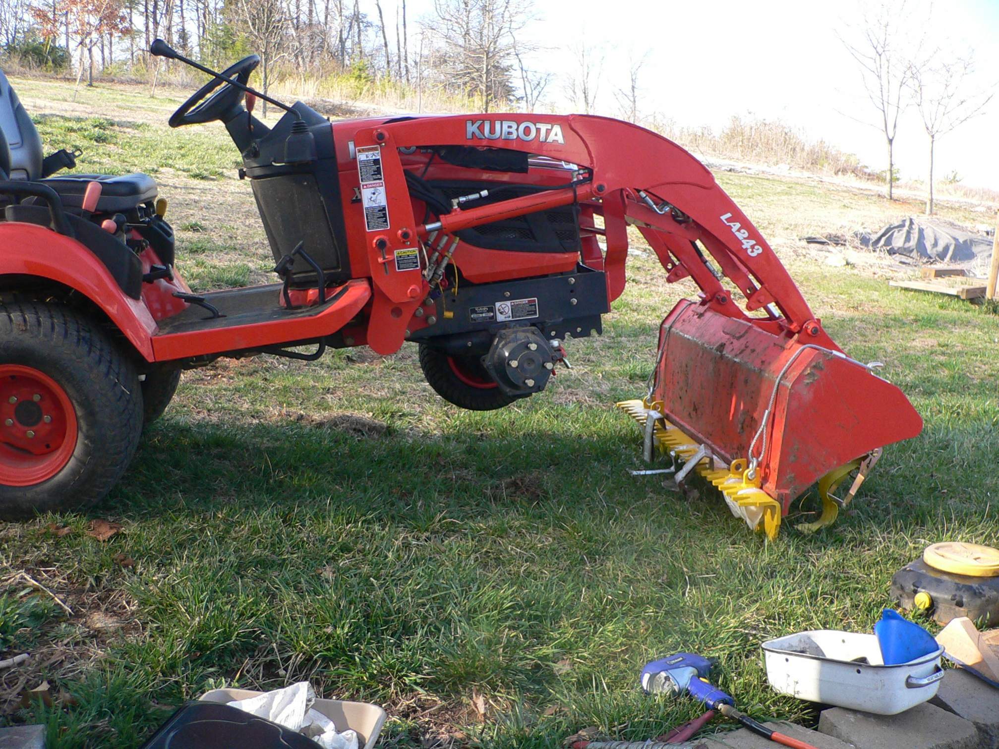

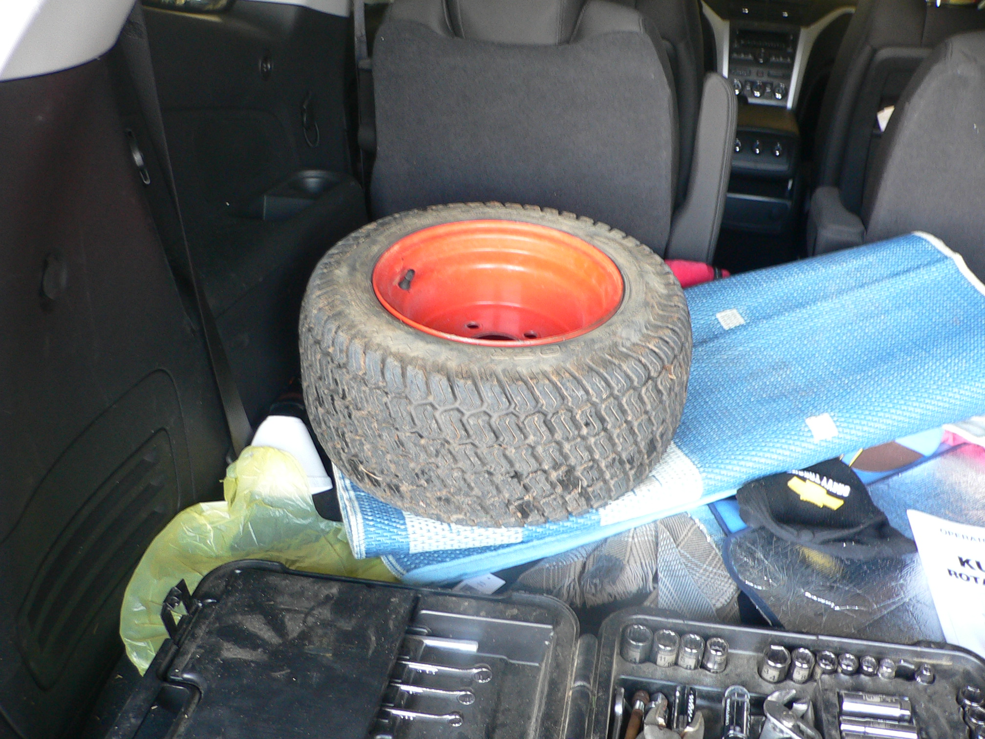

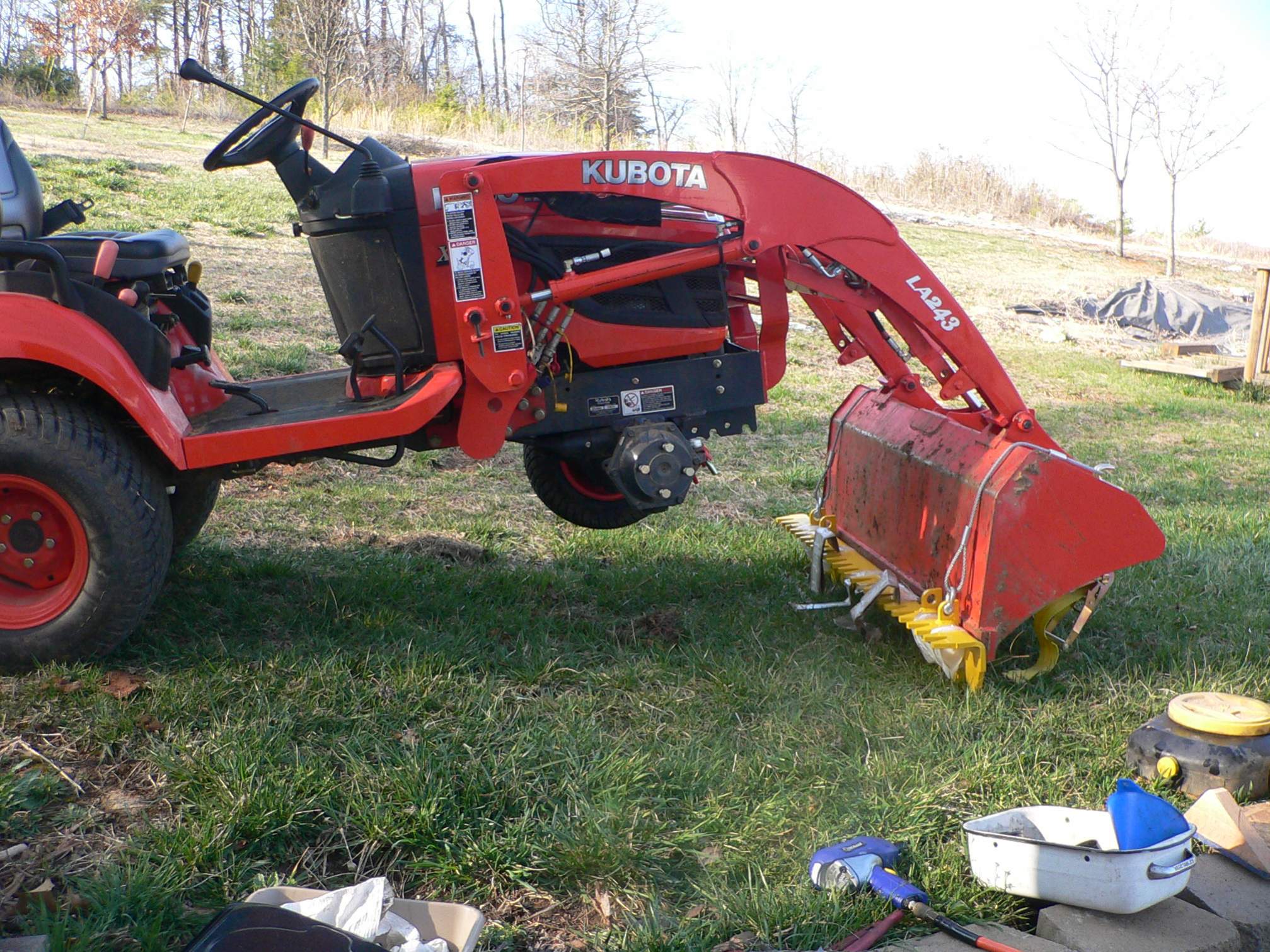

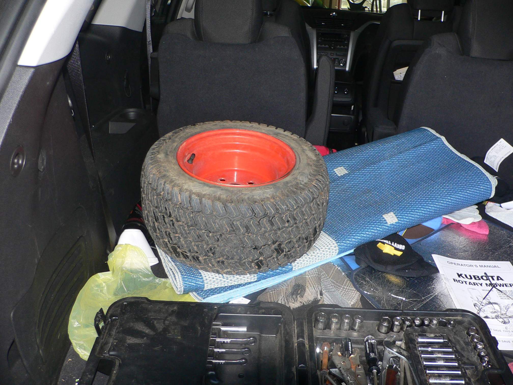

Stange, I have a BX2350 turf tires and the left front has a slow leak. I finally got tired of it and slimed it a couple of weeks ago. As of yet I don't know if that helped or not. I also got my manual from the old stack, that says change the tranny fluid at 50 hours. I don't buy into John Thomas theory, but I guessing that they have a problem area on the rims.
My problem is about to be resolved with my slow leaking right front tire on my BX2660. Talked to Gray (parts man at Barlows) and told him to file me a warranty claim for a new tire or tube it. He said go ahead and tube it and they will pay. Here it is on it's way to being tubed. When I get it fixed I will be quitting the "one front tire has slow leak on BX Club", you guys will just be an old memory. I couldn't budge the bolts to remove it with my socket wrench so I finally got out my new air wrenchs and Wow! I hit the trigger and the bolt was off almost before I could let go. I'm now an air wrench believer.:)
I also did my fifty hour service today of replacing oil, oil filter and transmission filter.
