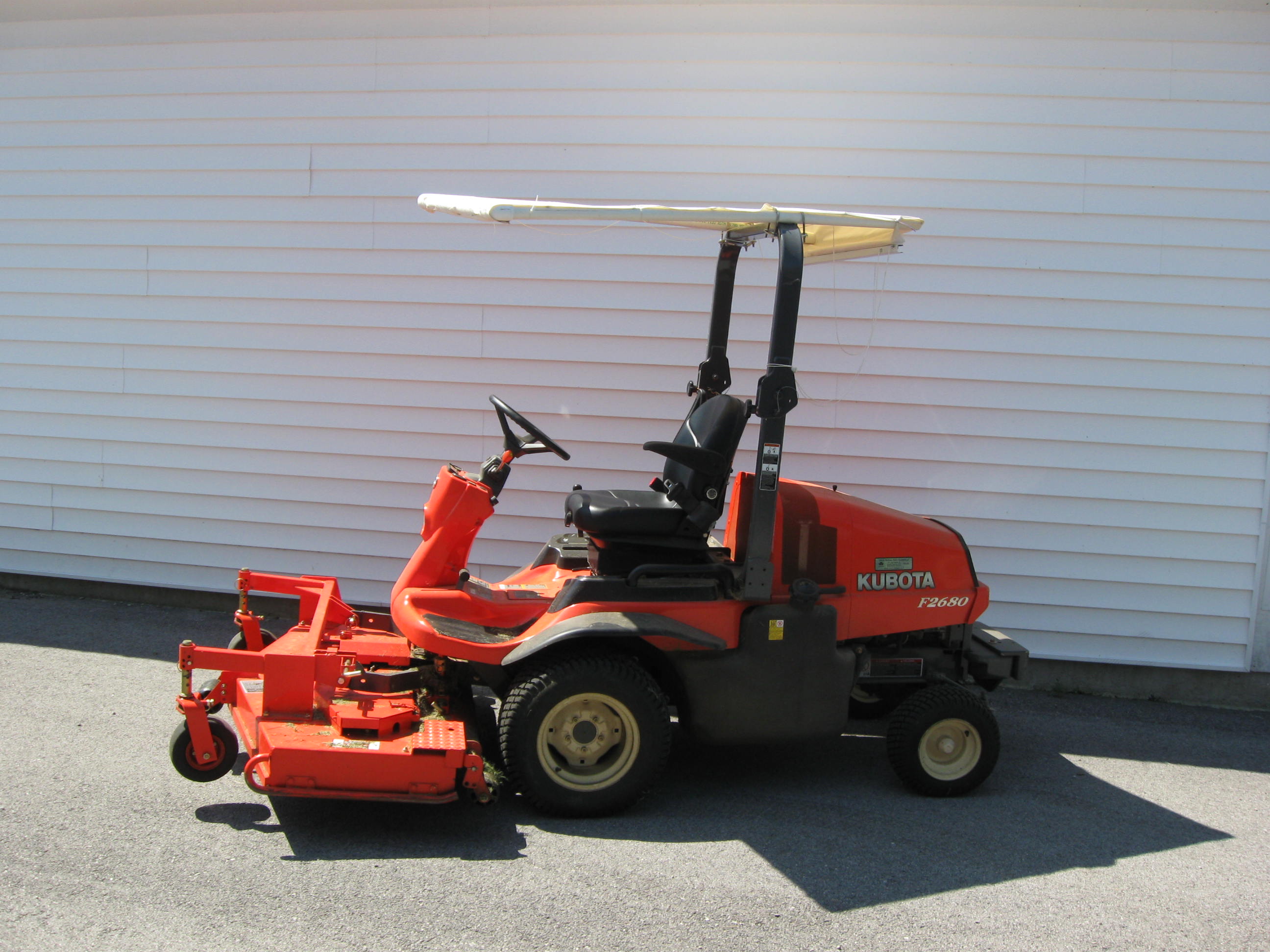

"For the F2680, it is the 200 hour mark."

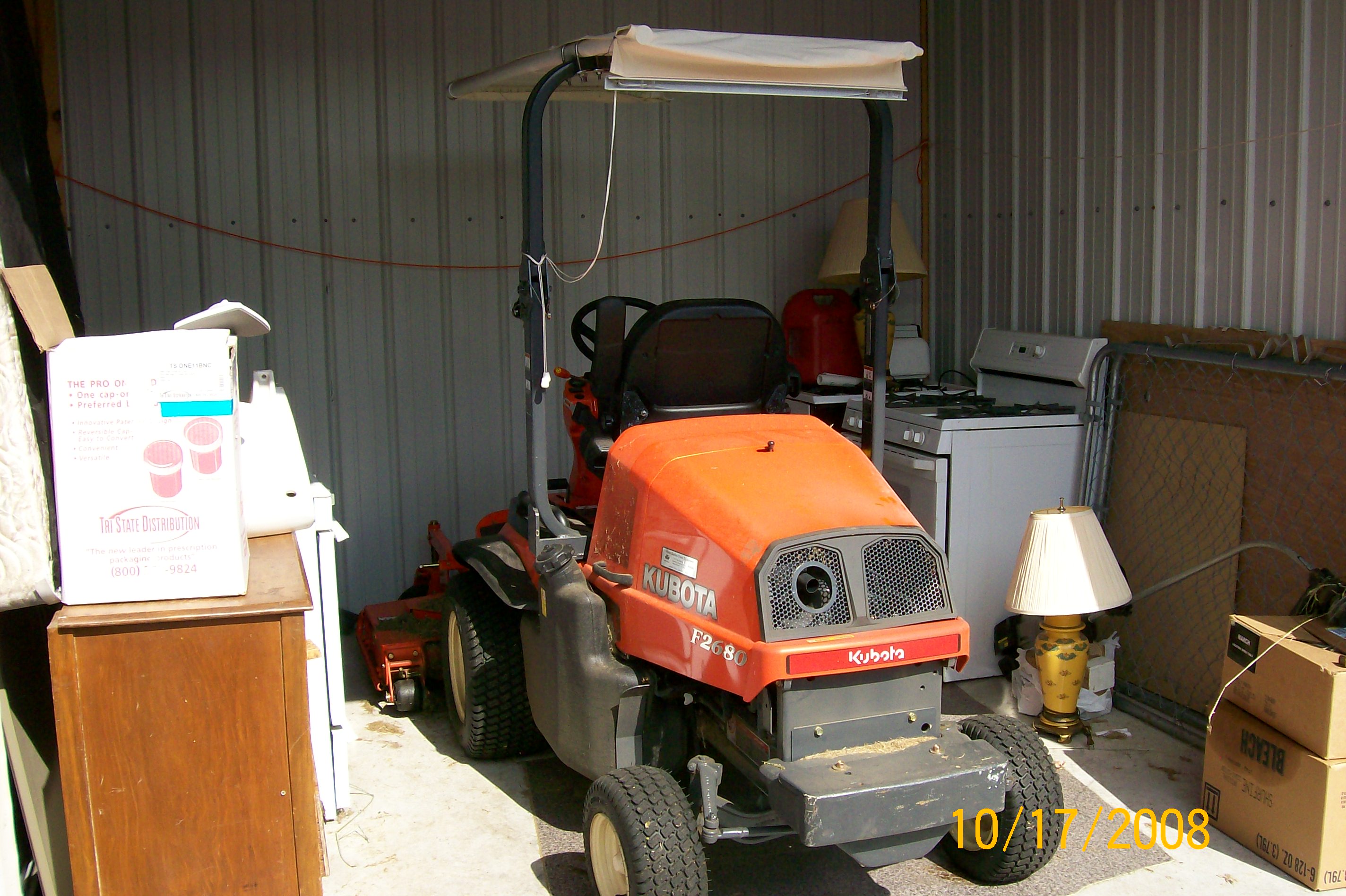

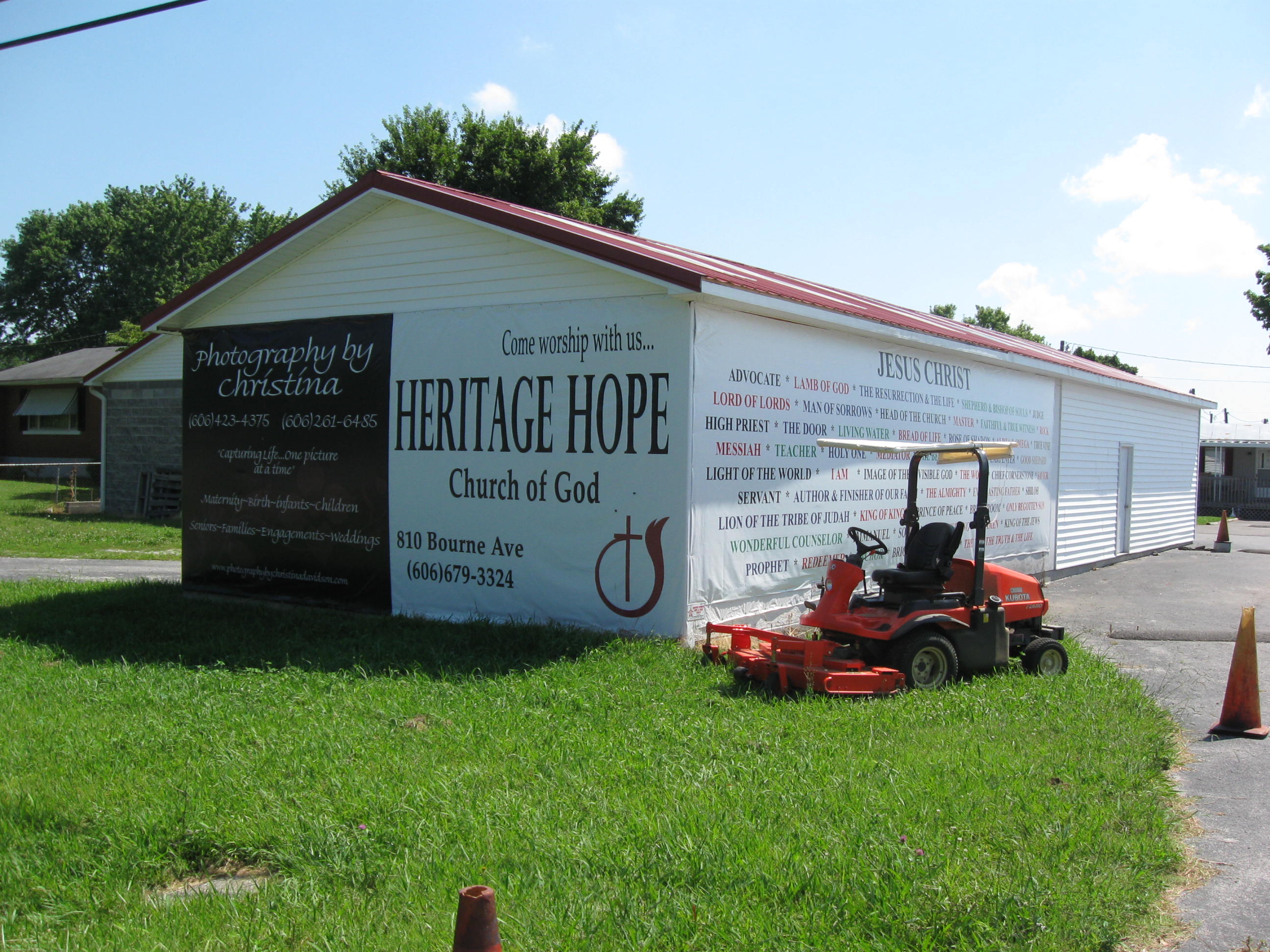

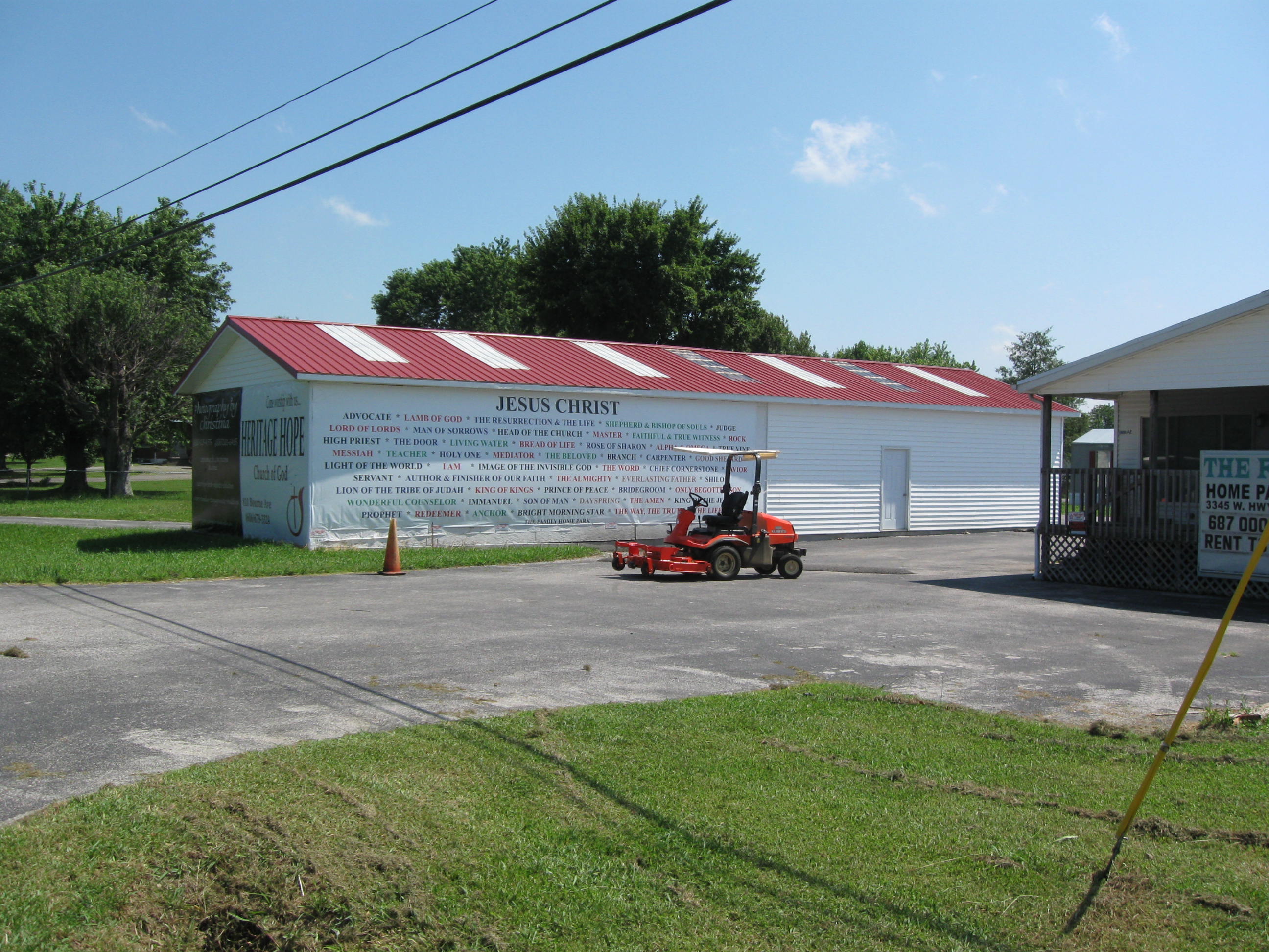

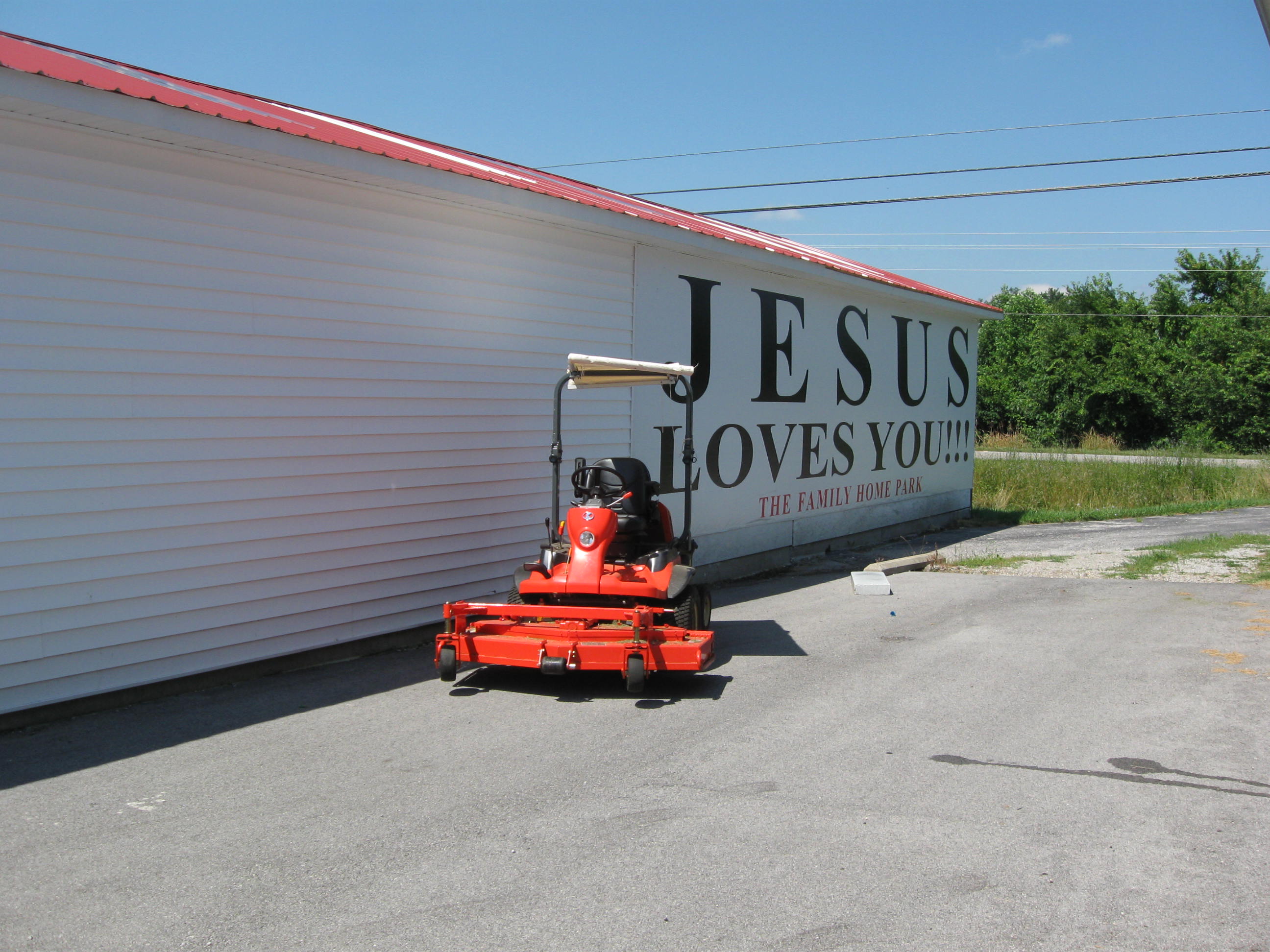

What model is Kubota speaking about? Is it a tractor?
It's not a tractor. It's the better for me than a Zero turn mower and a bit more money than a ZTR.
