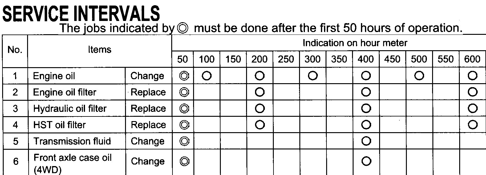

My L3400HST requires tranny fluid and filter at 50 hours. I attached a scan of my L3400 manual. After the first 50 the filters are at 200 and fluid at 400. I got mine in 2005, maybe they changed the manuals.

I don't know if you have an HST or not.
Just when I think I get it all figured out!!! I do have a HST and I wish I could scan my manual but on page 44 (MAINTENANCE) Transmission oil change 400hours. On Page 43 Engine oil, Engine oil filter, Transmission oil filter (HST) @ 50 hours and back to page 43 Hydraulic oil filter @ 50.:confused:
My manual code No.TC223-1971-1 What the Heck???? I guess I will just follow MY manual and see what happens.
