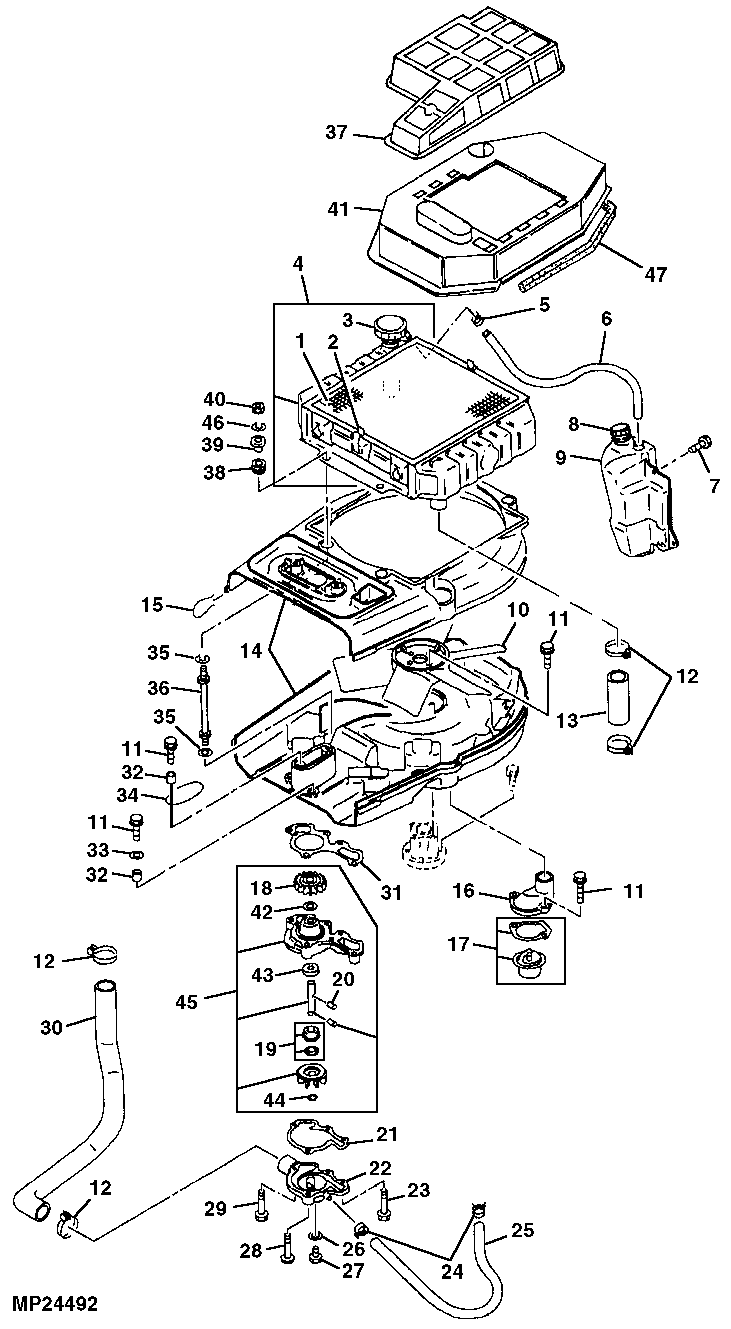

Hello, good folks.
Got a hand-me-down 1991 JD LX178 with the water-cooled Kawasaki FD440V engine.
Upon finding oil with milkshake texture and searching the web, I have come to learn that the water pump is of a somewhat flawed design allowing water to access the crankcase when pump gaskets fail (?). I hope head gasket is not culprit, compression seems decent and engine runs okay (apart from whiteish smoke).
Found water pump with two associated gaskets (part # AM134588) on eBay for $80. Question is, is that all that is needed? I seem to recall having read that there are some seals or O-rings associated with the pump assembly?
Thanks in advance for any pointers.

It's usually the seal on the pump shaft, not gaskets that fail. I assume the ebay pump will be assembled, with gaskets 21 and 31 included. There several different length bolts used to hold it on and one is a size bigger. They thread into aluminum so very LOW torque. Tighten too much and you will strip the crankcase threads. Small are 70 LB - INCH, one large is 186 LB - INCH torque.

Why does shaft seals (I assume #19 and #42 on the drawings?) failing cause coolant to enter the crankcase? Is the overhead drive gear submerged in oil? I assume they are delivered as complete units from the dealership?

You are correct the drive gear is in the crankcase within the oil. IIRCC the cam gear drives the water pump gear. When you have it off you should be able to see the gear (part of) that drives it.
