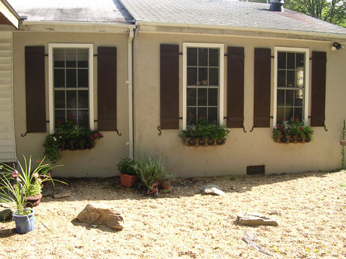

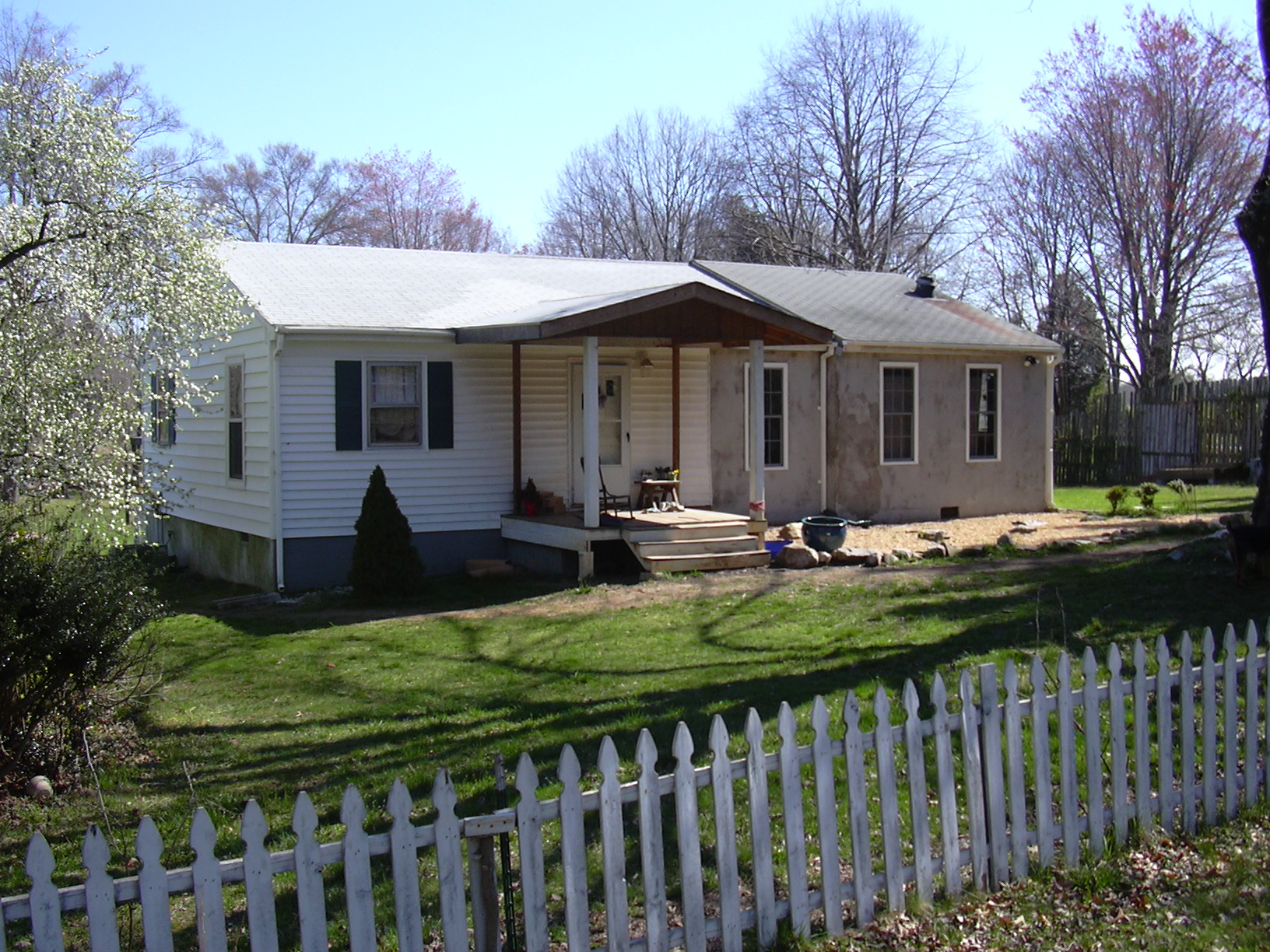

What would be the price range for replacing roof? It is an old rancher with A frame roof and we would like to replace it with higher pitch roof. Since the main reason to do it is to gain space, it would have to be done in rafters, not in trusses.
Now what would be the price per square foot to get it dry:
- take down the old roof
- new rafters with sheething
- shingles nailed on
Hmm, thats about it, I would take it from here.
Appreciate any information, thanks
/ Replacing roof #2
How many square feet?
What is the pitch of present roof?
What will be the pitch of new roof?
What kind of shingles?
Any pictures?
/ Replacing roof
- the house is about 1200 sq feet
- present pitch 6/12
- the new roof should be 16/12 or even 18/12, not sure yet
- probably just regular asphalt shingles
See pictures. The one with shutters is the later one.
Thanks

Will the present foundation AND walls support a second story?
What is the spacing on the studs in your walls?
/ Replacing roof
Thats something I dont know yet, trying to find a structural engineer to tell me.
16 inches.
/ Replacing roof #7
a structural engineer is a good idea....your new roof is going to be way more roof than what you got now.
/ Replacing roof #8
My inlaws run a construction supply house and build houses as well. They won't build a home with a roof over 12/12. It's too hard to work on. Just a heads up that you might have trouble finding someone to do that kind of roof. And if you do, I'd guess it'll be expensive.
/ Replacing roof #9
16/12 or 18/12 pitch
I have had to do 12/12 and 14/12 roof's before, I can't even imagine trying to do one on a 16 or 18 pitch. I agree a structural engineer will need to be contacted about doing something this drastic. That's going to be alot more weight on your current walls and foundation.

I'm thinking that you want to gain some square footage for the minimal amount of money?
Going that steep of a pitch is gonna make it a very, very expensive roof. It's also just short of being straight up and down. Why not just put a second story on and re-use the current roof trusses?
You'll need floor joists either way, so that's the same amount of money. The walls for the steep pitched roof will either have to be sloped inward, part of a truss system, or you'll have to put in seperate walls in addition to the roof lumber.
Price to put on the second story will vary around the country depending on labor. Big home builders have done some studies and say one third of the cost to build a home is materials. The rest is labor. Of course, they build thousands of homes a year, we can't compete with there prices, but it's a good indication of how it's broken down.
I'd guess you could build a second story for as little as $50 a ft to as much as $70 a foot. The steep roof pitch and space underneath would probably be quite a bit more. I've never done anything that steep and wouldn't even try it myself.
Good luck,
Eddie
/ Replacing roof #11
That looks more like 4-12 pitch, mine is 7-12 and a whole lot of roof up there.

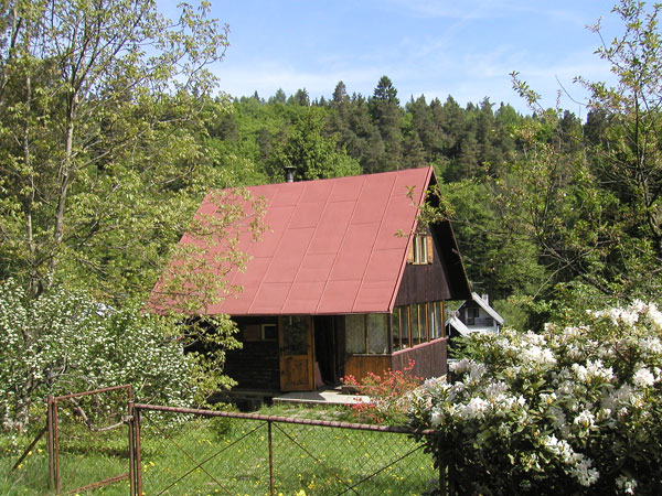

Thank you everybody. This is certainly food for thoughts and I will consider what my next step should be - and talk to structural engineer and architect.
Where I am from high pitch roofs are more common, but thats not a real reason to force it in Virginia :)
Here is a picture of my parents summer cottage near Prague, the roof is rafters, boards and galvanized (painted) sheet metal.
/ Replacing roof #15
Very nice.
We went the metal roof route on the farmhouse. Gives it that old world look and feel. Plus, I don't have to worry about it in my lifetime. :)
