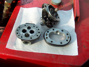

I received my PTO pump the other day, and installed it Only took about 20 min to take the old pump off, two bolts and two hyd connectors. Two bolts to install the pump, and new o-rings on the connecting plugs and hooked everything back up. I still have to lower the engine assembly back down and bolt it down. I haven't made up my mind about using 10W40 motor oil or synthetic motor, or synthetic hyd oil.
/ REPLACING PTO PUMP
#37
Old pump dissembled.
