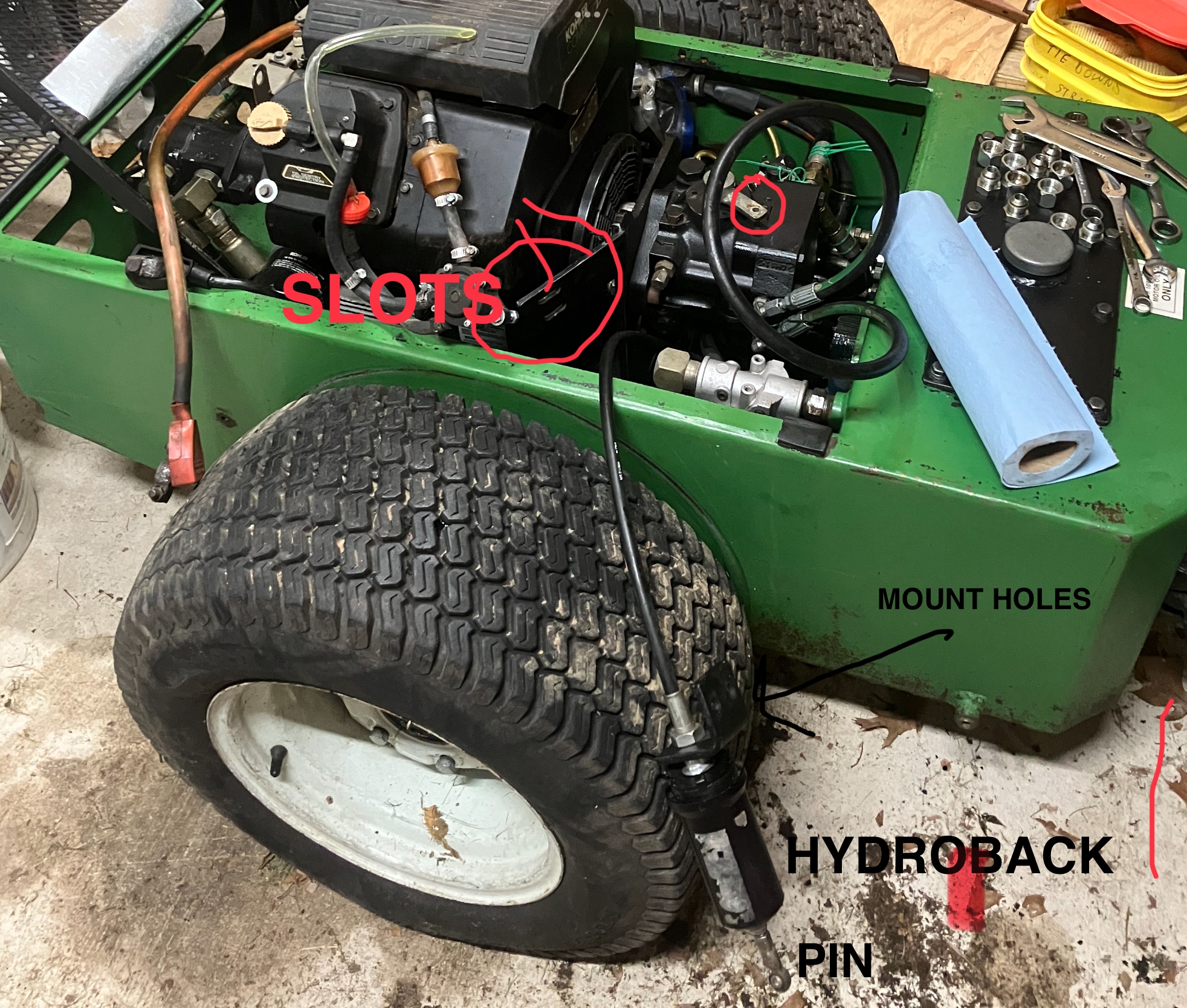

Can you elaborate a little bit for me, about adjusting that ā€œhydro backā€?
Thanks. 😊
Thanks. 😊
I'll try. :ROFLMAO:
The treadle pedals connect to a cable.
The cable goes to the engine compartment.
At the end of that cable is a tubular device called the hydroback.
The cable connects to a puck inside the hydroback.
Springs inside the tube keep the puck centered.
On the other side of the puck is a threaded rod with a heim joint with a swiveling pin.
That pin connects to the lever on top of the tram pump that controls direction.
The tube of the hydroback has a mount on it with two holes.
There's another mount on the pump/engine bracket that has slotted holes.
You mount the hydrback bracket to the slotted bracket and put the swivel pin in the pump lever.
Here's the fun part.
That lever has to be in neutral when your feet are off the pedal. If it is not, the machine can move as soon as the engine fires up.
It can also creep if the brakes aren't set.
Neither one of those is good.
So, you jack the machine up on blocks with all four tires off of the ground and then start it up.
If the wheels turn forward or backwards, you loosen the hydroback mounting bolts and slide them in the slots back or forward until you achieve neutral (no wheels turning). Then tighten the mounting bolts up.
And that's about it. See photo attached. Does that make sense?

Yes sir, helped greatly! Great detail. Even my feeble mind can understand it now.šŸ˜† Very much appreciate the effort.
