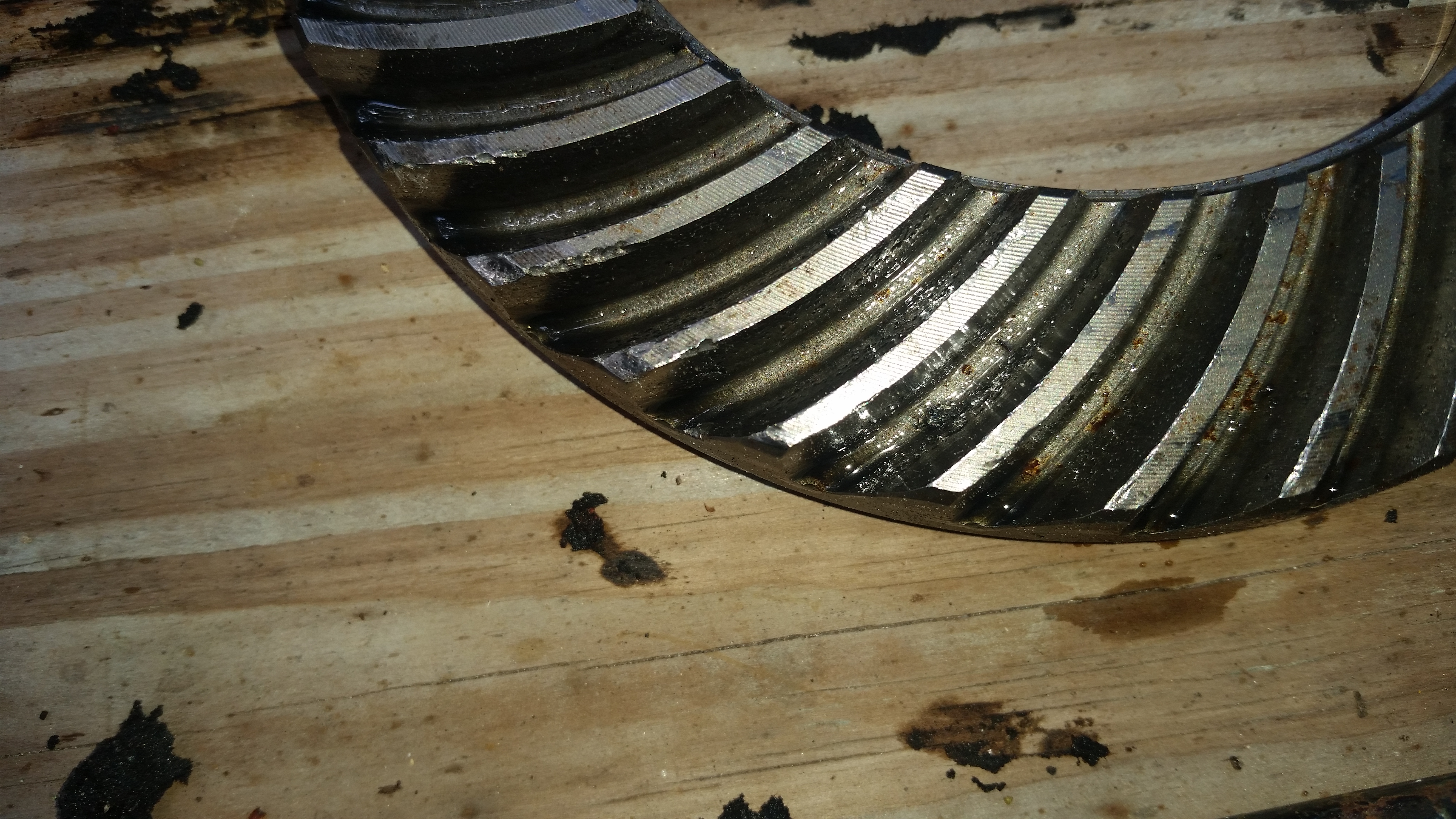

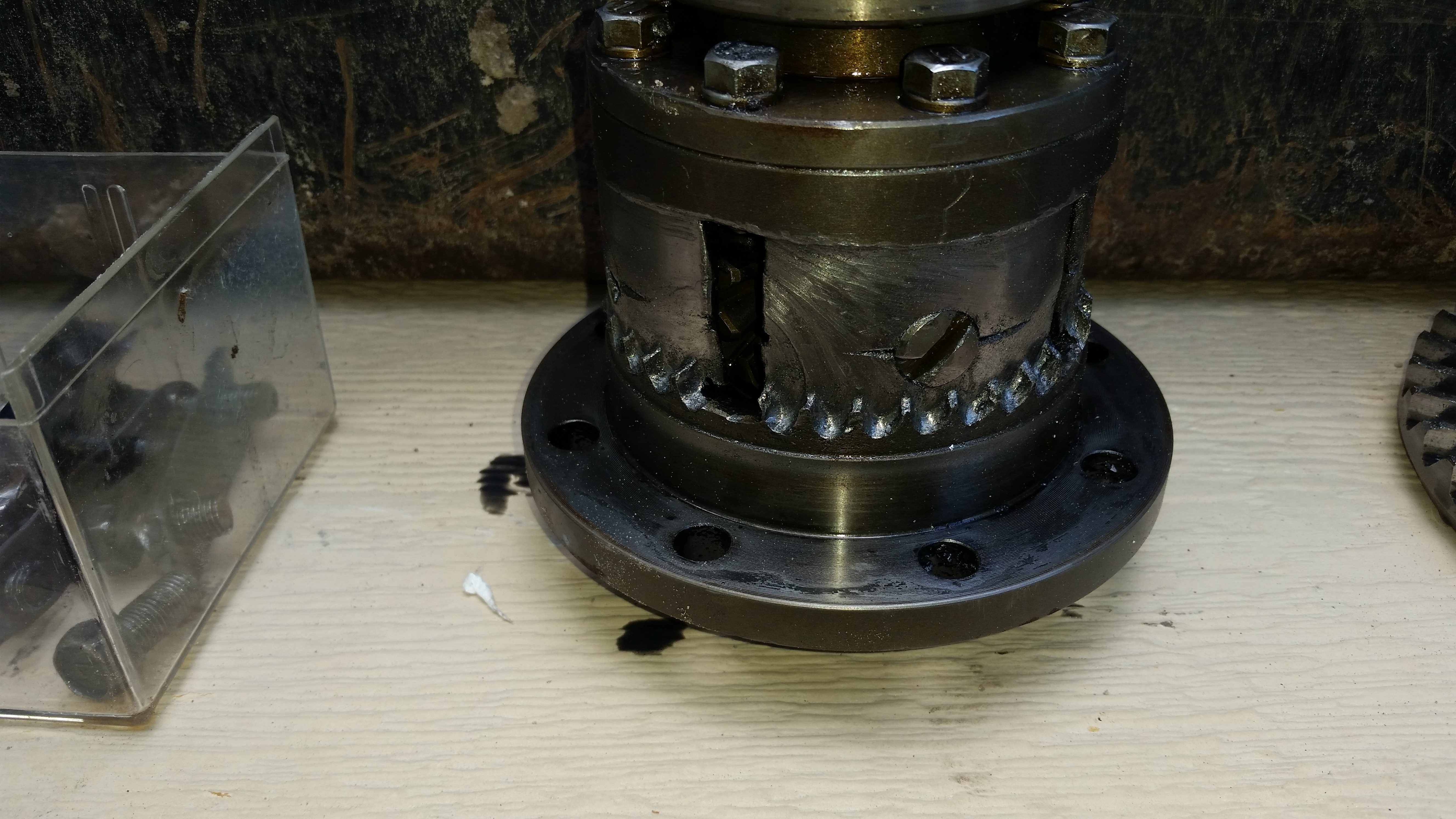

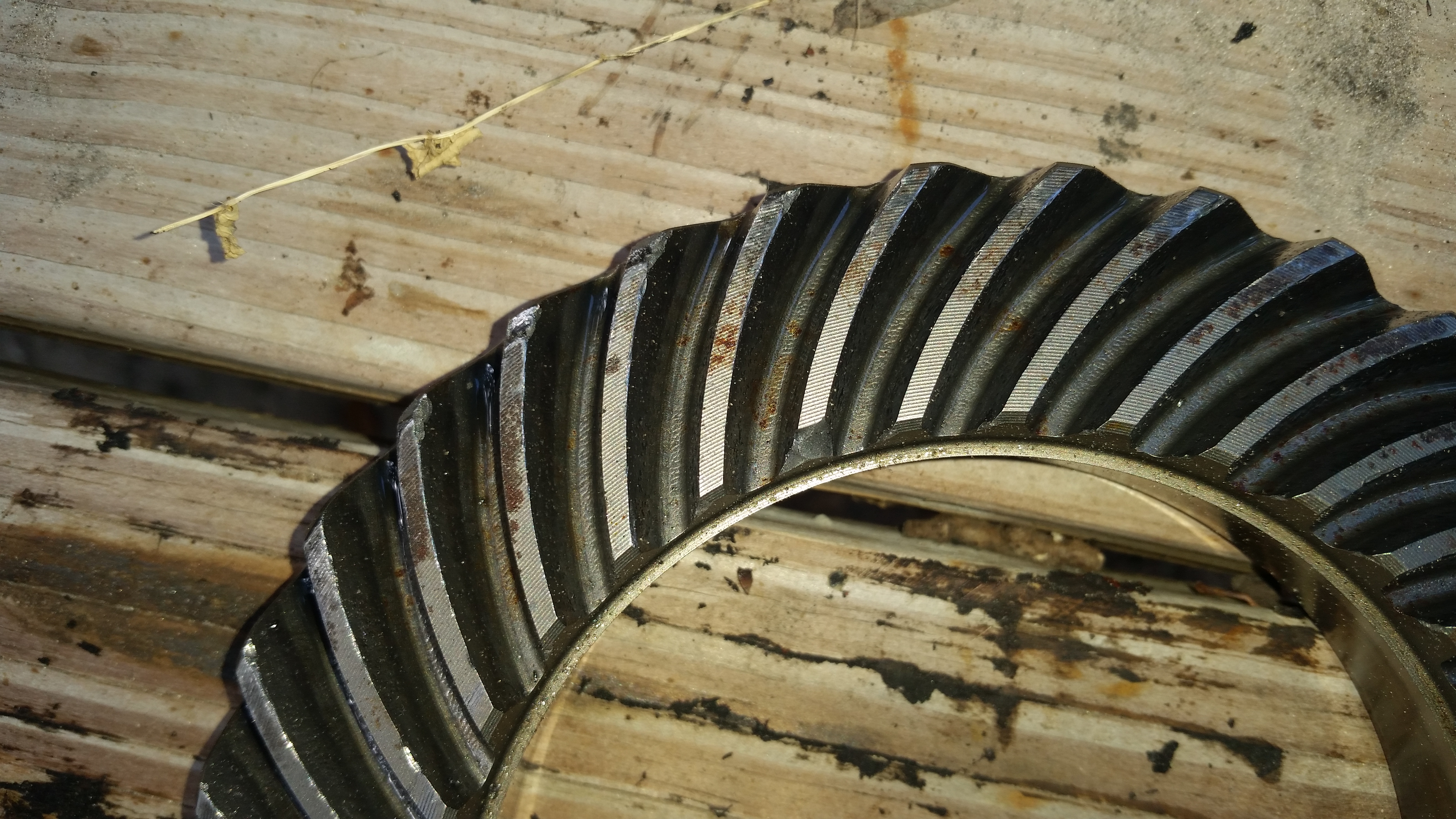

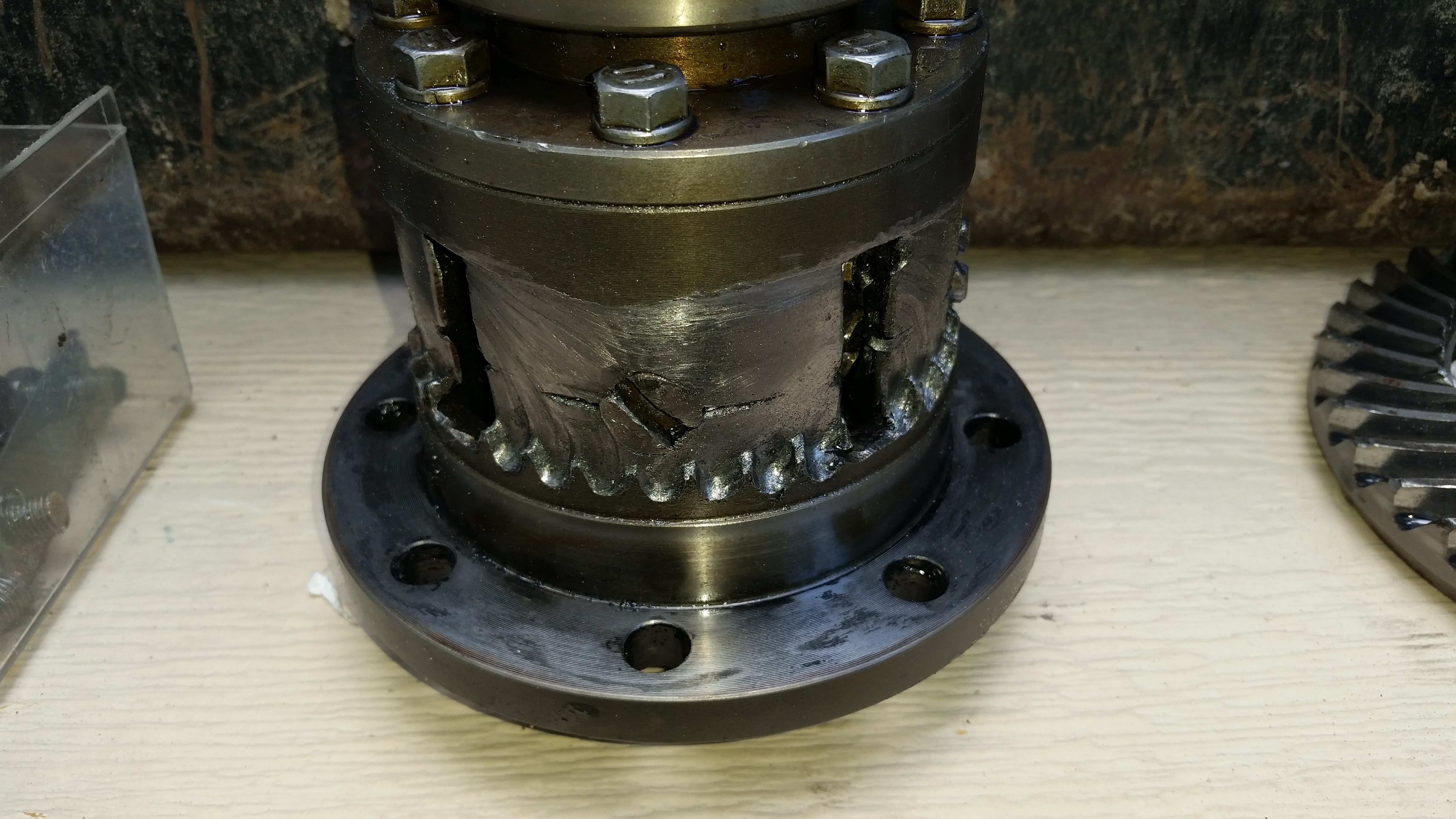

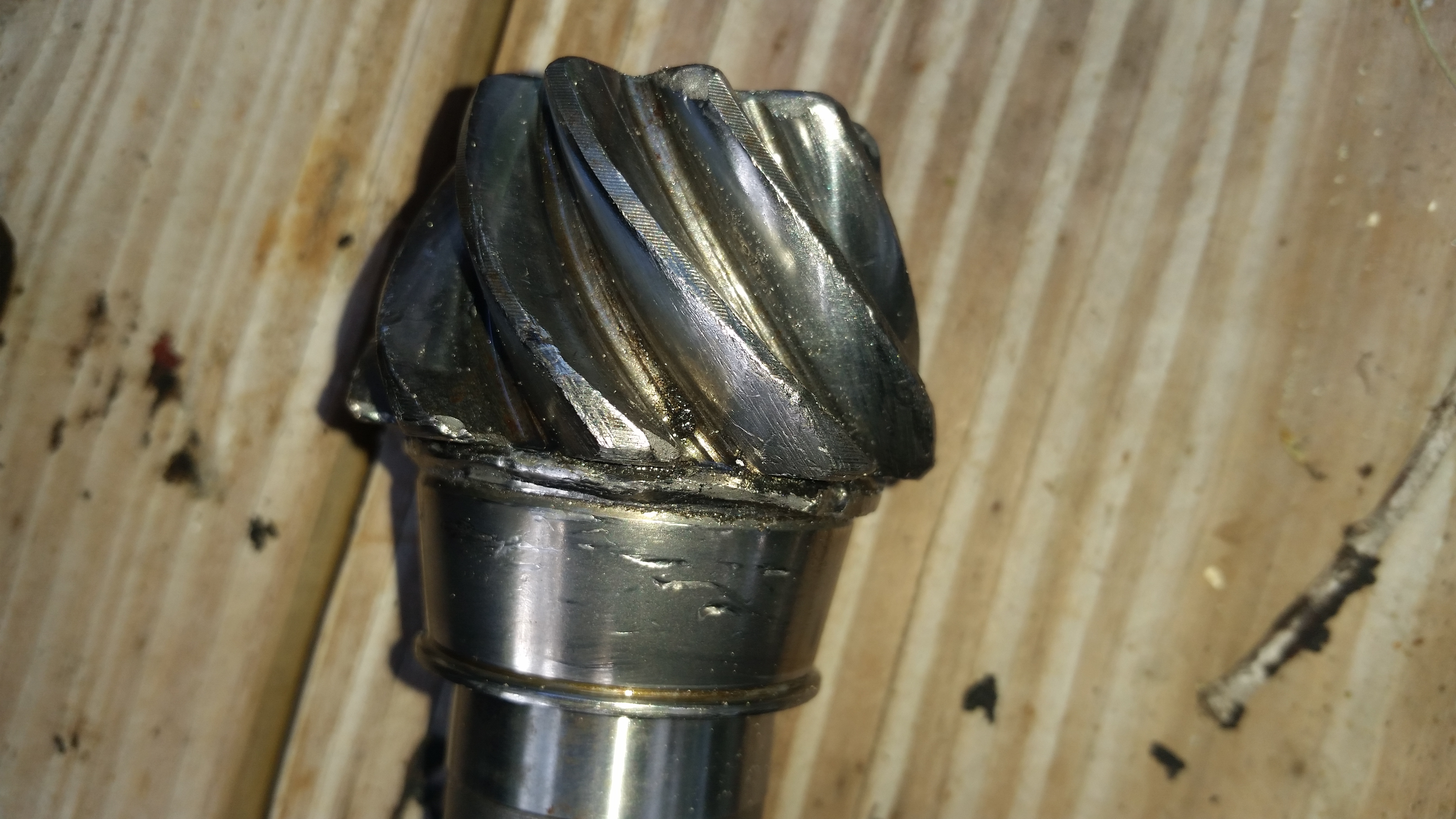

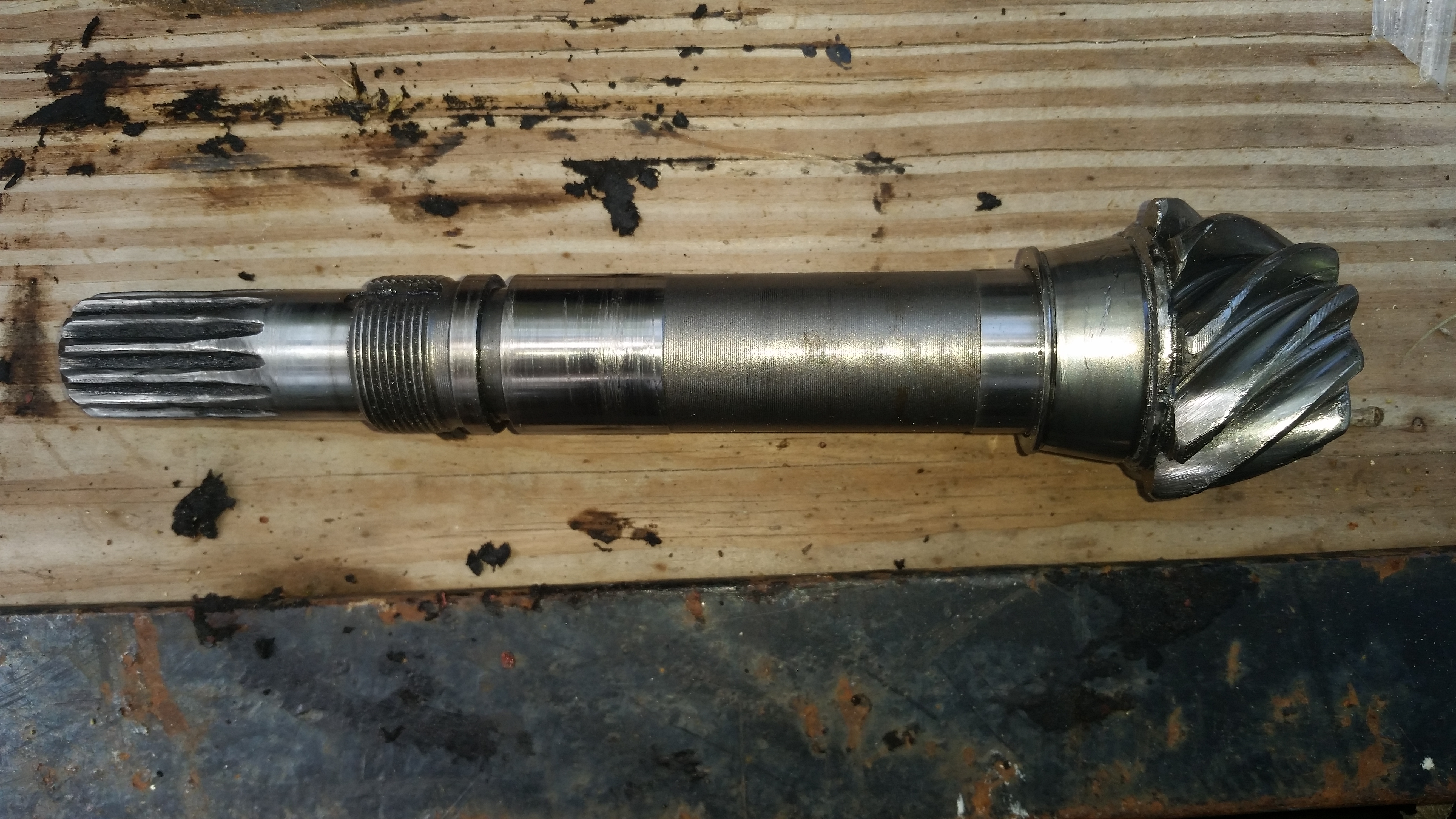

Well, got the front axle out and disassembled. We found some interesting things. First off, pieces of metal fell out. So we already know it's not good.
However, after getting everything apart, the ring/pinion don't look really worn. What do you guys think? Can the ring/pinion be put back into service?
Now, I dunno what to think about the differential housing. I haven't taken it apart to make sure it's free of debris internally yet. It's got some scrappings along the side of the casing, but they aren't too deep and the housing doesn't look to be structurally damaged. Suggestions?
As far as the ring/pinion, I was able to find a previous part number for it and could get about $100 shaved off the cost (though, not sure what shipping would be at this time; still have to check that out)
For the two pics that have a small red ring in the back, that's the pivot bracket that mounts to the back of the axle. The large red one is the inside of the axle housing (obviously with the pinion poking through)
Thanks,
Kori
BTW: scrapping the idea of replacing with a locking diff. And scrapping the idea of looking for a truck ring/pinion as well. Just sticking with the tractor parts.

/ Replacing Pinion/Ring TC40D #5
It looks like the pinion bearings failed and let it pull into the carrier causing the teeth like marks on it.
If you did not see it, that is an inner race still on the pinion that can be removed.
The ring and pinion might be savable if you clean them up. ??? I would not run them on a road vehicle but a tractor is slow speed.
The carrier needs to be cleaned and inspected also.
If inspection goes well you might get by with bearings and seals. (fingers crossed???)
Yeah, I did notice the inner race still on the pinion.
I 'think' what happened is that the locknut may have worked loose causing slack and ware that led to more looseness, which caused more wear, etc, etc.
The lock nut was almost gone. As well as other parts in the carrier housing. And yeah, I agree, these would not go back on in a roar worthy vehicle.
I am going to pull the actual differential gearing/housing apart to make sure there are no abrasive metal floating around in there. This thing is gonna be almost white room clean when I'm done. My uncle also suggested to take the final reduction gears out and make sure of no debris there, too. I did pull the shafts out and there was fine metal particles 1/2 way up the shafts. So yeah, there may be more further down.

/ Replacing Pinion/Ring TC40D #16
Looks like the ring and pinion plus all the bearings and seals need replacing.
The new R/P will have to be "shimmed" in, or it will fail again...
These light duty tractors are NOT bull dozers! That's the results of using them for one!
SR
I got to agree. The only thing in those pictures I would reuse is the housing. The tooth profile is so damaged that it will create a lot of contamination as they try to
wear in to each other. If this something you plan on keeping, spend the money to do it right, or you will be doing it again. If you have no experience setting up a ring and pinion, get some who does to help you. If you are going to reuse those, it probably won't make much difference, as you will never get a good contact pattern with those teeth.
