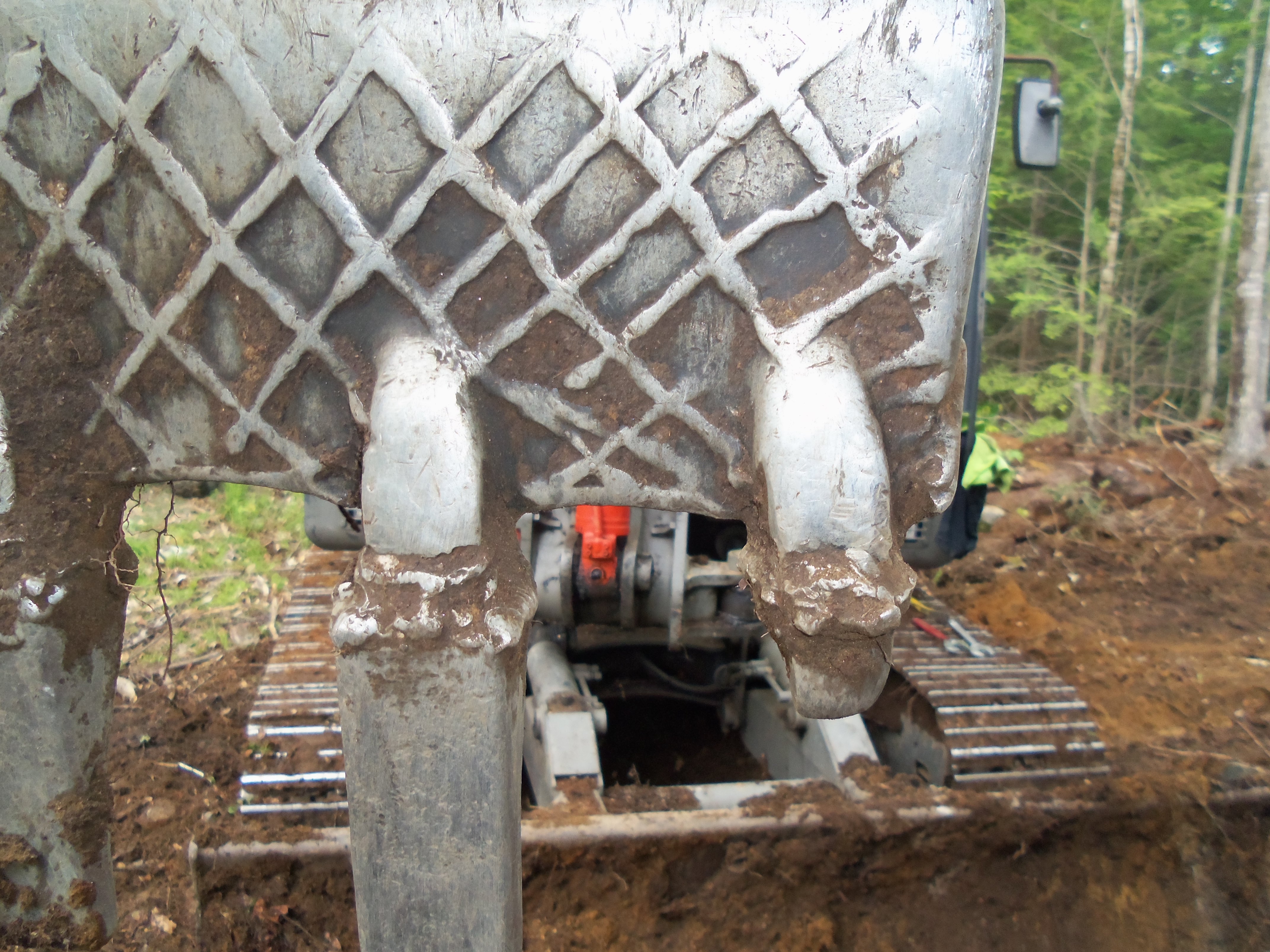

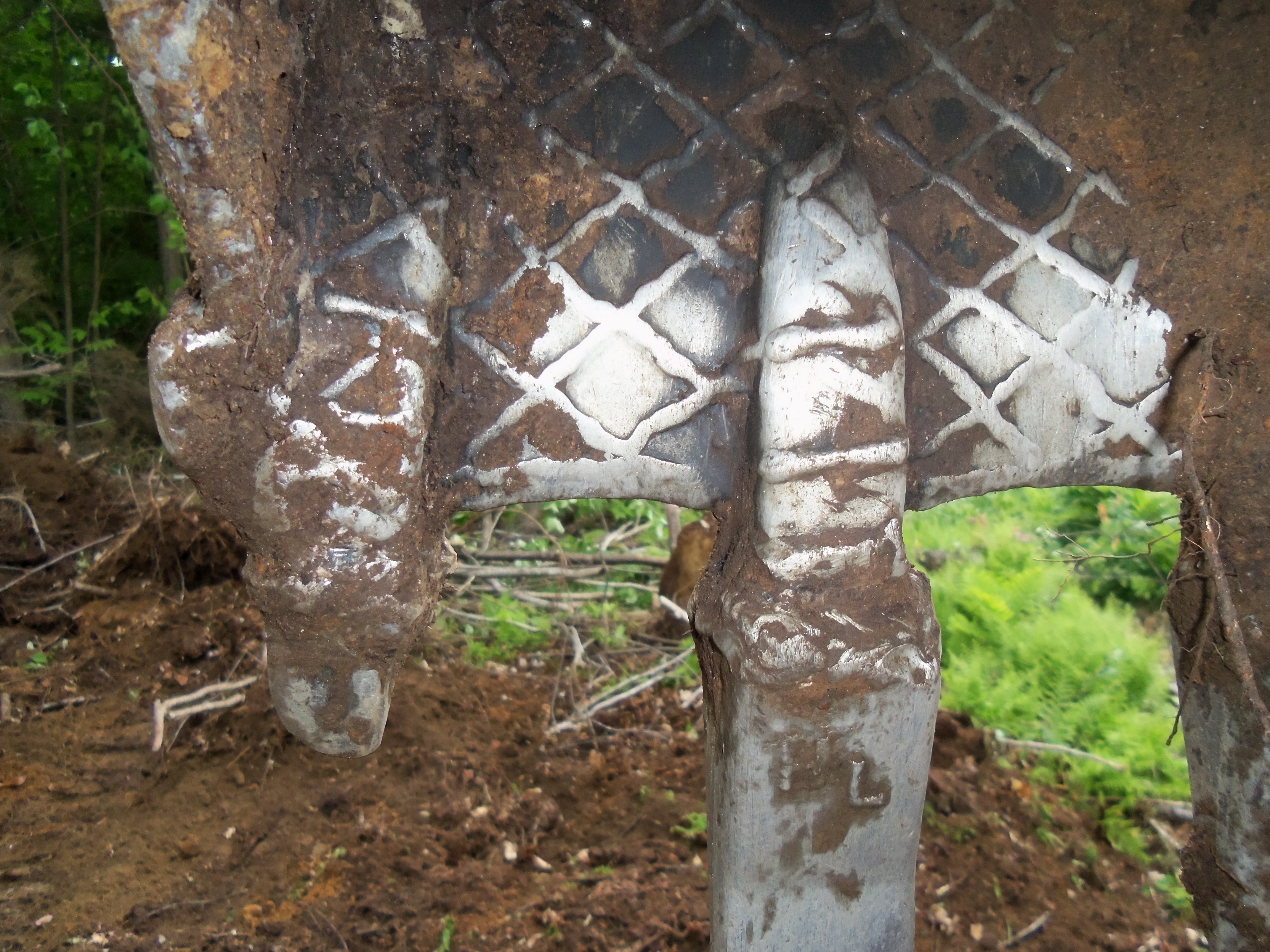

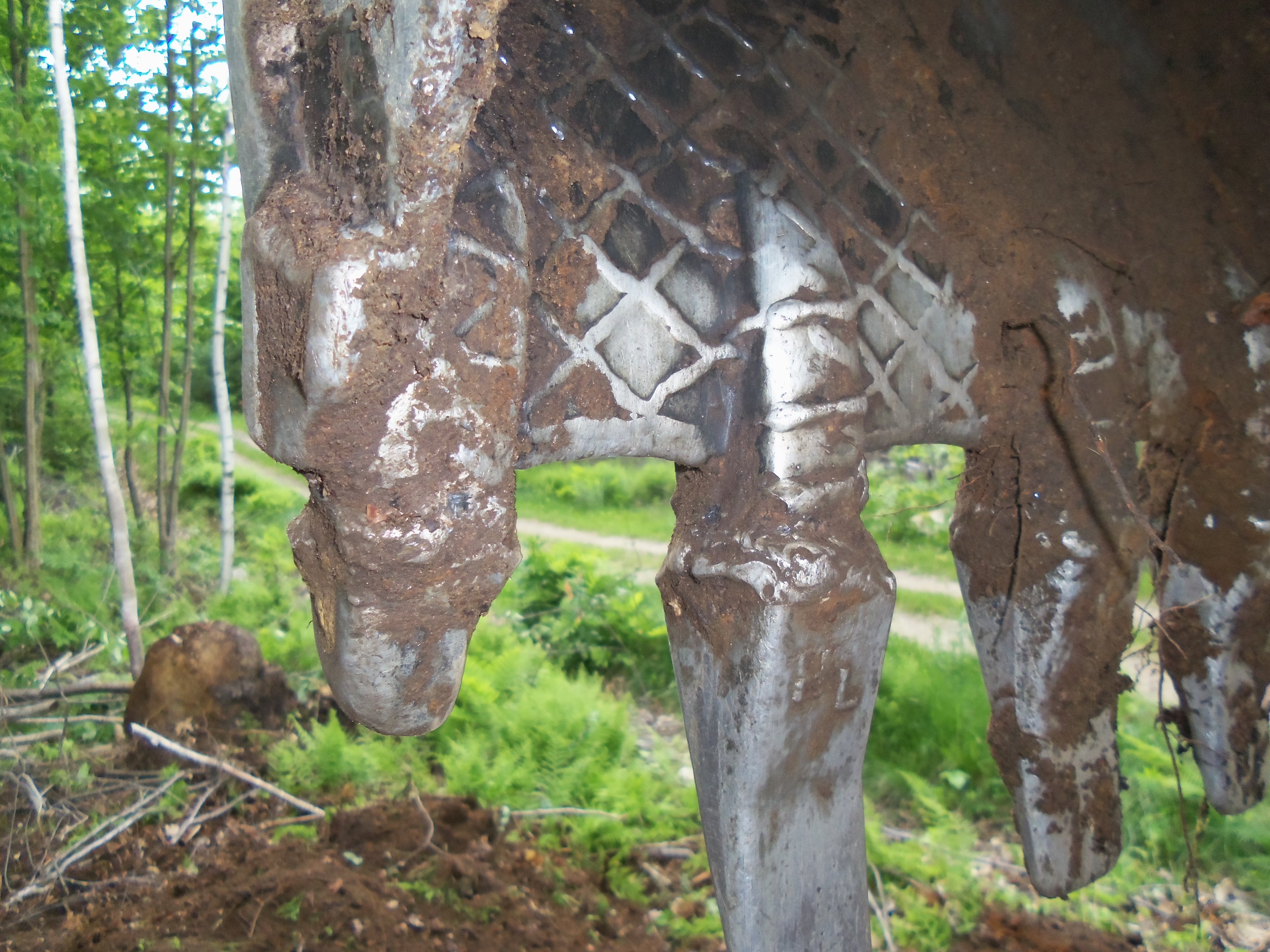

I am going to replace the shanks on my excavator bucket. The previous owner operated without teeth at times and wore them down quite a bit. I am going to replace them with H@L shanks and H@L teeth. The shank with the missing tooth has a hard time keeping on the tooth. The weld will break after a while since basically the shank is not holding the tooth at all. This is the only one that comes off. All the pressure is on the weld. I am tired of losing teeth on the shank. I plan on cutting off the shanks with my torch and then preheating and welding on the new ones using 1/8" 7018 ac rods. Any tips on this project?

It might be a "wash" as far as the amount of labor needed to just cut off the whole edge and replace it along with new shanks & covers vs. your plan. You'd have close to a new bucket. For my situation, I might just run it as it is until winter, and do this project then, with a little more time to build up other wear surfaces that need it. :thumbsup:

I forgot to mention the cost of the parts are $175. Just not sure if it is worth it on the old bucket. 5 teeth and shanks.
What do you think of trying one more tooth on that shank and wrapping three layers of weld all around the tooth? Weld it until I cannot see the tooth anymore. LOL

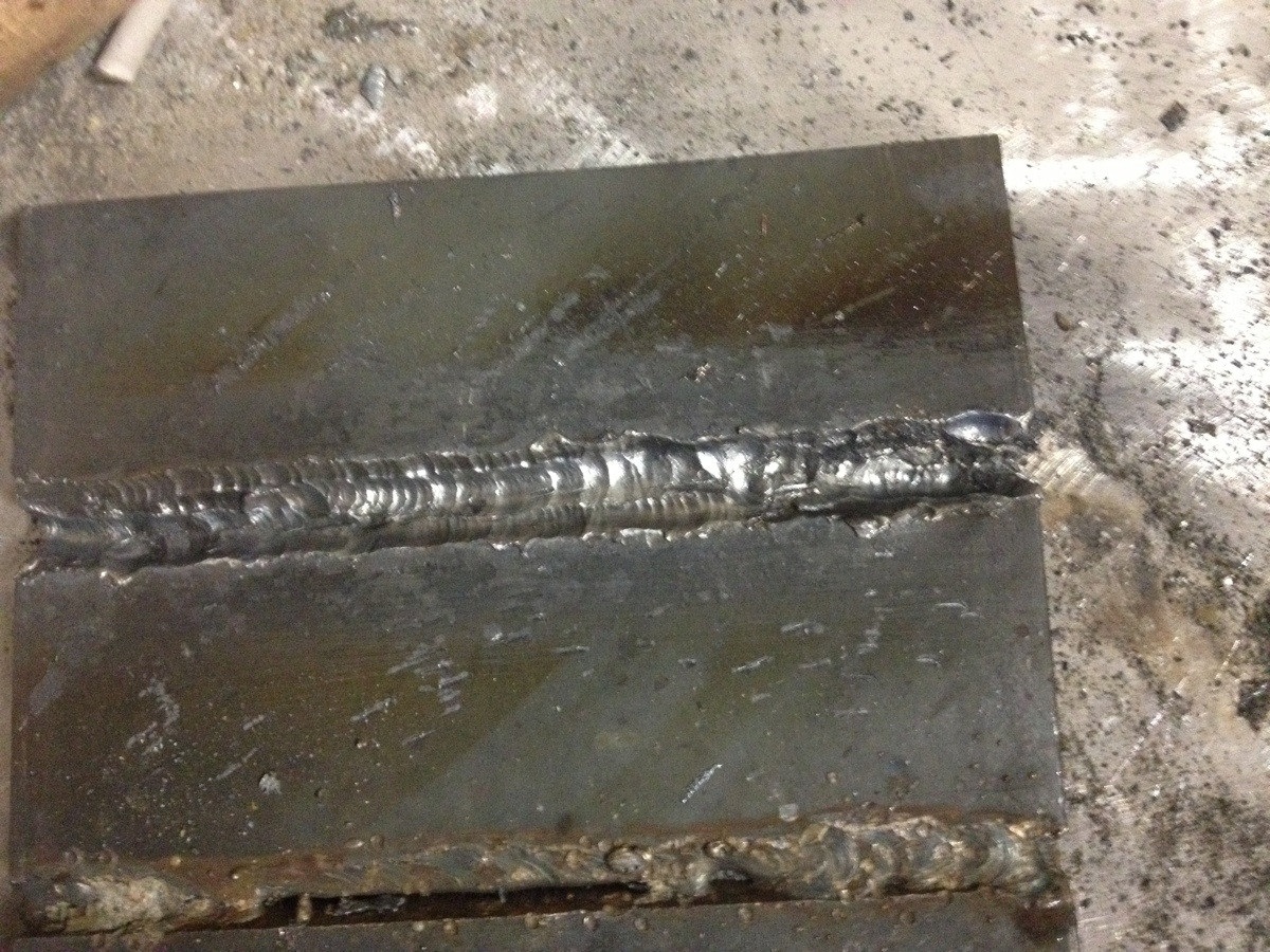

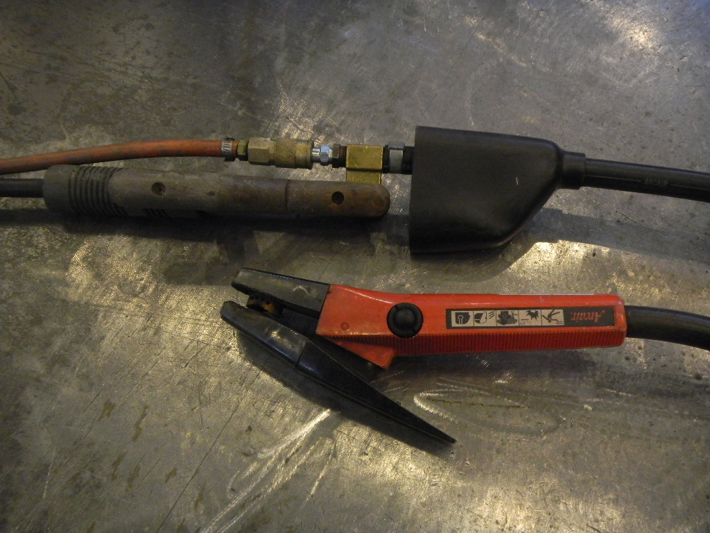

Do you have a carbon arc? A carbon arc would make quick work of this project.

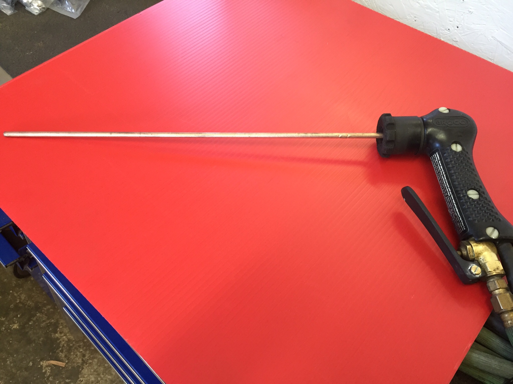

Here's a pic of my exothermic lance. It would also work.

Personally, I won't carbon arc with any of my welders. I would rent one first! Over the years I have put the hurt on welders carbon arcing with them. I've had the leads jump 2-feet off the ground when I would strike an arc.
/ Replacing excavator bucket shanks #8
Because a a good portion of his business involves rebuilding buckets, my friend Matt has a BIG old transformer welder as a dedicated power source for carbon arc cutting in his shop.
When the engine drive unit on his shop truck was in for repairs I lent him one of mine. He informed his customers he would be UNABLE to do any on-site air arc temporarily and they would have to bring the repair job to his shop if they wished.

I decided to give it another try with another tooth. I welded up the shank some with 7018 rod to ensure a tighter fit on the tooth. I then did 3 passes all around with 7018. We will see what happens.
So far the tooth is holding.
I have another question. Can I weld some more hard facing over existing hard facing to build it up some more? any special prep other than preheating?

Profax blow arcs are pretty cheap. 1/8 or 5/32 carbons aren't that hard on your welder.
No need for preheat on hard facing.
If the old hard facing has worn away, weld new right on top of the old. Most hard facing has a two pass or three pass limit. It really depends on the base metal. Mild steel? One pass. Factory bucket or T1 cutting edge? Two maybe three. Hard facing mfg will spell that out. Some need build up rod or softer hard facing underneath.
