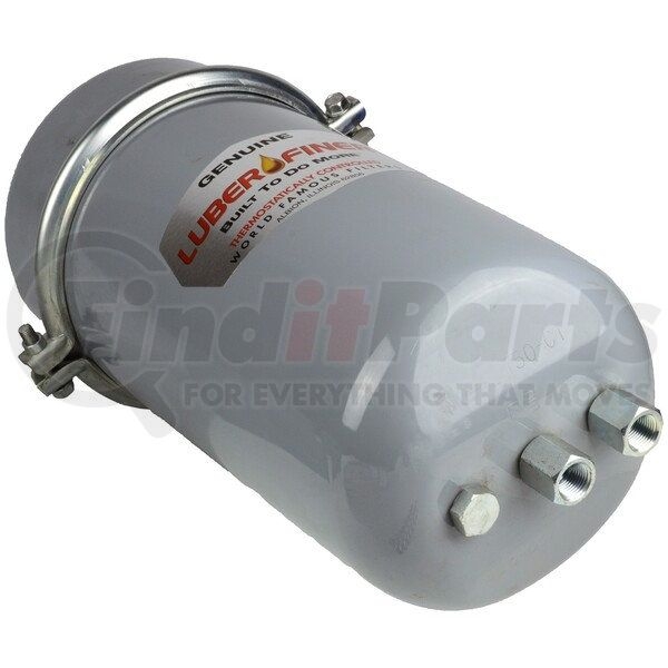

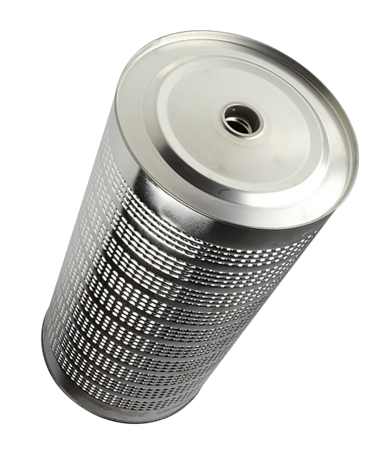

Luberfiners used a large metal cased filter cartridge. They were a bypass filter, not full flow. I was in the trucking industry for 50 years, and never saw or heard of anyone using paper towel rolls in them. besides, the cartridge sealed at the bottom, and a tube in the center carried the oil into the center of the filter and out through it. It had a T-handled retainer that screwed into the top of the tube and sealed the top of the filter. A roll of paper towels would just lay loose inside the filter housing, and not filter the oil at all.
