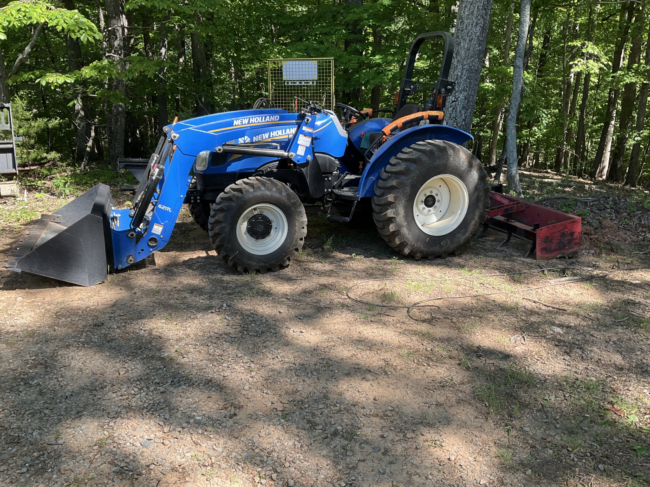

I am in the same boat as you. I change mine by hours or every two years (which ever comes first - hours of time). I use Mobile 1 synthetic 5w40 oil in 2015 Workmaster 50 tractor. Never seen a 'use by' date on any oil I have used.
