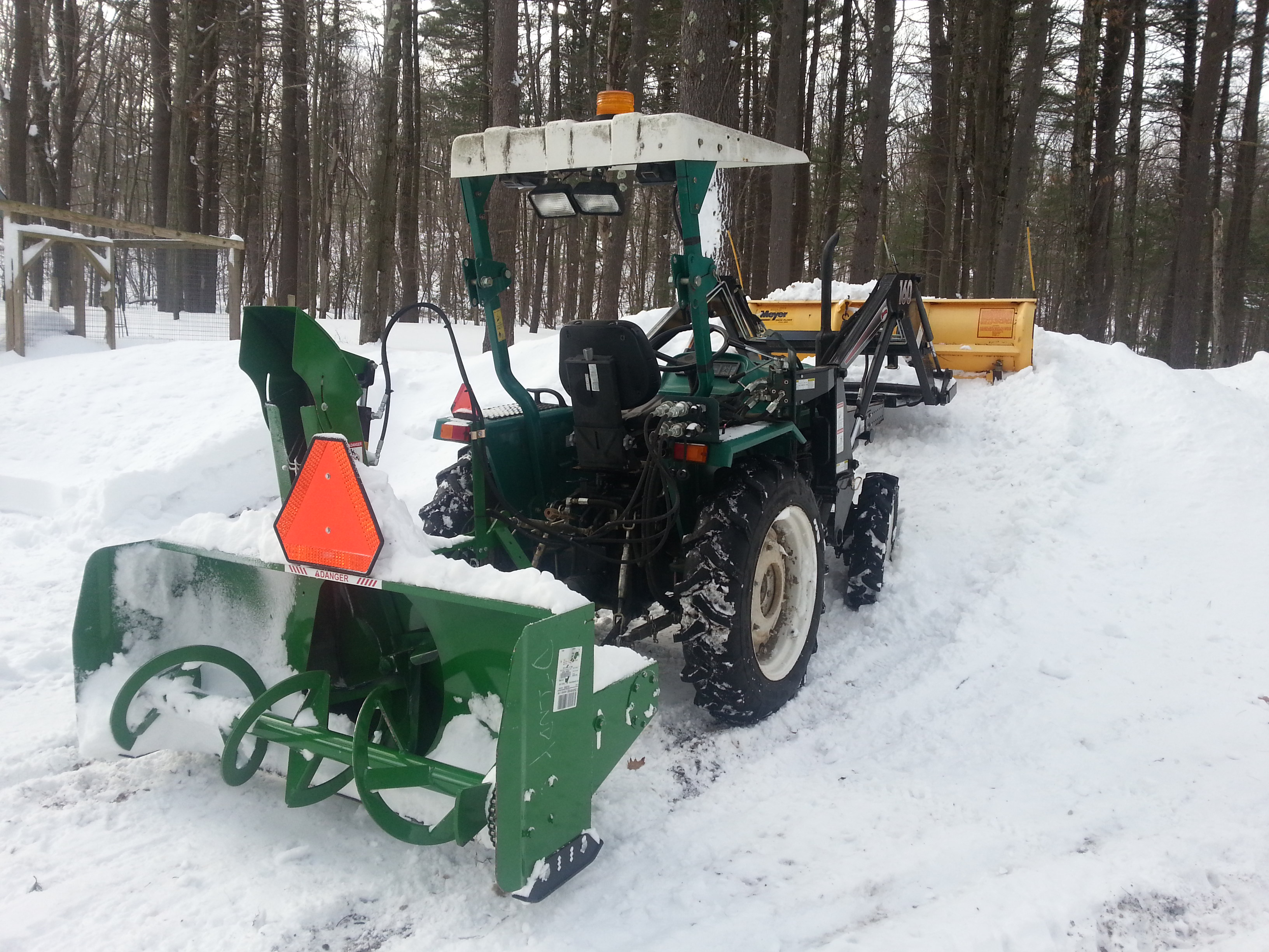

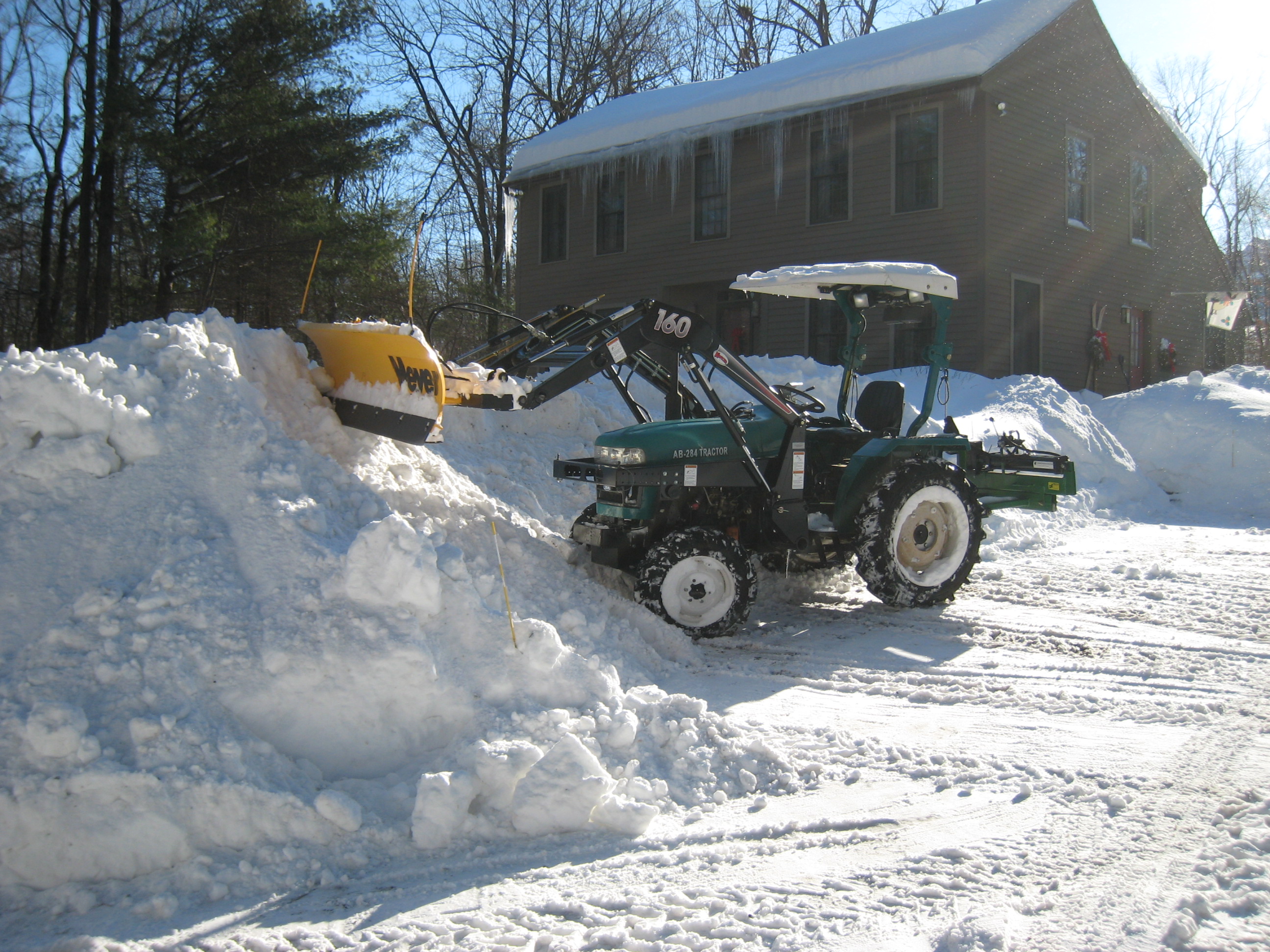

I did it myself and can email the hydraulic schematic and parts list. I needed a power beyond for my Koyker 160 loader to make it work.
The additional remotes come in really handy. I routed two lines up front to angle my snowplow so I could plow snow AND split wood.
Later, I added even more remotes to run a hydraulic cylinder plus a hydraulic motor on my 3PH snow thrower.
So, plan ahead if you're going to add remotes. It pays off.
