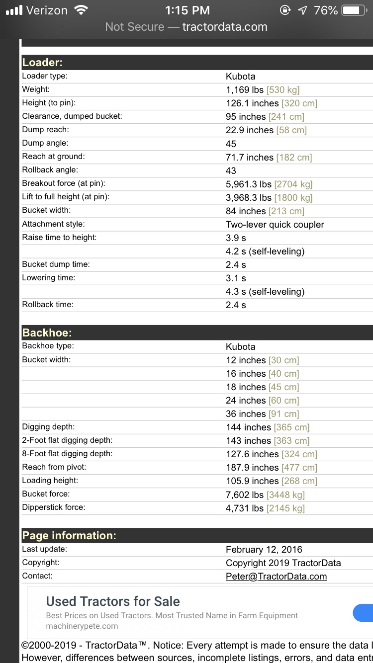

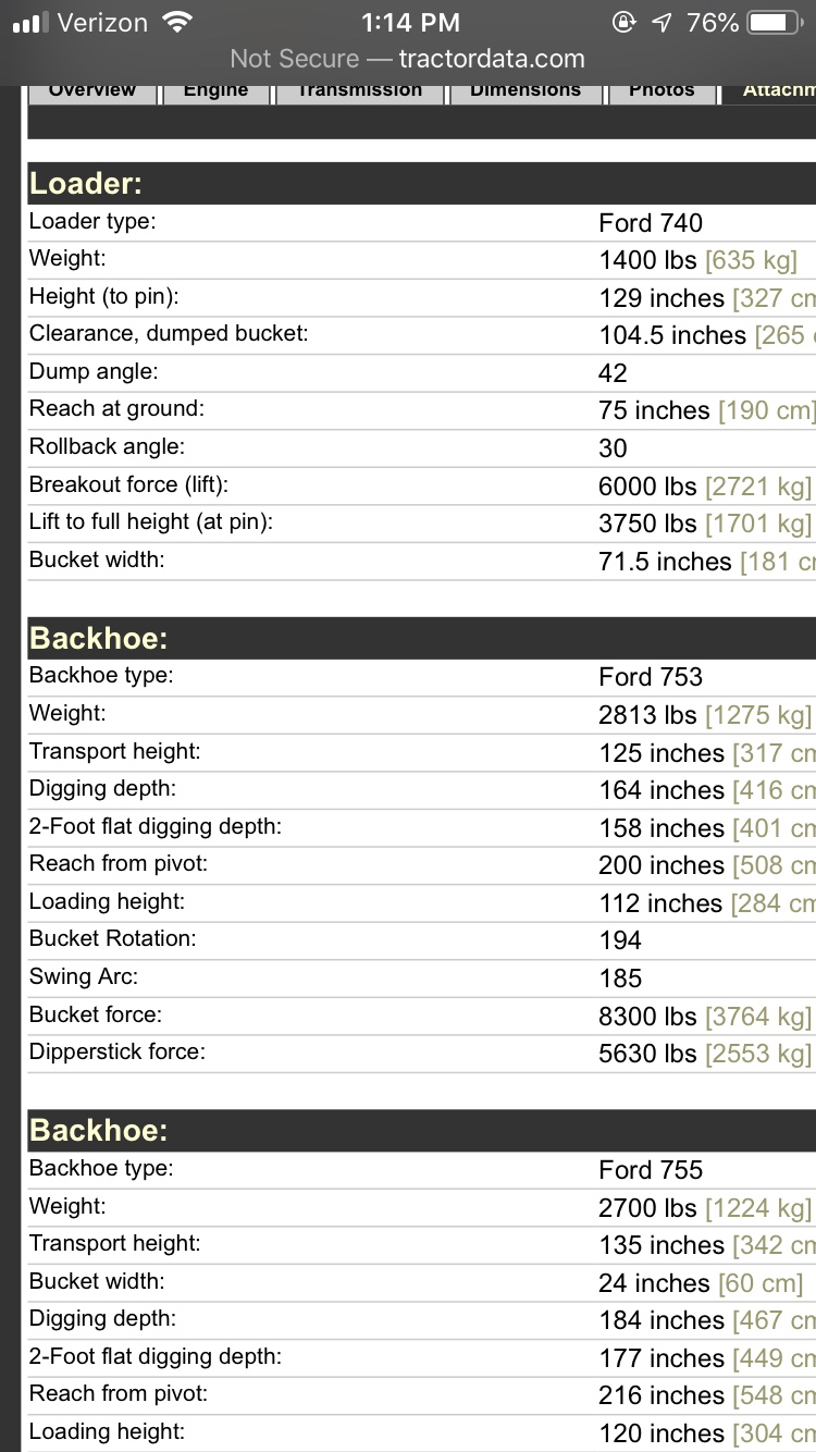

Is the Kubota as powerful as the 4500? I haven't seen anything that has the same lifting power on the boom. In addition to digging, I also use it with a thumb to move logs around and to hold them so I can saw them. Lately, I've been using it to rip bushes out from the stream bank to make it accessible.
/ Replacing all hoses on '67 Ford backhoe #5
The 4500 is a tad stronger than my m59. But the Kubotas will still work circles around the old backhoes. If maximum brute force was the goal skip the Kubota TLBs and get a full size 310. I had a 310 and traded it for the M59. So far I’m happy with the trade. IMG_7807.JPGIMG_7808.JPG
