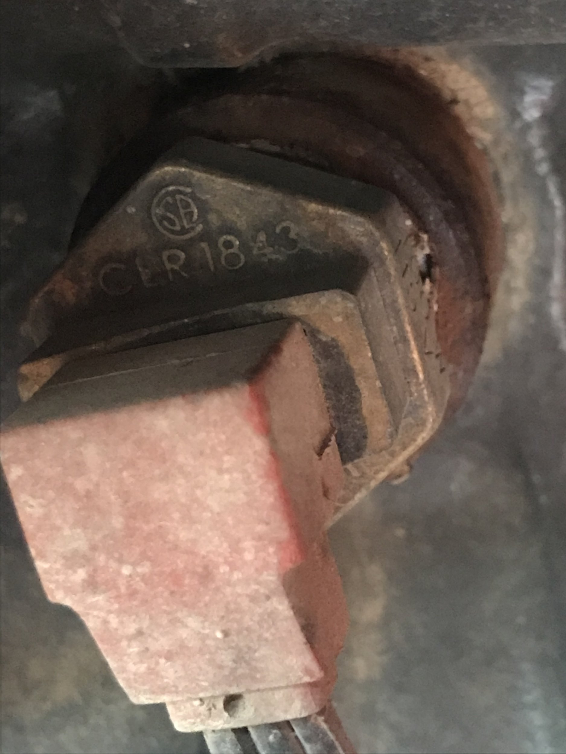

I finally was home in daylight to take this.

Now that somebody here has told me why I can't keep a heater working, I want to replace the one which I trashed. I can find all sorts of info on how to remove a frost plug (I did that the first time when I was 13). Is there any special trick to getting the old heater out? I really, REALLY don't need to mess up my block. (Kubota L3301, so I believe that it has an aluminum block.)

Pull the cord off the heater , use a socket and unscrew the heater from the block. The L3301 uses a screw in heater
