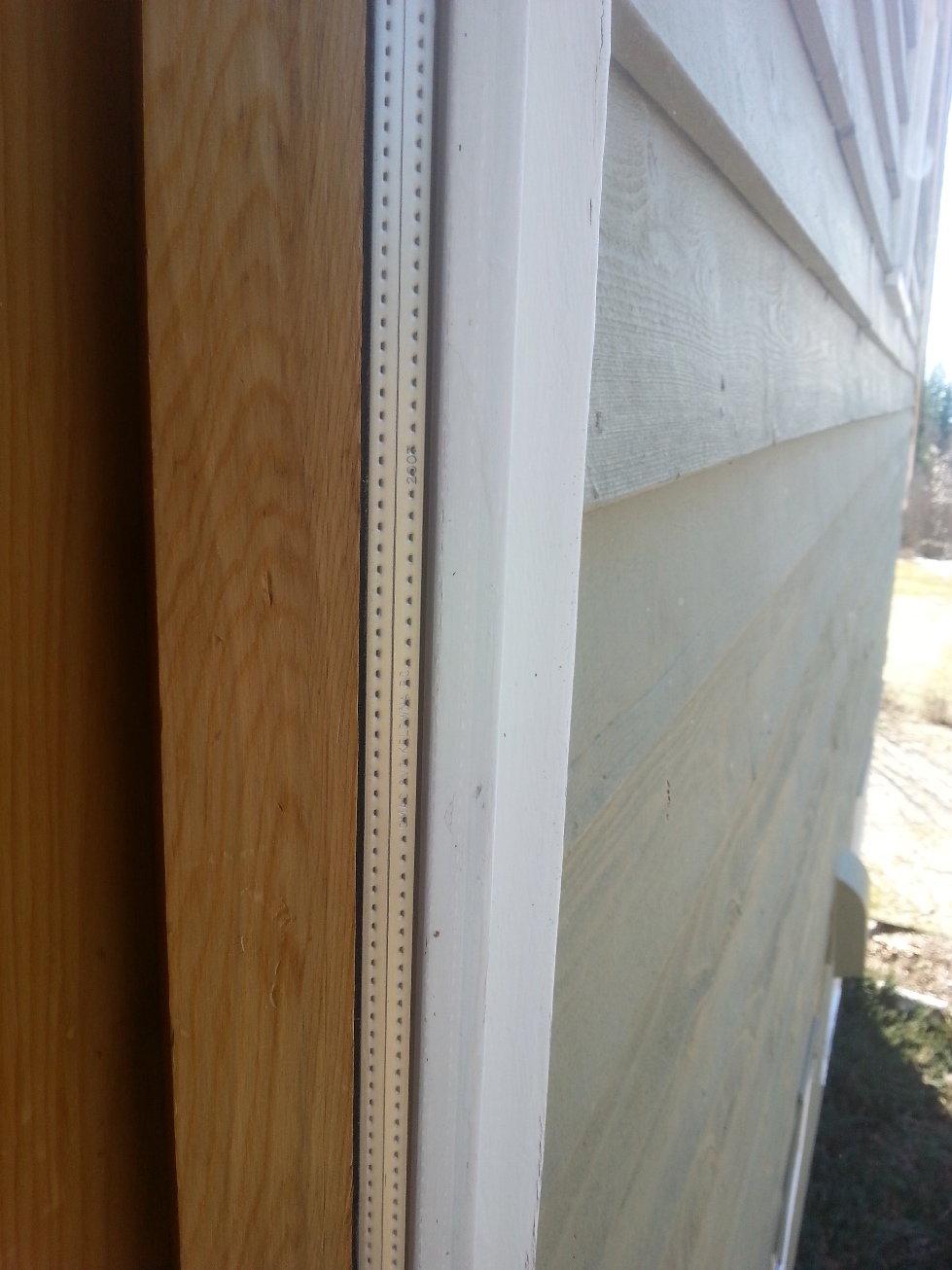

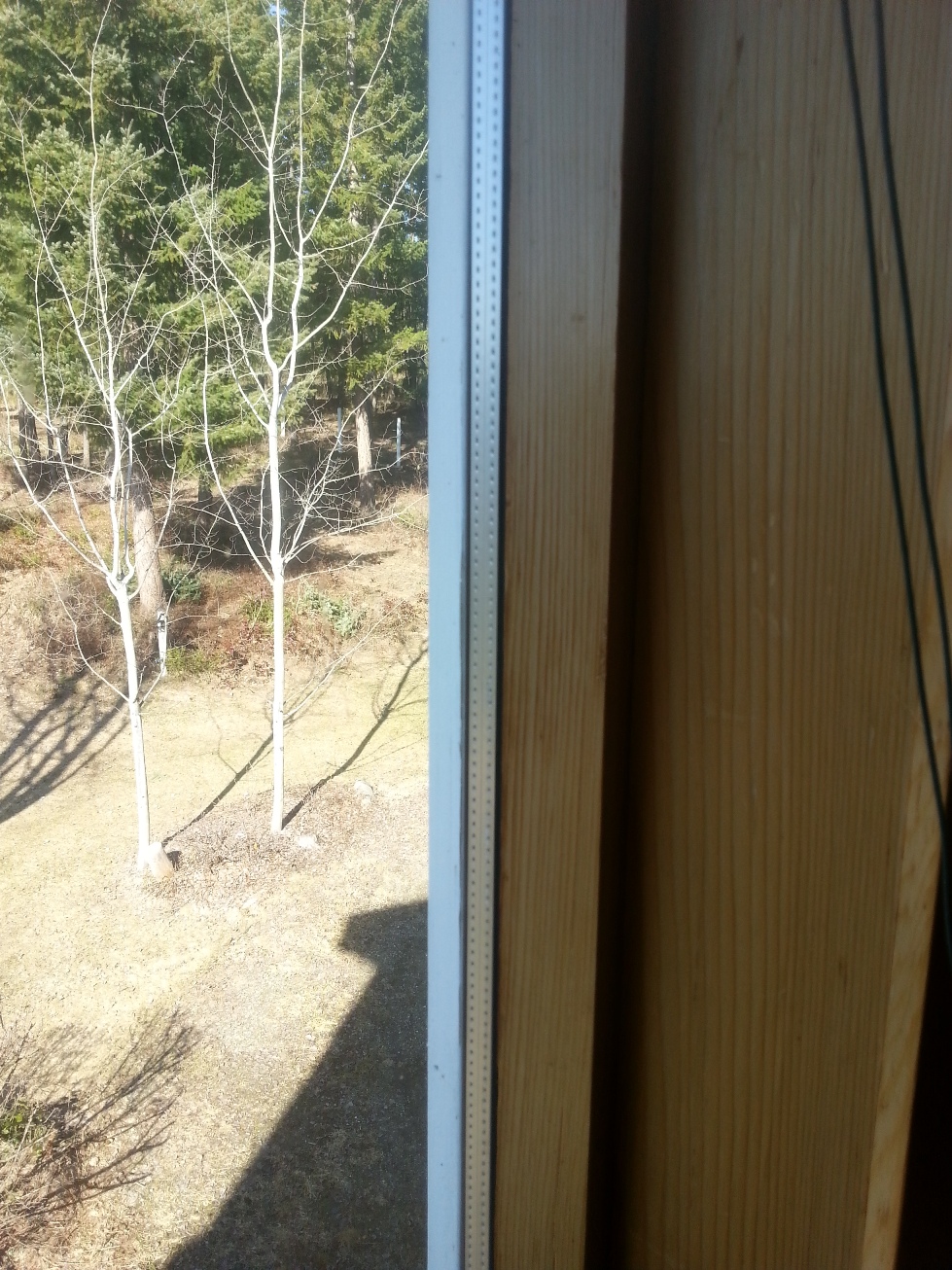

Can you just replace the glass?
All the seals of our then 32-year old home were leaking when we moved in 11 years ago. They had moisture and dirt between the panes but the wood frames we good. The local window store came out and measured all the windows, ordered sealed glass panes and installed them for a very reasonable price. They removed the outside 3/4" wood strips to take the windows out and cut new strips. As EddieWalker recommends, they put double-sided tape on the new glass panes. They peeled back just enough of the vinyl tape covering on the inside face of the tape strip so it was accessible once they put the window in the house frame. They removed the tape by carefully pulling it out between the inner house wood surface and the glass. Here are some photos:
EddieWalker, I'm curious about your statement regarding reflective glass. Our new windows have some kind of one-way reflective glass on one of the double panes. It is not a coating, and is not noticeable except it is very slightly darker than ordinary glass. I specified we wanted the windows designed to KEEP HEAT OUT in the summer. We find them very effective. They just replaced the living room windows the first day. It was sunny and warm, and we immediately noticed a big reduction in heat.
In the summer we often enjoy cool early mornings on the deck on the east side of the house. When the sun reflects off second storey windows it can generate enough heat that one needs to move, even though 15 to 20 feet from that window. The coating seems very effective and did not add a lot to the glass cost.
Are you asking if it's good? Yes, but it's pretty standard on every window I've installed. There are extra coatings that some specialty stores try to add on to the cost of the window that you will never notice. A decent window will come with everything needed to make it pass all the energy requirements out there. Then there are the bonus things that will not improve anything.

Thanks, Eddie. Yes, I was wondering if some options are good. I'm not sure what we got, but just one of the two panes had it, and it just works one way. We did not want windows like those ones in office buildings that look like mirrors. Whatever glass they used keeps heat due to sunlight out much better than plain glass. As noted above, they were not much more expensive than all plain glass.
We were lucky that our window frames are all sound and of simple construction. And we were very pleased with the local business that did the work. They seemed very diligent in sealing the new windows. In fact, on one of them the helper broke the shiny protective cover (that is removed so the tape sticks to the wood) when removing it after installing the glass in the frame. Some of the glass was stuck to the frame and it was a chore to get the glass back out. But they did it, cleaned everything, and reinstalled the whole thing with new tape. It's really nice to have diligent contractors.
