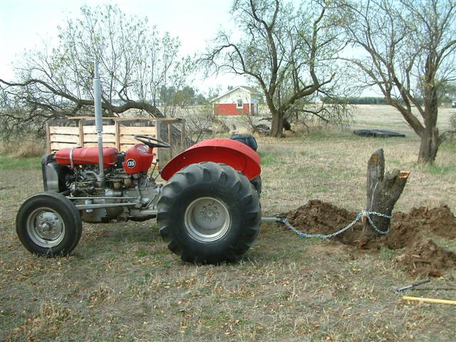

Is your MF35 gas or diesel? If diesel, you have a winner in that Perkins engine. My 1964 MF135 Deluxe has the Perkins. No problem with the engine so far, but it's in my shop now for a clutch job.

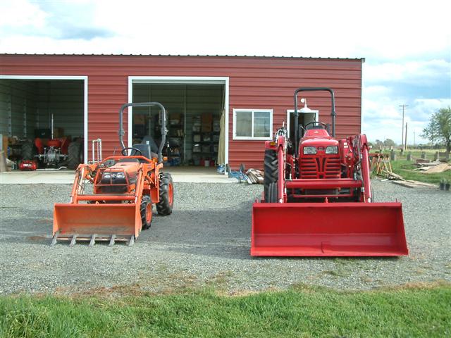

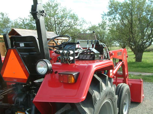

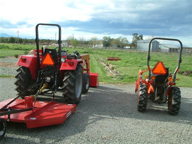

My FEL tractor is a 2008 Mahindra 5525 (54 hp engine, 45 hp pto, 2WD, gear tranny 8F/2R, power steering) with the ML250 FEL (6-ft wide bucket, 2950 lb lift to 10.5ft high). Traded that 2005 Kubota B7510HST for the 5525. I had the dealer install triple remotes on the rear fender.
Cost: about $18K
My neighbor has a Kubota L4400--one nice tractor. IIRC he paid new about $22K including FEL, a box blade and a PHD.

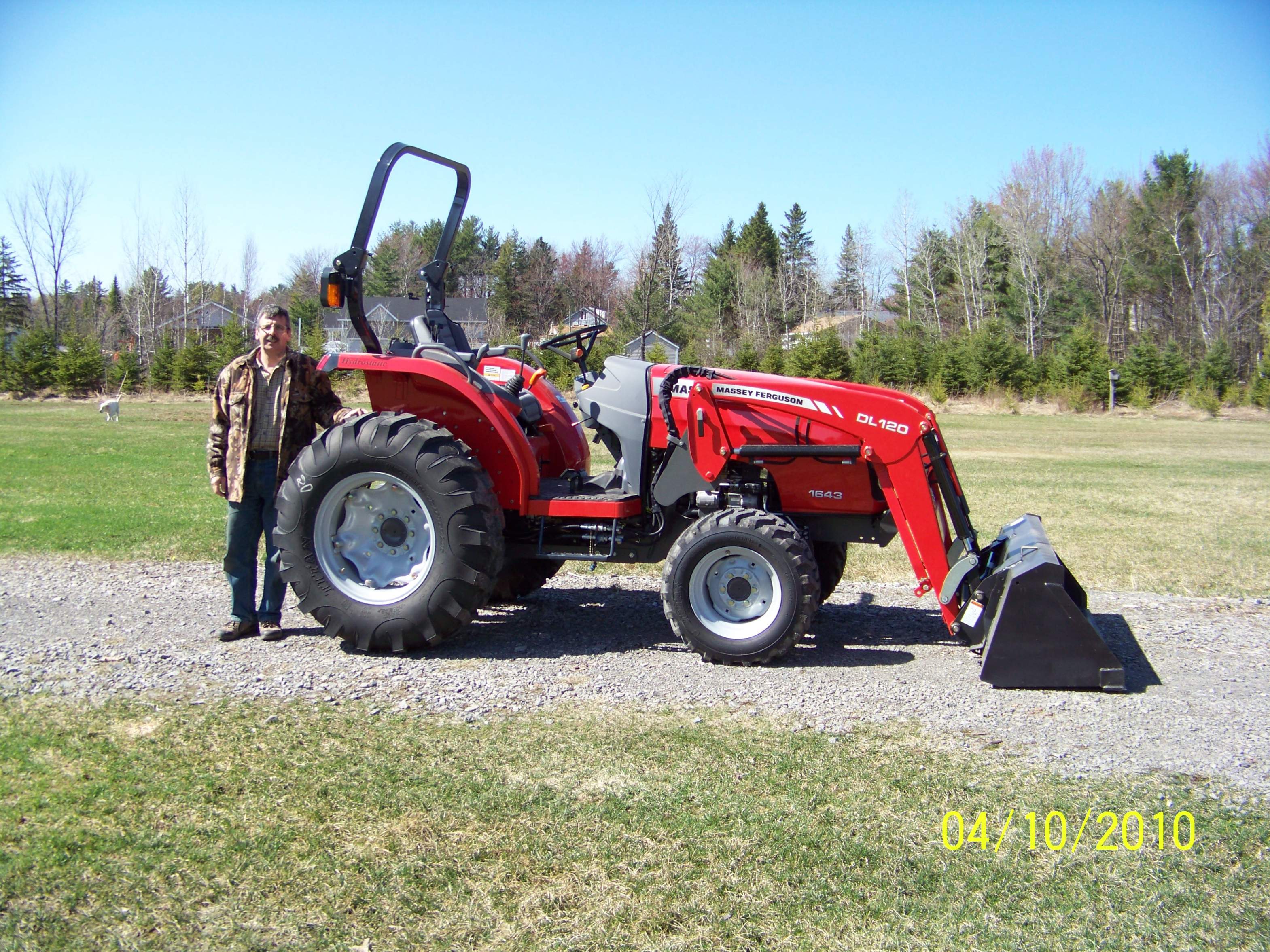

Hi. If you want to stay in the Massey family :D you can look at the new 1600 serie. I just bought a Mf 1643 HST, 43 hp, very confortable tractor, with the loader it is 4400 pounds or so ( my tires are not filled), a very good hydraulic flow (16 gpm) it,s a real dream ridding this machine, go and try one you,ll be surprised, no engine vibration. Good luck
