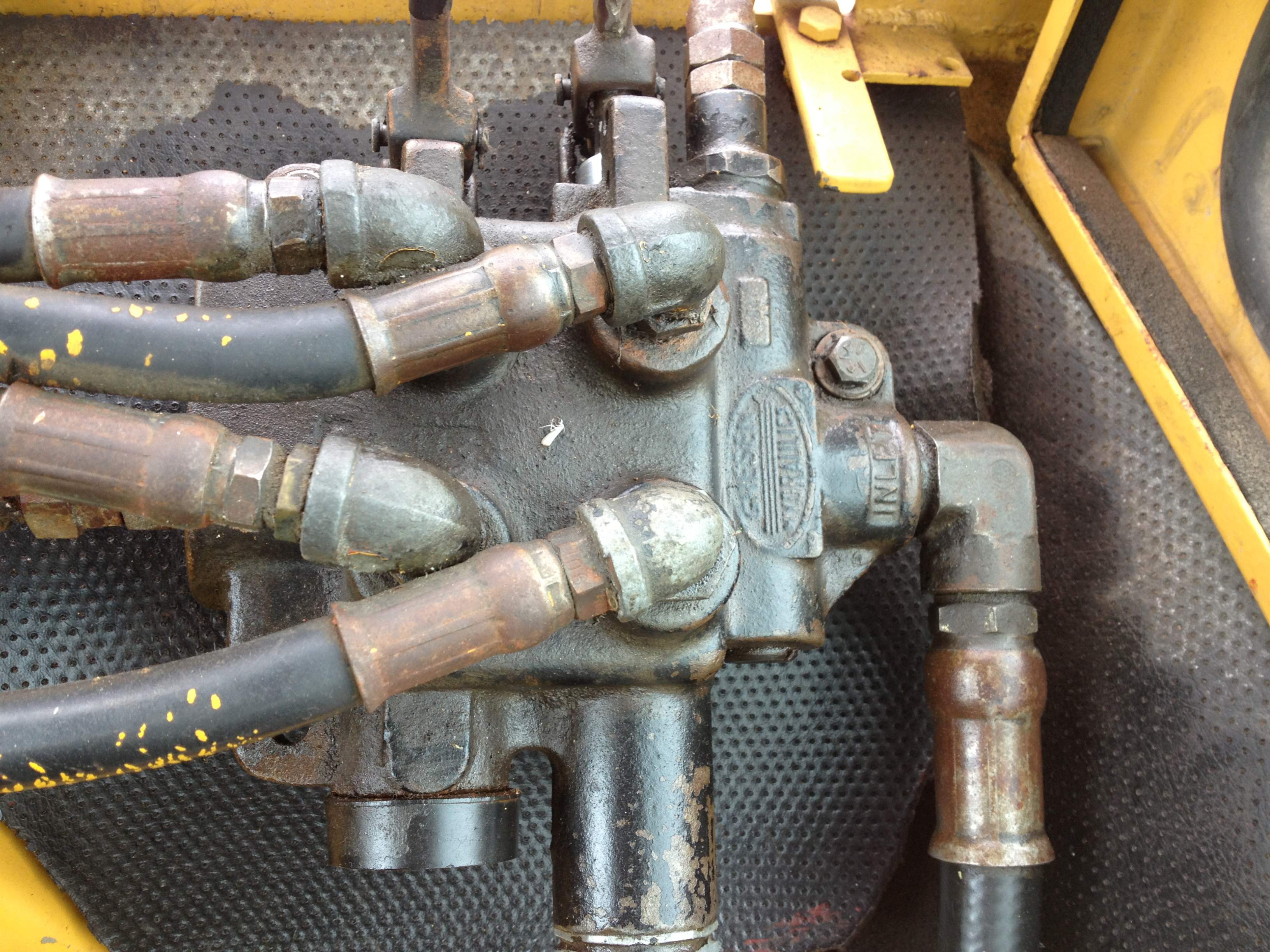

I own a Massey Ferguson 50c tractor. My directional control valve for the rear remotes is leaking, also I find that one of the spools binds when pushed in. The valve is made by Gresen, though the model number is illegible. My hydraulics is rated at 29GPM. What would be a goood relpacement valve for my tractor. My primary use for the valves right now is chute control (a motor and a piston) on my snowblower, although there will be other implements I may attach in the future. Thank you.

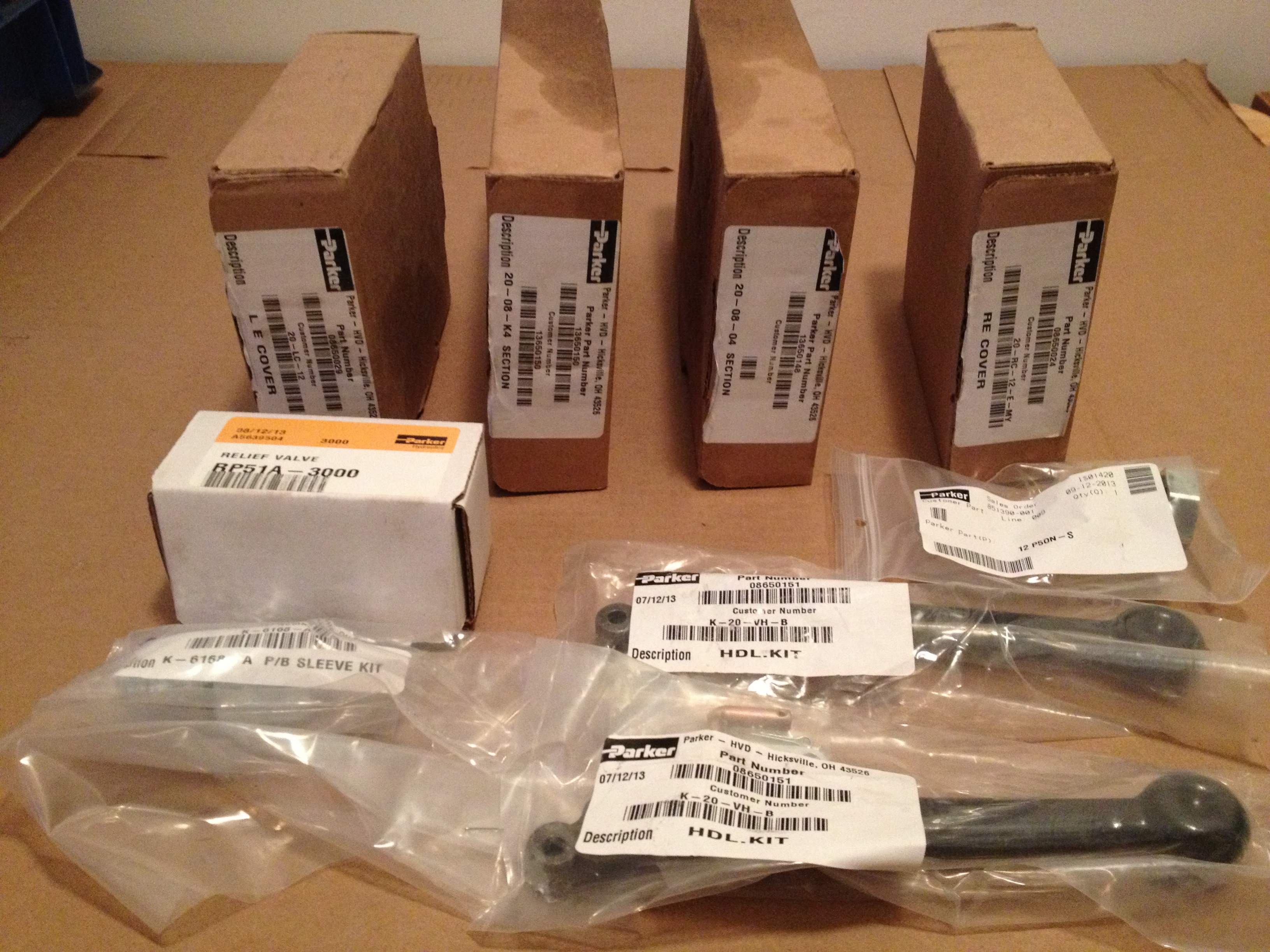

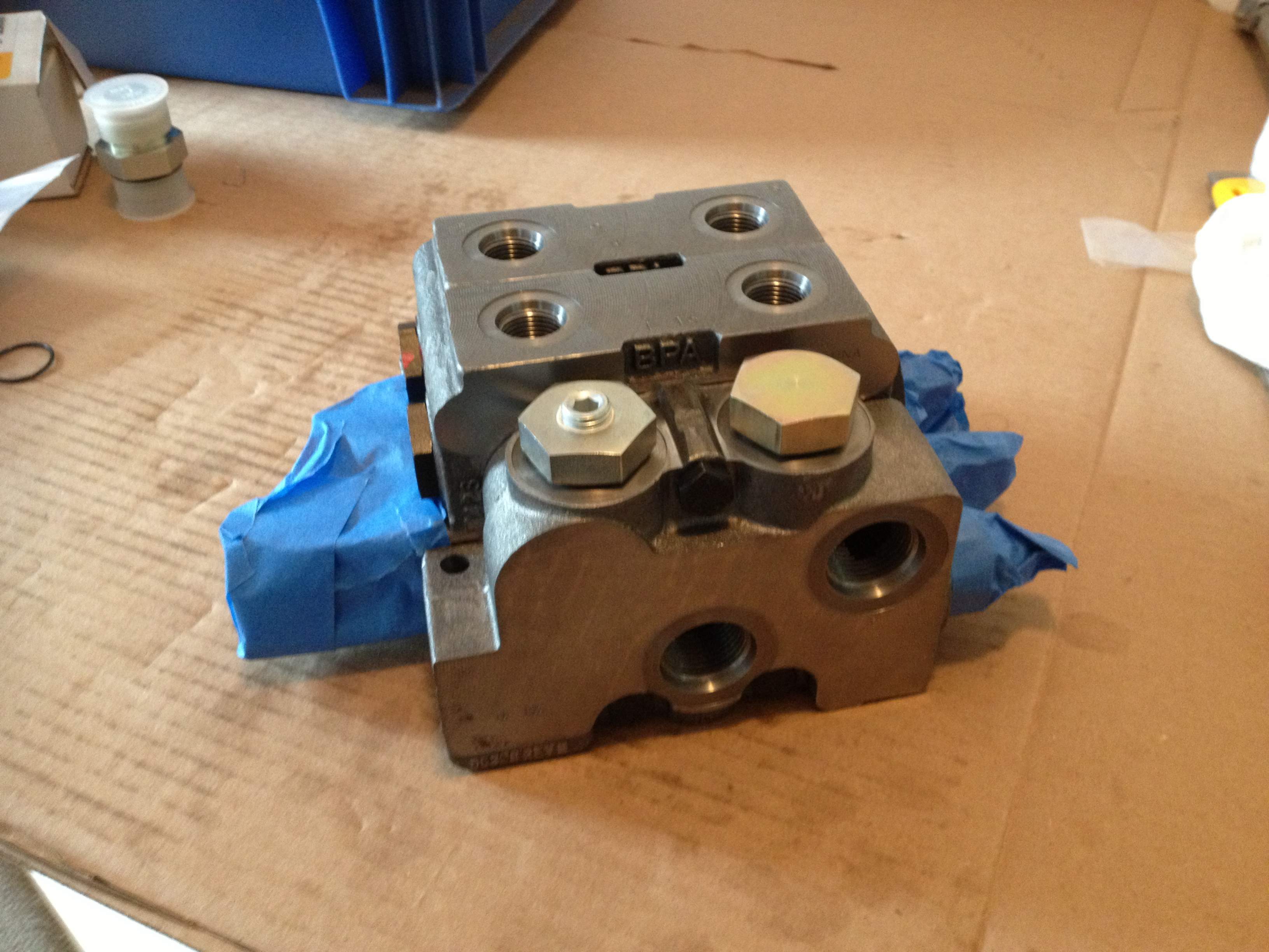

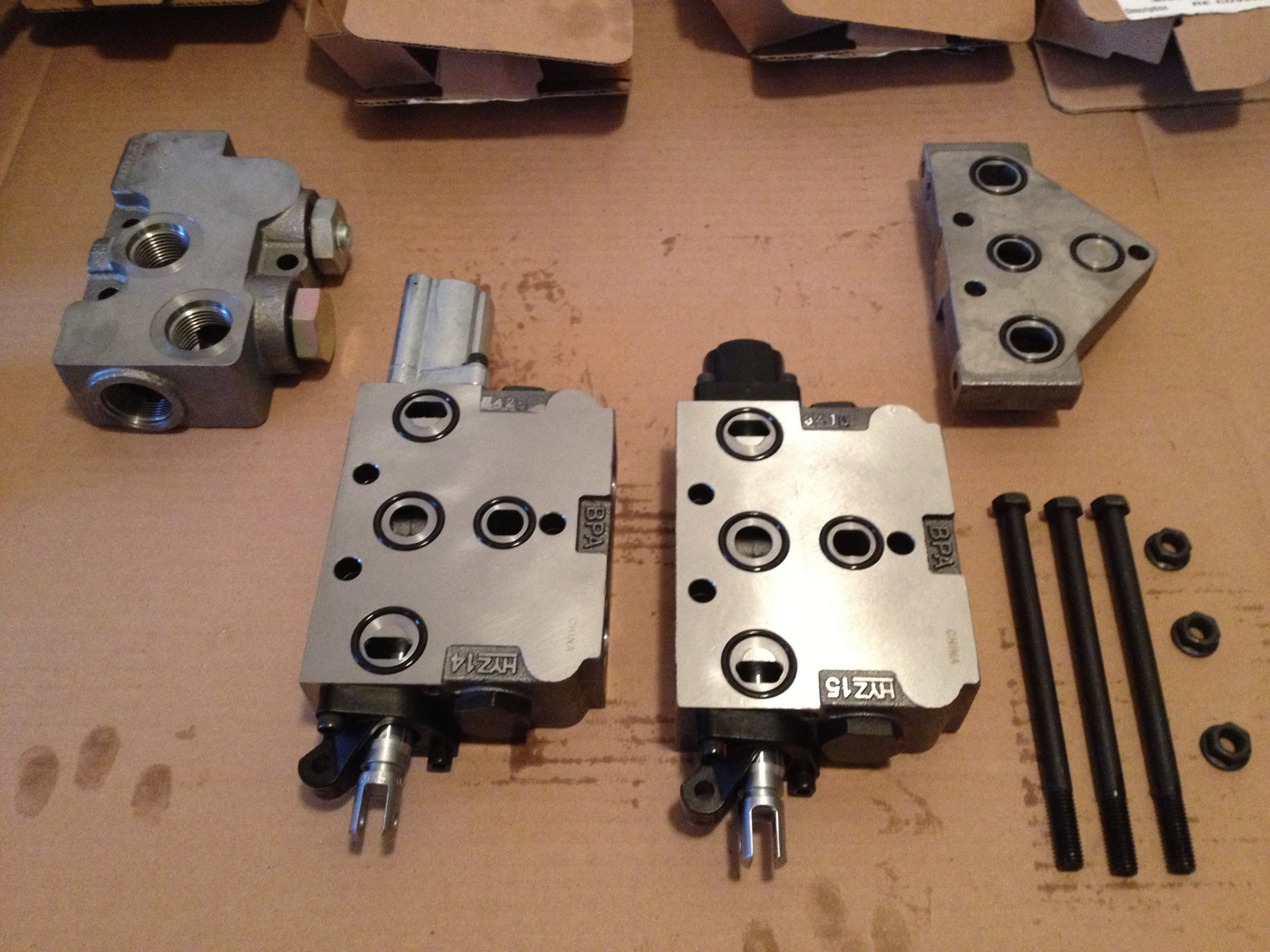

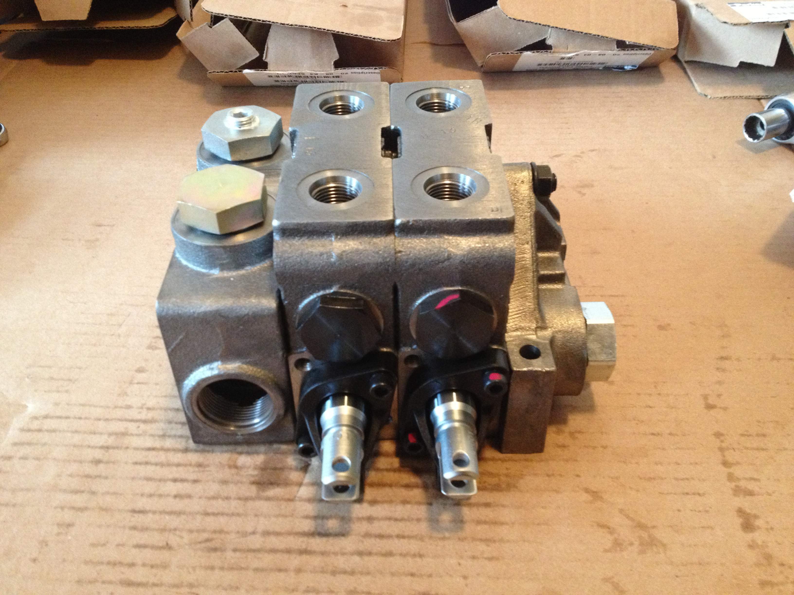

I'm reviving this old thread, as I have finally decided to take the plunge.
I have decided on a Parker V20 sectional valve with Power Beyond.
I am purchasing 2 sections, (for now), one with a float position.
Before I proceed with my purchase ..........
Any comments on my choice?

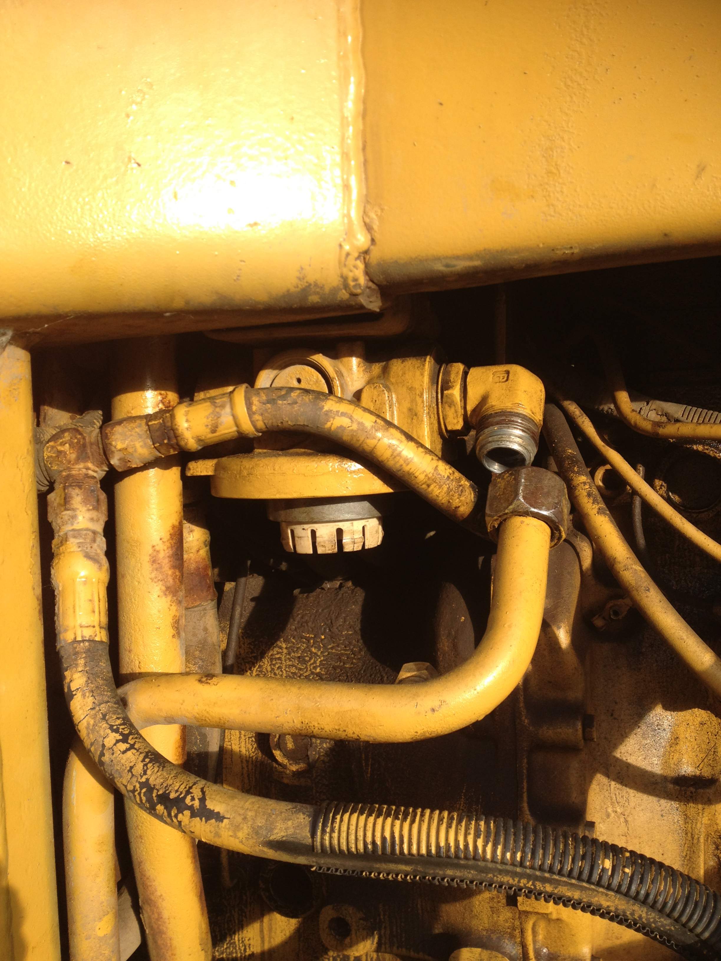

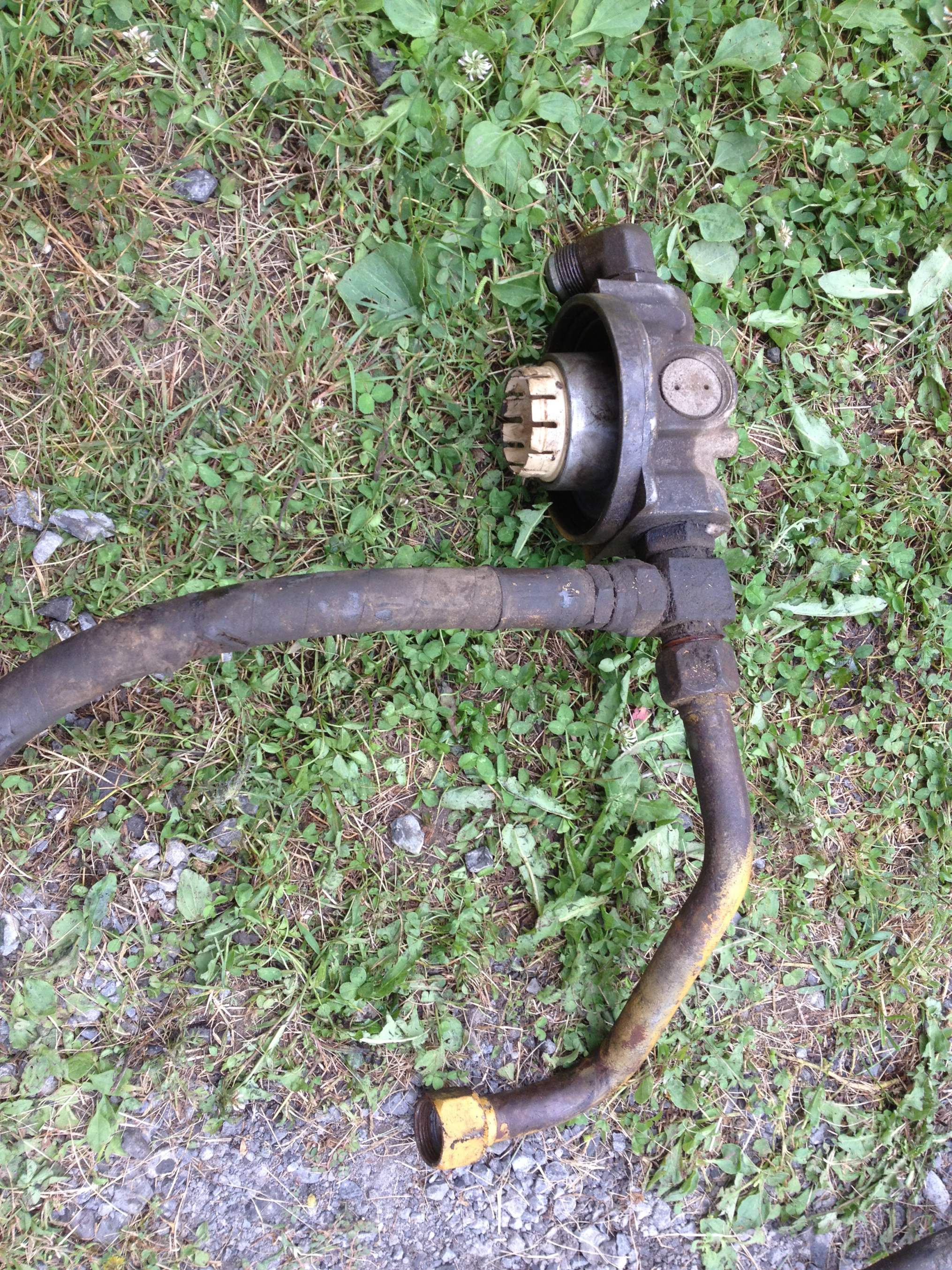

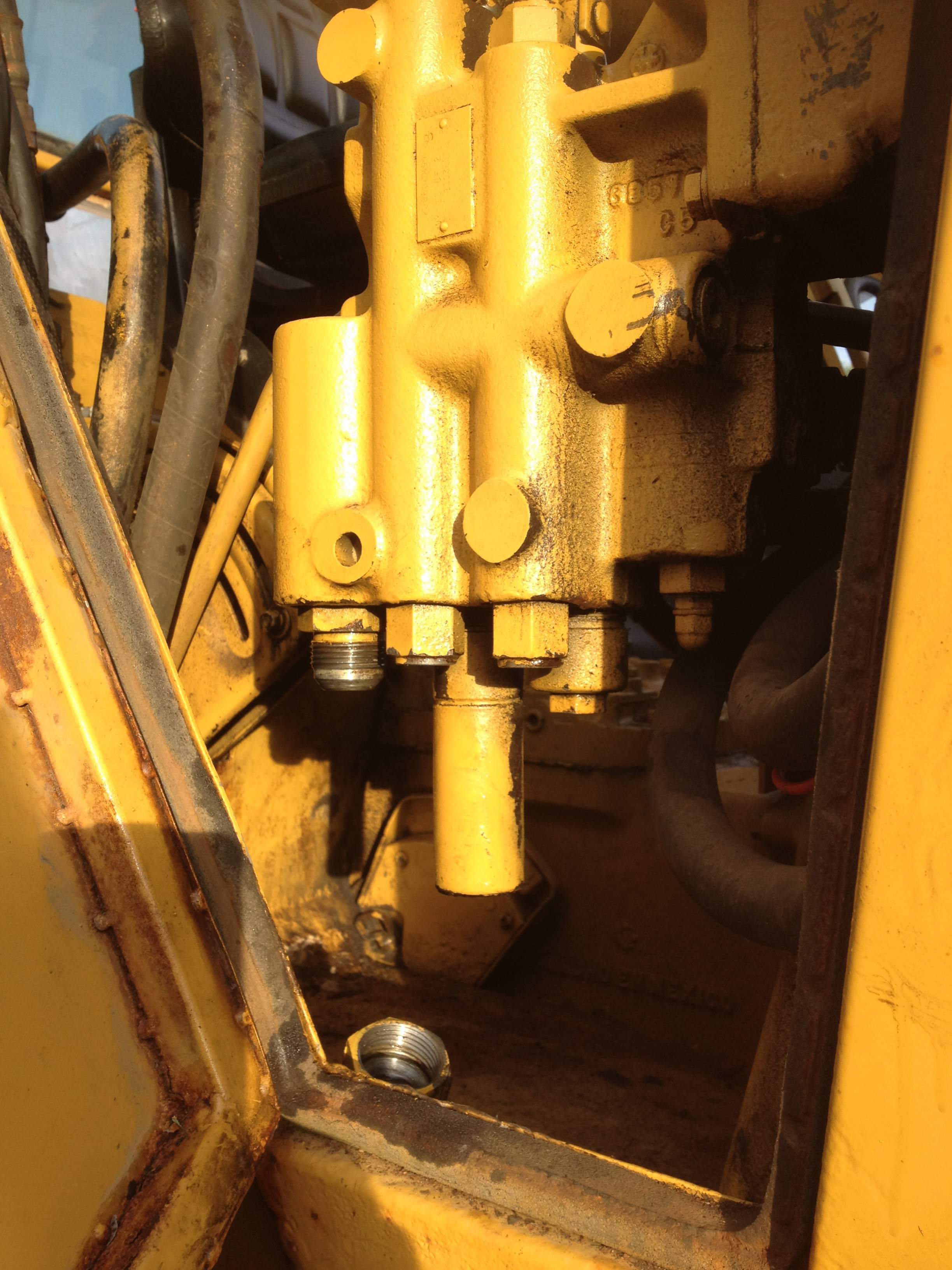

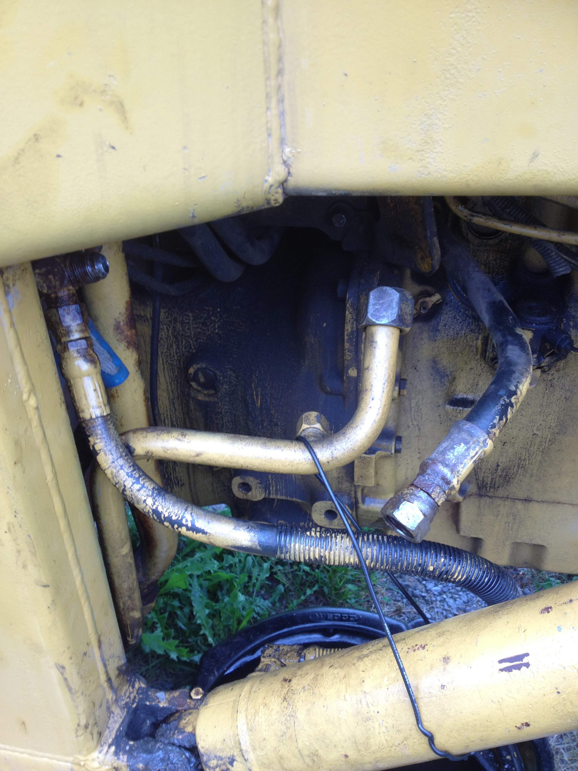

Got down to work last weekend. Drained my hydraulic fluid, removed the filter, and suction filter, and pulled out the old directional valve.
As you can see I have to change quite a few hoses and fittings to change.
Already I see a problem, I notice there is a JIC SAE14 fitting going from the loader valve to the remote directional valve.
I'm looking at Parker fittings but I don't see many with a SAE14 end.
What I'm looking for is a SAE14 jic female swivel, connected to a 1 inch (-16) hose.
Do you see any other options?? :confused3:
