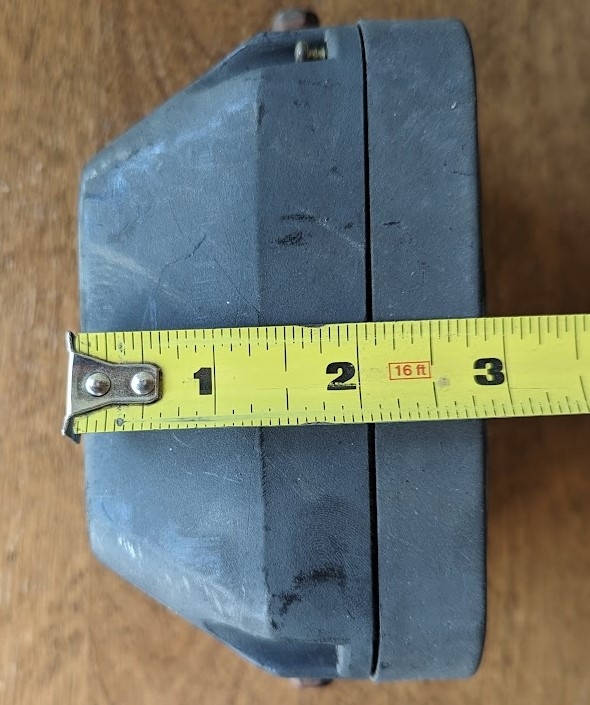

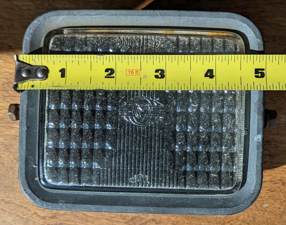

Has anyone found more or less direct LED replacements for the cab lights on a DK45s? I have one that failed completely and the others just don't give off much light. The dimensions of the stock lights are (pics below):
  • 5" wide (with side mounts)
  • 4.25" high
  • 3" deep
They are marked at 35 watts.
Also, the front lights have 2 wires and the back lights have 3 (more pics below). Anyone know why?
Thanks Much!
Billboe

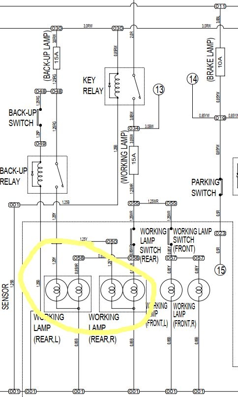

regarding 3 wires on the rear cab lights... i took one apart and the bulb has two filaments so they appear to have two brightness options (which i either didn't realize or just forgot). the bulb is marked:
kha 12v21/5w 63 5 (not positive about the 63 5 at the end; hard to read)
not sure i'll find a LED fixture with two brightness settings like this?!?

in case anyone is interested, the 3 wire lights in the rear are for backup lights & working lights. i didn't realize there were backup lights. below is part of the wiring diagram for the dk45sc...

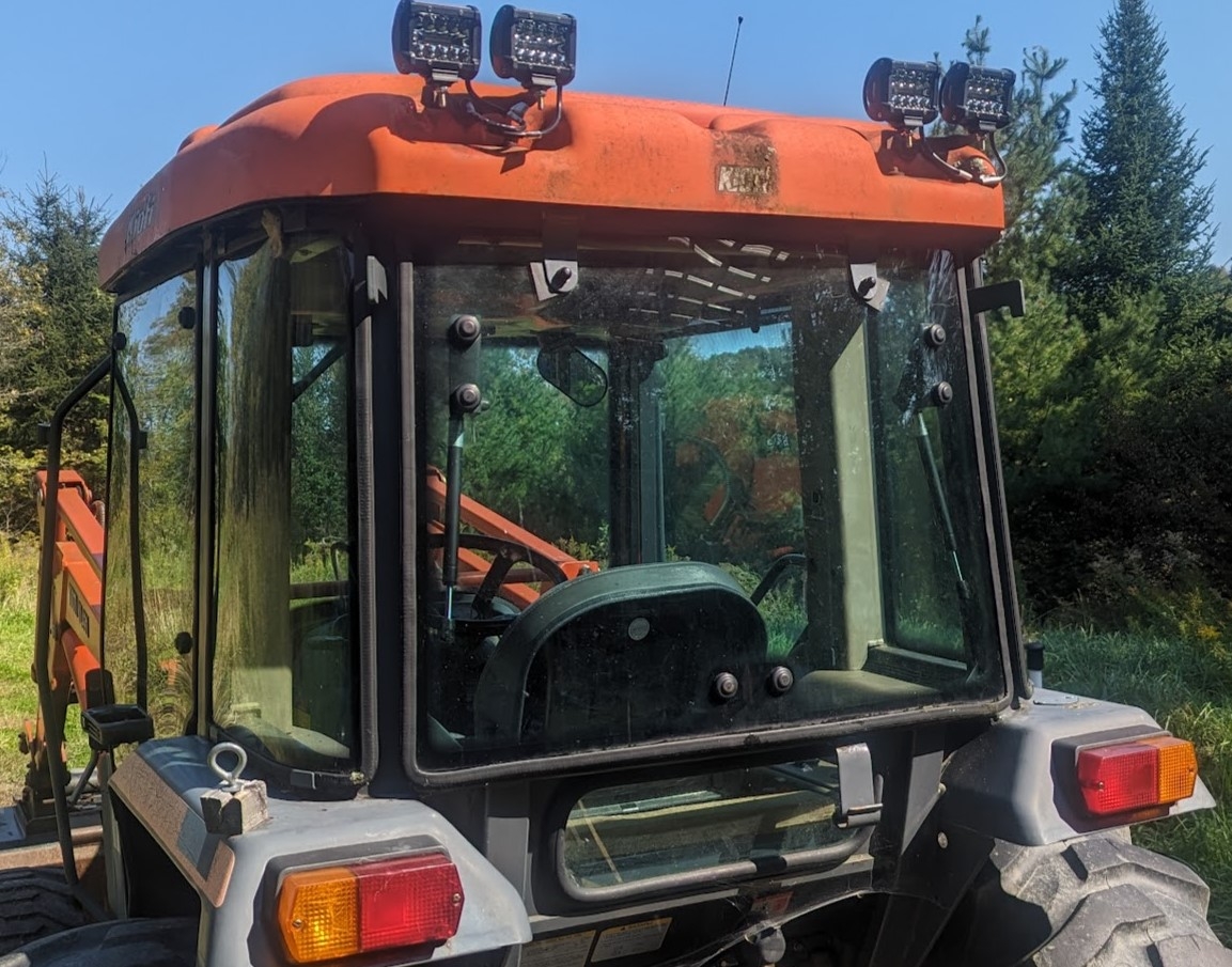

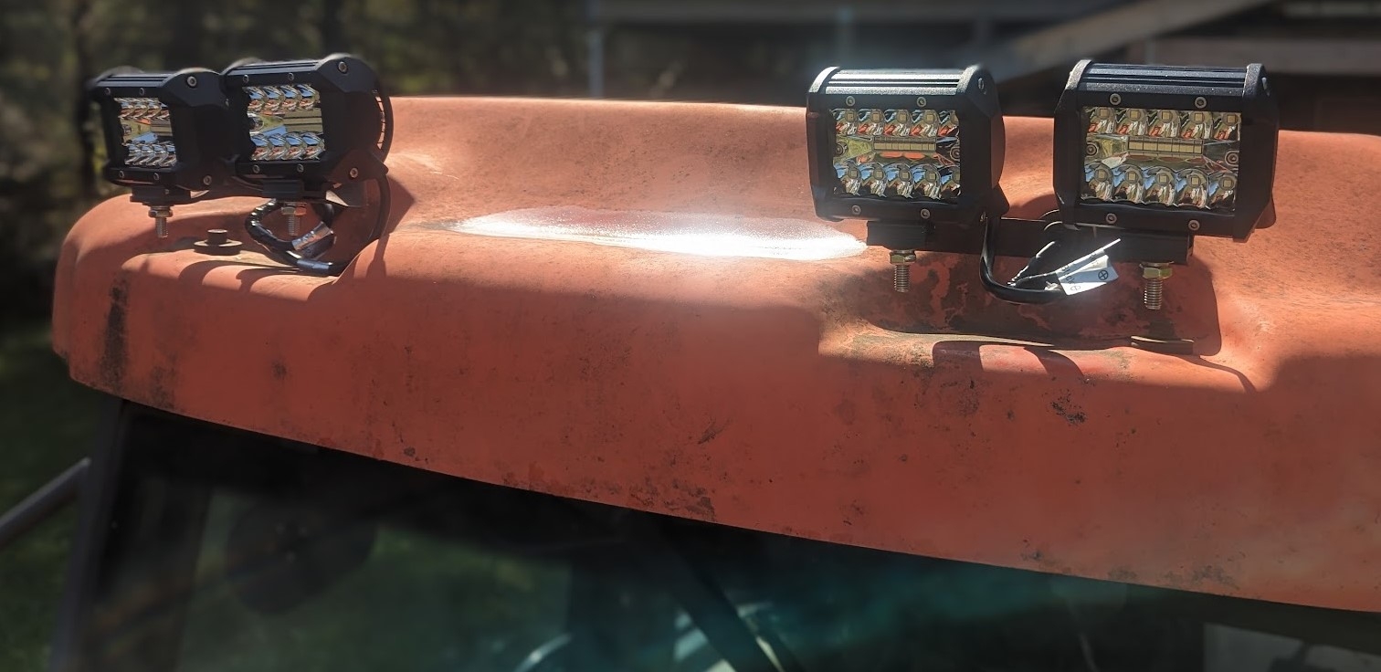

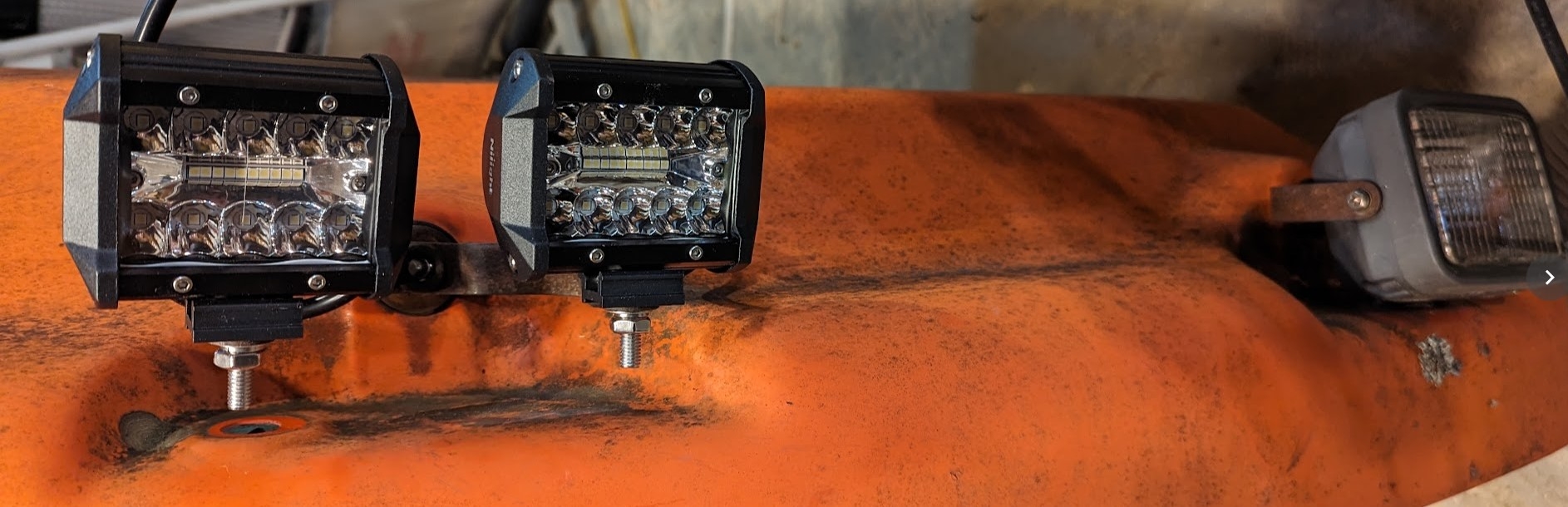

I now have working cab lights. I replaced each old ones with two smaller, inexpensive LEDs. The new LEDs had a very simple bottom mount and instead of creating a new mount for them I took each arm of the old bracket and twisted it flat (i.e. horizontal). I did need to enlarge the mounting holes slightly for the bolts that came with the new lights to fit.
Finally, I'm not sure if this was a good idea or not, but for the rear lights (which had 3 wires; ground, back up, and work) I just tied both the back up and work light wires to the red wire on the LED. This causes the rear LEDs to come on either when in reverse or when the rear work lights are on or both.
I haven't done any work with them yet, but they seem plenty bright... And they are a little higher that the originals but I'm not in many trees, so, hopefully they will survive. OH! the amazon listing says they are 60 watts but as many of the comments state, they pull MUCH less than that (probably 15 watts a piece).
Here are the LEDs I purchased from Amazon...
And here are a few pics:
