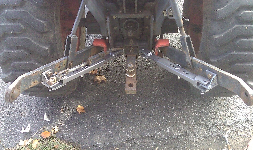

Thanks to this thread, I got a set to put on our B7500. Great communication from Mark and they were exactly as described. One note, the tab is no longer on there (unless you request it), he now just uses a short chain.
Installed on both sides with an old turnbuckle on top for comparison:

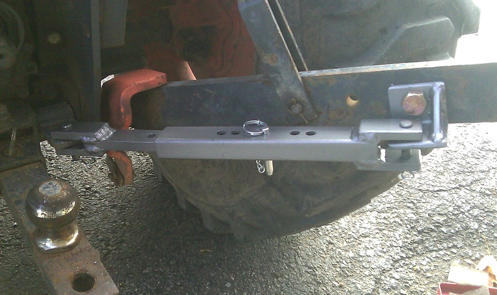

Closeup of the one on the right side:
Installation was simple, I cut the turnbuckle link off of the tractor end, pinned the stabilizer in its place, unbolted the other end of the turnbuckle from the lower arm and bolted the new bracket into place. I think it took ~30 minutes INCLUDING driving the tractor to my inlaws, getting out the tools and putting them back away. I am very happy with them.
They will help keep the trailer from jamming up on the lower arms and will make attaching implements a much easier exercise.
Aaron Z
