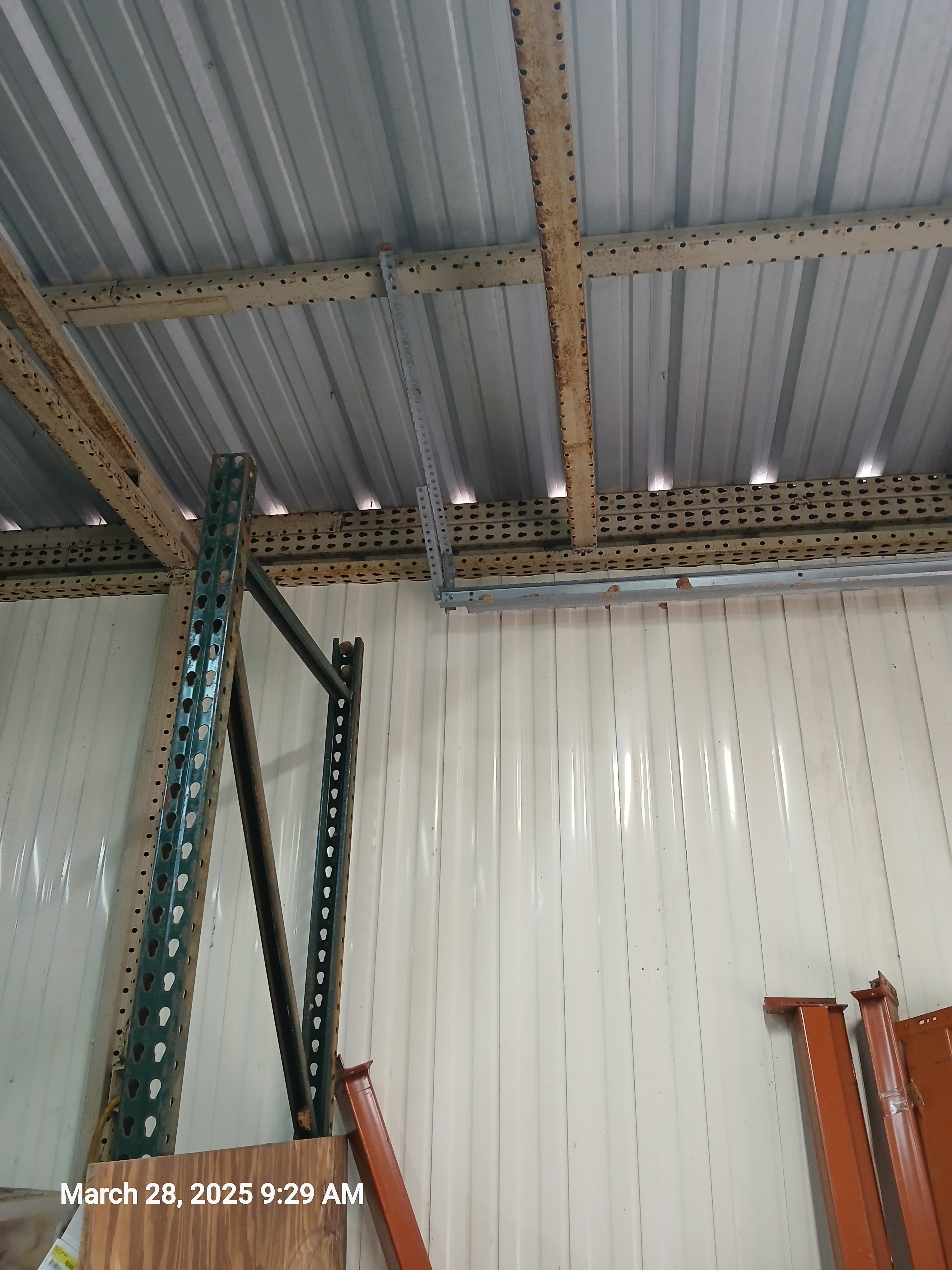

I've got an RV shed with about a 12x14 sectional garage door on tracks.
When I bought the place ~ 12 years ago it was manual. No helper springs or motors. For all these years I've just lifted it up and put a 9' piece of 1x6 to hold it up. I'd spray the rollers with garage door lube when it stuck and it worked for me. Probably only opened it 50 times a year at the most,
Well, due to the expanding universe it's gotten heavier. I'd like to put on helper springs or a motor if they were affordable. Less than $500 and DIY.
Any suggestions?

Pictures would help. A jackshaft opener is fairly cheap, but needs a spring assisted upper shaft.
/ Repairing/upgrading RV garage door #5
So when its fully down, there isnt a bar and spring assist?
Im not sure this is something that can just be added, ive never seen a roll up door without one

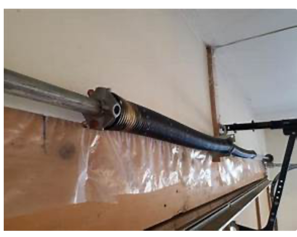

You're gonna need the springs, bar, brackets, pulleys, cables and whatnots that are in grsthegreat's picture.

Would like to know the story why only half of the complete door was installed!

The door should already have springs at the top - probably two. One could be broken. They are hazardous to work with as they're under tension and you need a couple bars to adjust them. Contact a garage door guy as any assist you add needs the springs to be in place and properly adjusted. Once that is correct you may need no additional stuff. You can add a chain hoist to ease manual opening (under $200) or you may opt for an electric opener (more expensive). Good Luck.
