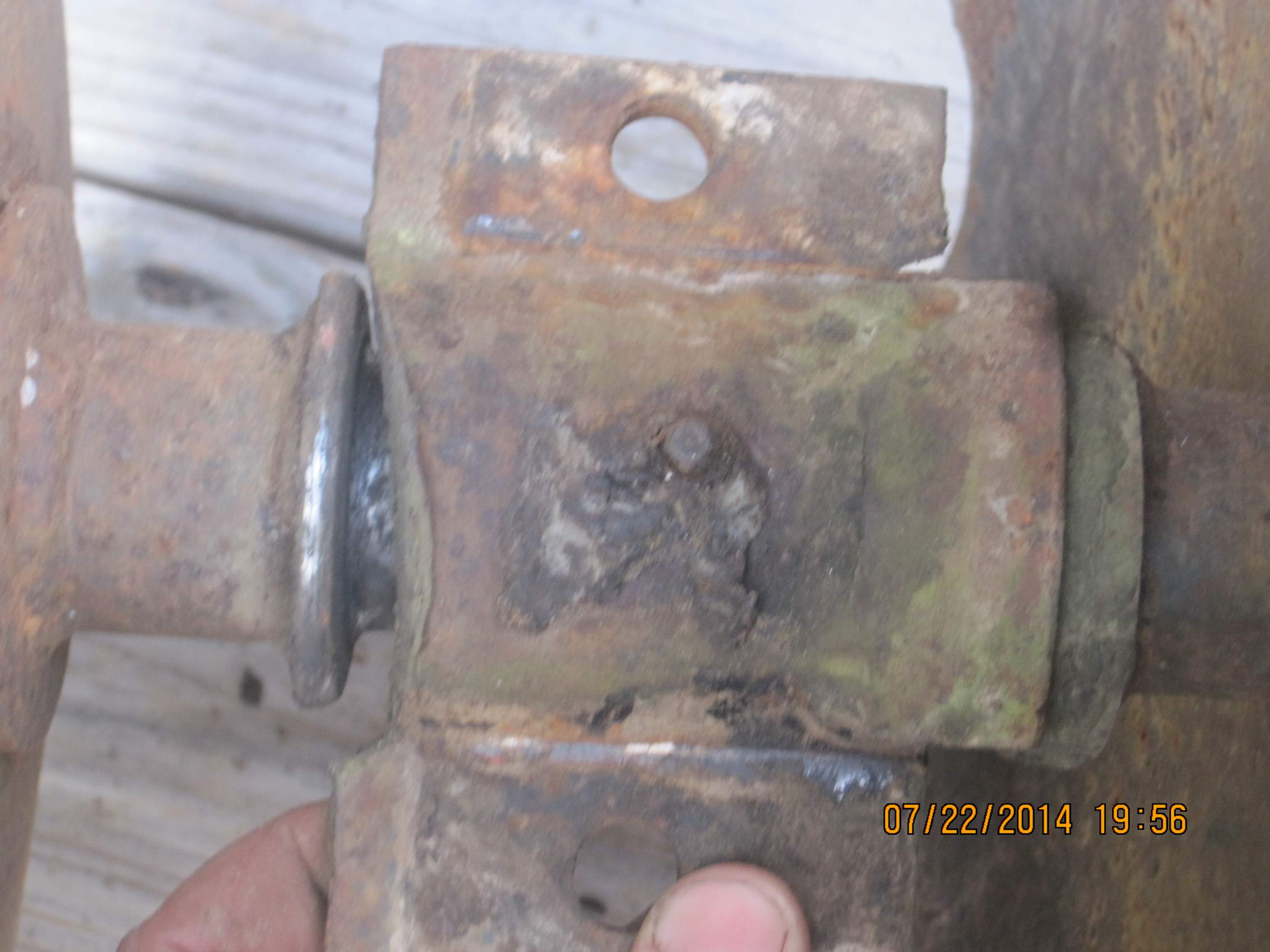

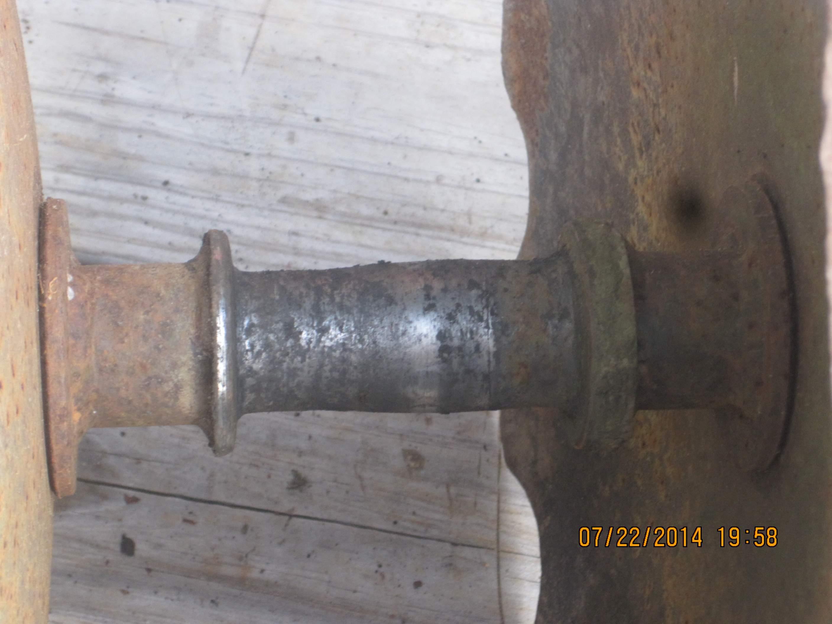

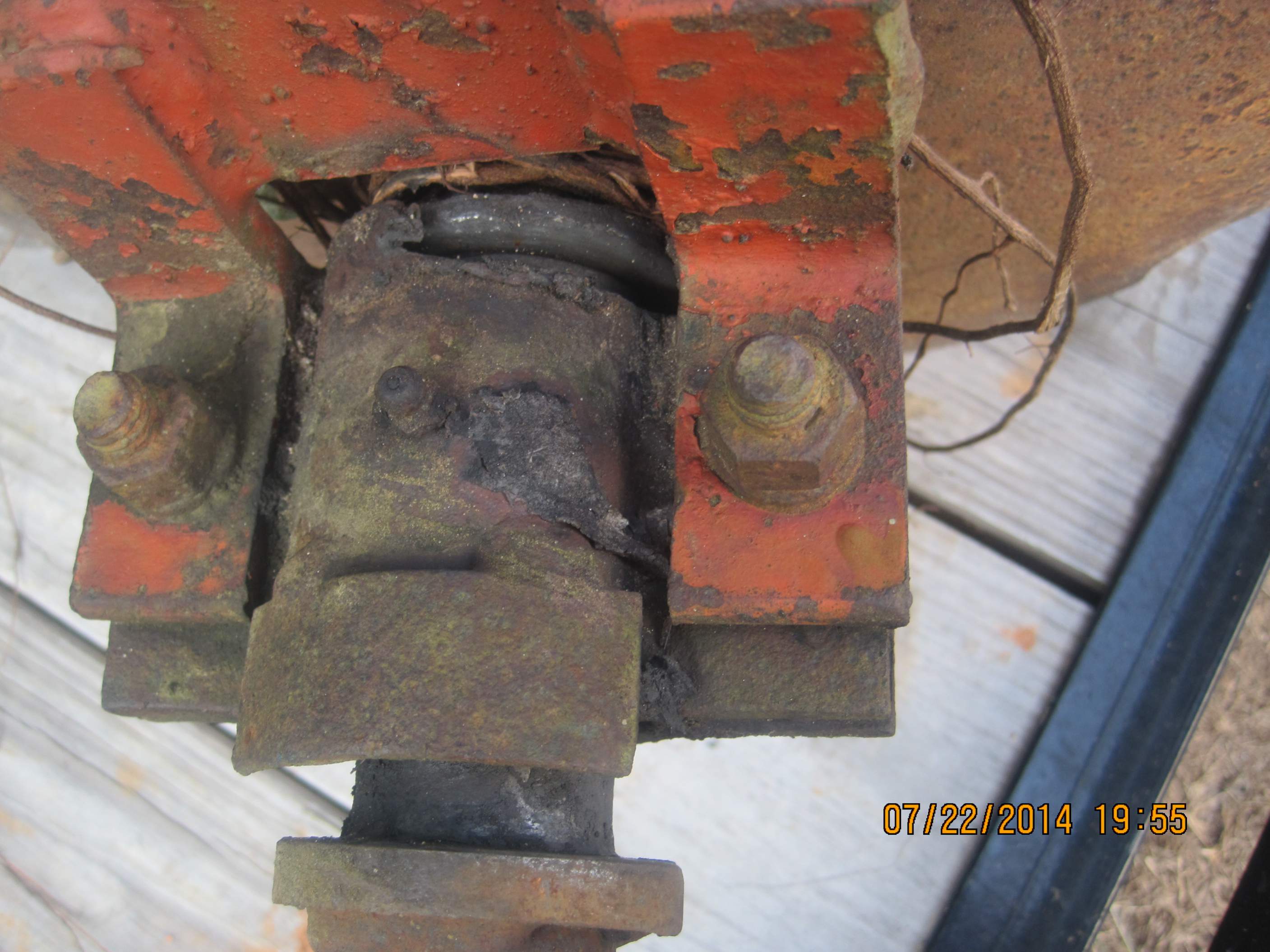

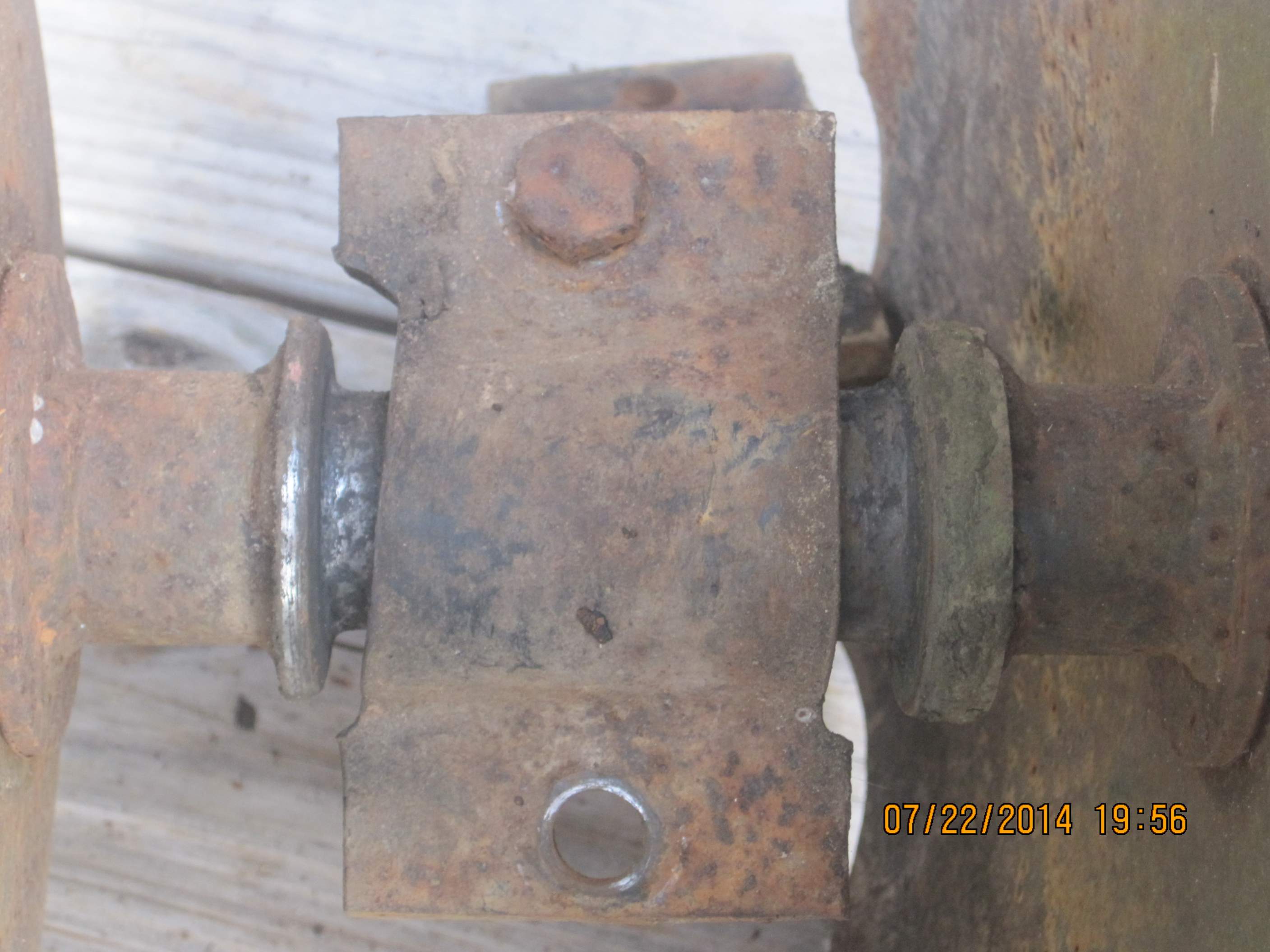

I have acquired an old tuf line disc and have no money in it as of right now but it needs a few bolts and friction bearings, i am including a few pictures finding the bearings really worries me, can someone give me an idea where i can find them ??

cut the angle part out (worn out area) to square up the brackets. toss in a few "flat washers" to remove majority of the slack, give it some grease and away i would go.
but at closer inspection, there is no way to slide anything on or off... and looks like you may need to do some welding and bending some metal for new brackets and grease zerks.
