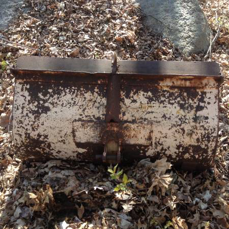

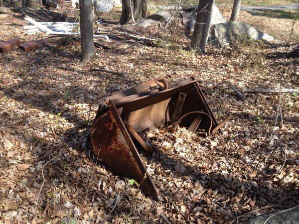

Hey Patrick! Yep, we are back, well rested, and ready to rock! That was a much needed vacation! Maui was excellent, everyone is so nice and very laid back, coming back to upstate NY was like a culture shock, everyone should take notes on the island mentality- they'd all be happier!
Haven't done much with my machine lately, been busy preparing for the holidays and whatnot. I did pick up another bucket for my loader though, paid only $100 for it! My current bucket is only 42" wide, good for some things, terrible for most others. New bucket is the same width- plan is to cut about 18" off each side and weld those sections to mine (maintaining the integrity of my current bucket) and I'll end up with about 6.5" wide when done. That's a springtime project.
I have also been busy modifying an old Fisher(?) snow plow off a truck to fit the 3pt hitch on the tractor. I'll make a thread about that shortly too. I have no pics right now because winter is just around the corner and I'm in a bit of a time crunch. If it stops raining I'll hopefully have it done tomorrow, just need to weld a bit and it's done!
