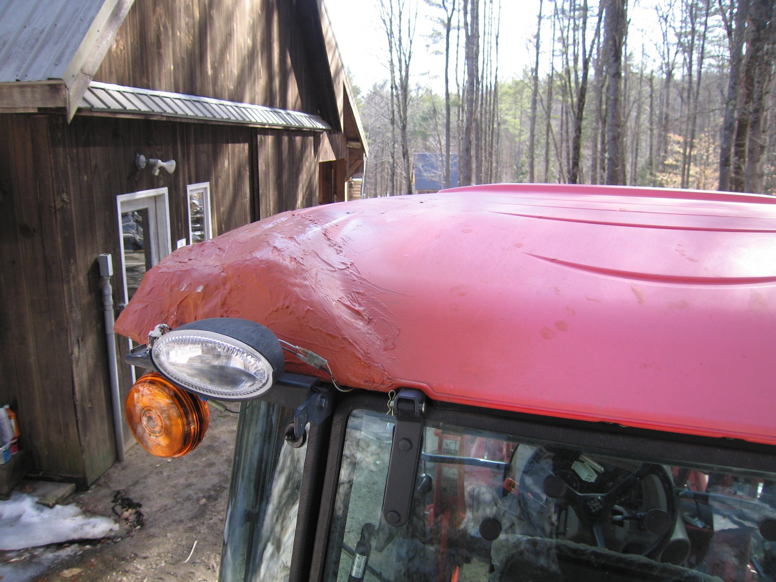

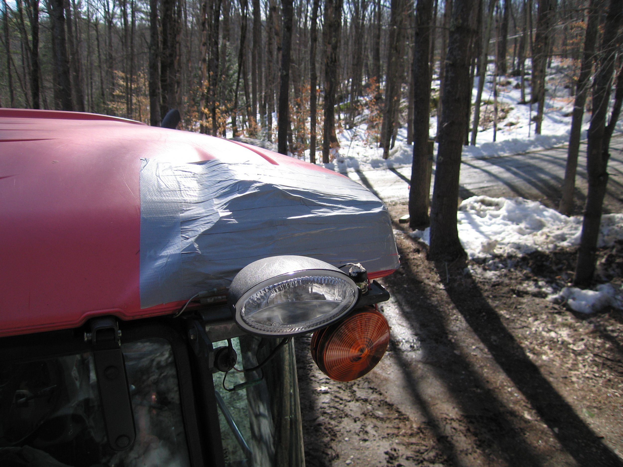

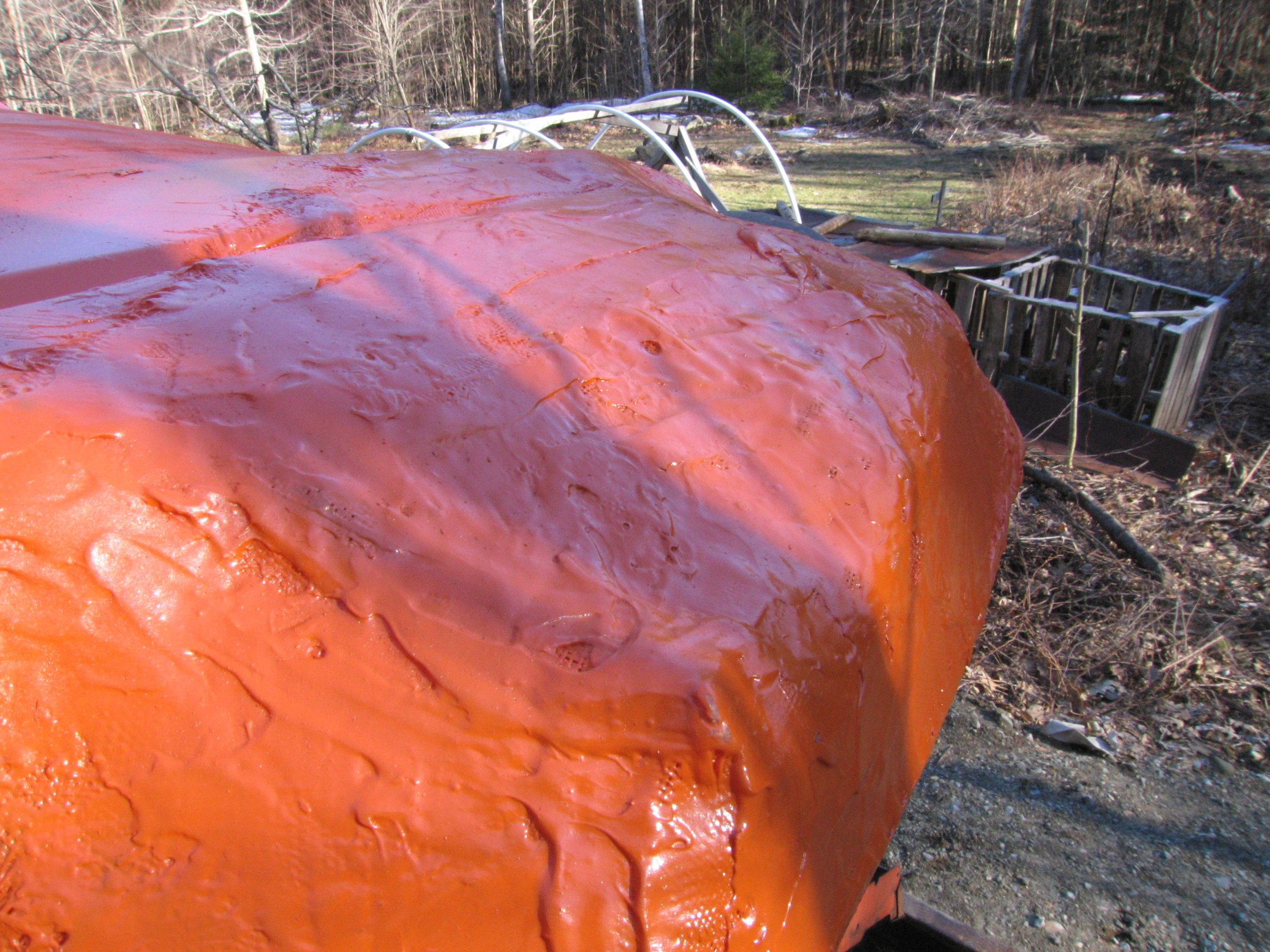

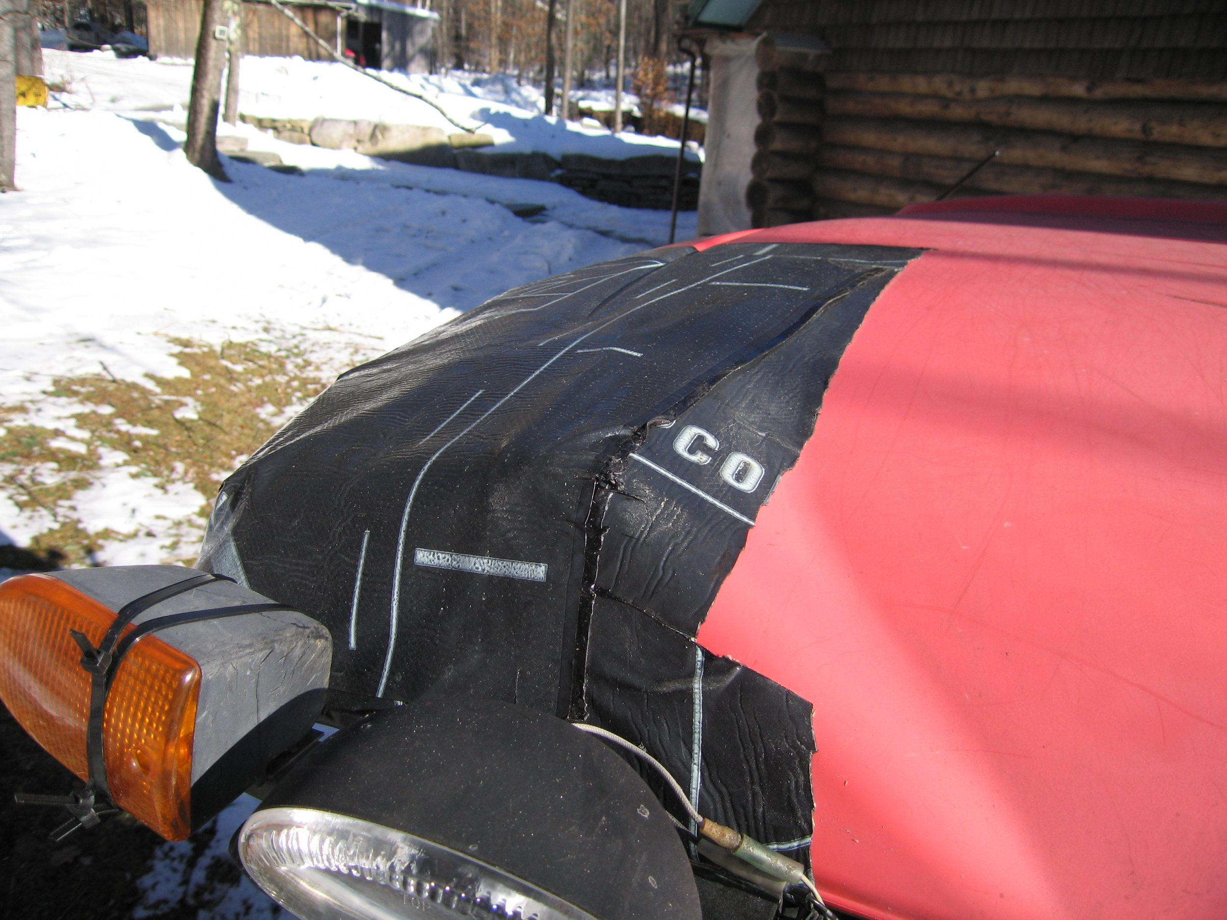

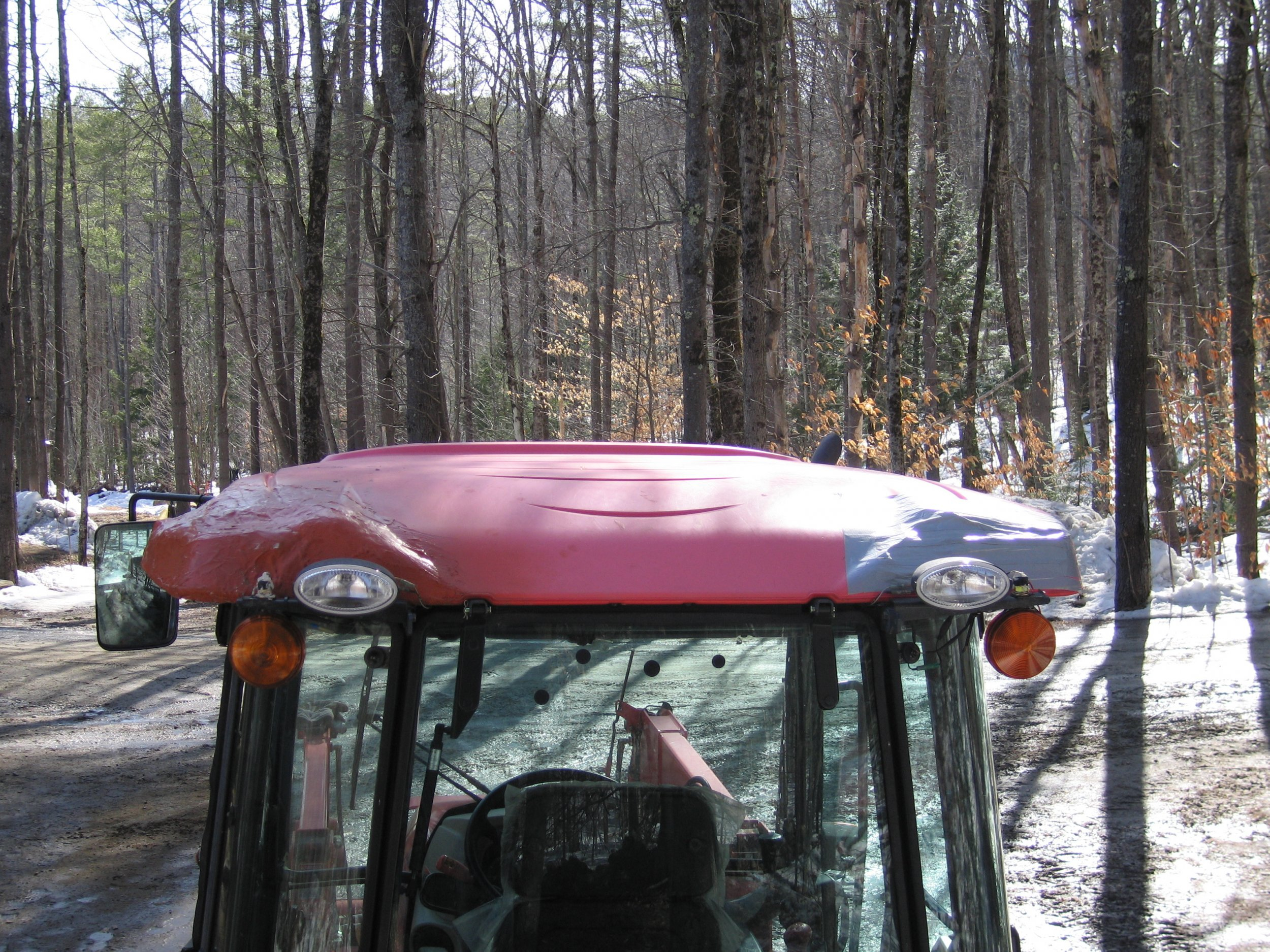

I smashed a huge ragged hole in the cab roof on my M and first just used bituthane roof sealant then later on used West system 2 part epoxy and fglas matt to make an ugly but serviceable repair. That was 3 years ago and I notice it is beginning to lift a little in spots. I have since punched a couple of more holes and just rednecked them with duct tape and aluminum tape:oops:
