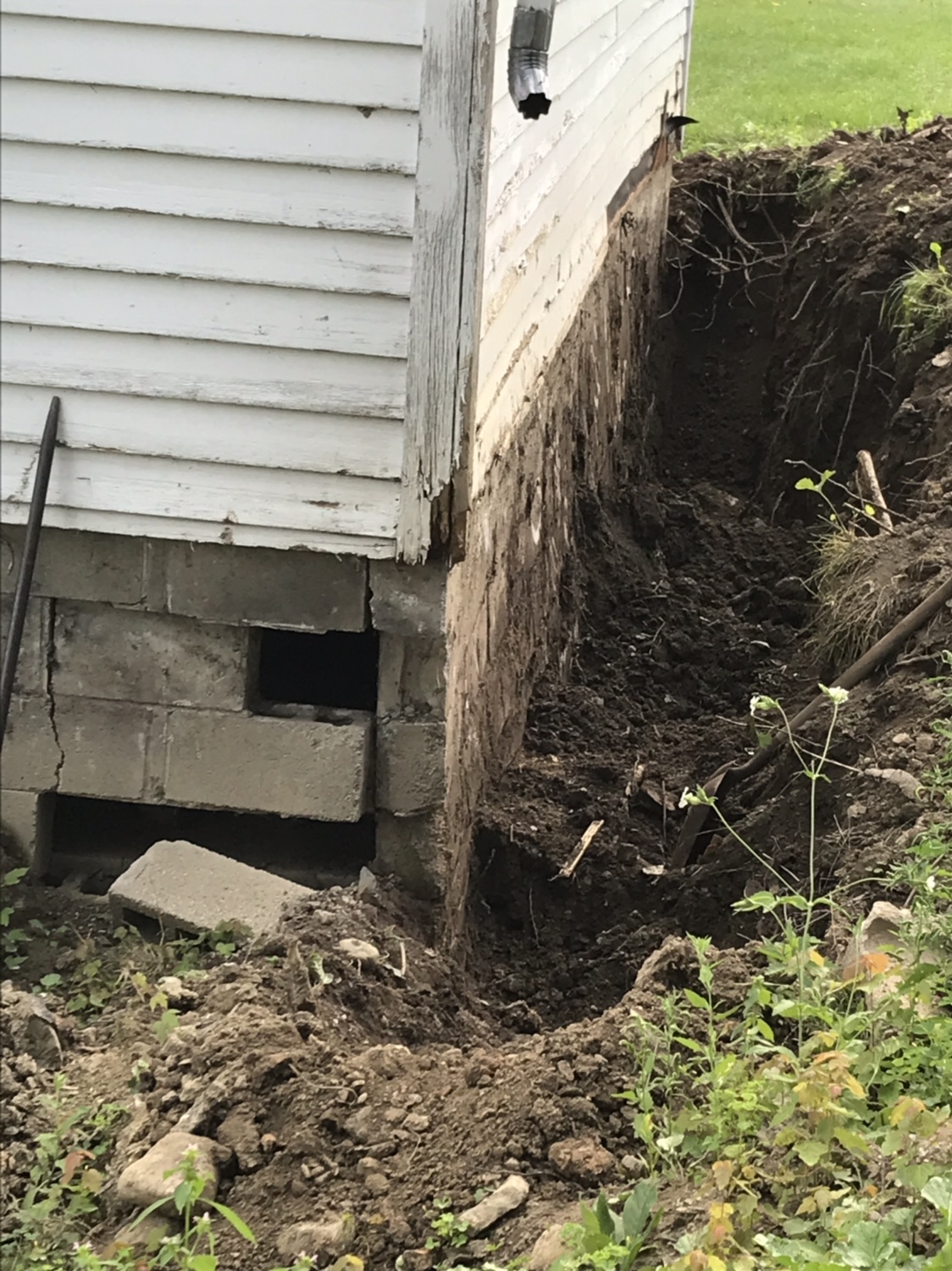

Between the rain showers I got a little more done on my garage foundation. Of course this has turned into a bigger job than planned.
Dug the bowing back wall out pushed back in place with tractor, pressure washed the wall off is where I’m at. Plan on a 4” perforated pipe and French drain next with a 60 mil membrane against the outside of the wall. IMG_0751.jpg

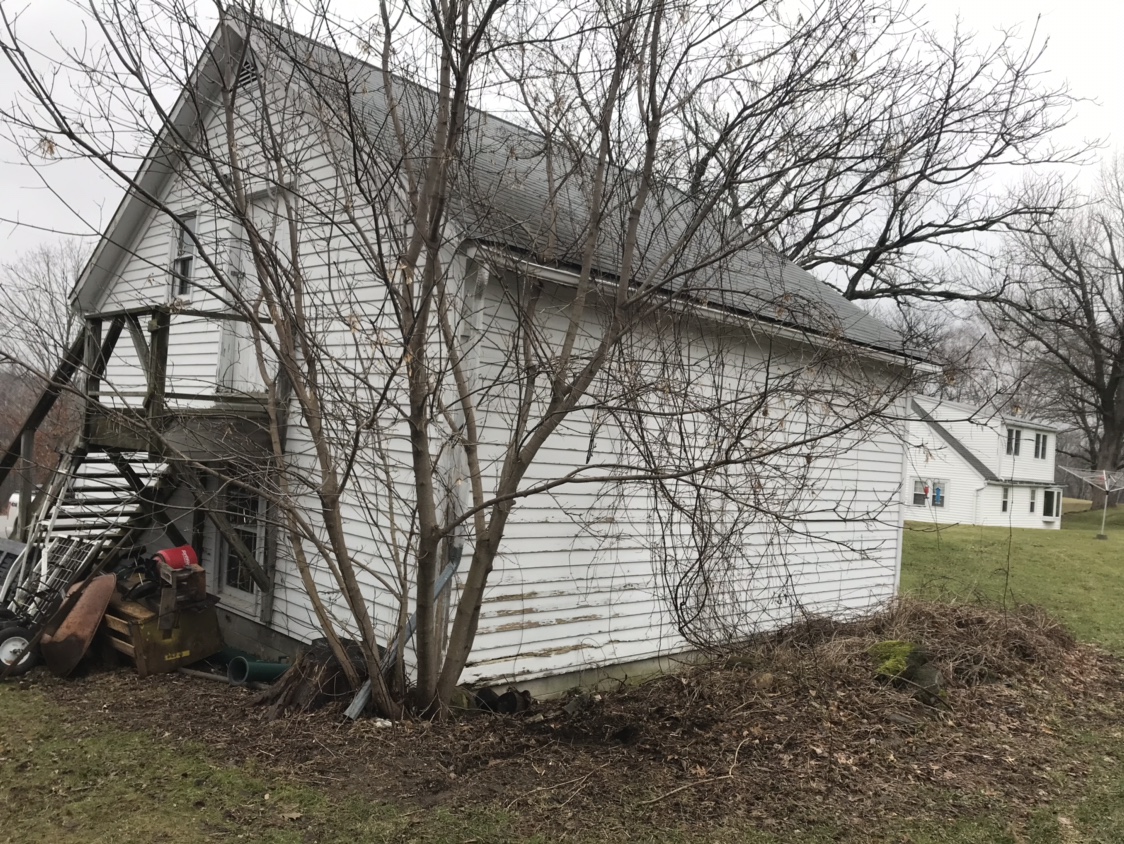

This all started from a tree allowed to grow next to the foundation in the past by previous owner.IMG_0142.jpg

From the one picture consider getting underneath and checking all the floor components for rot.
The floor is slab there at the bottom of the hole in the concrete. It and the sill plate on top op the blocks appear and n good shape the wooden siding bottom courses are rotted but I am going to replace that as the build the 30x40 addition. This area is getting a leanto for implement parking so I want to fix this mess before I build that over it.

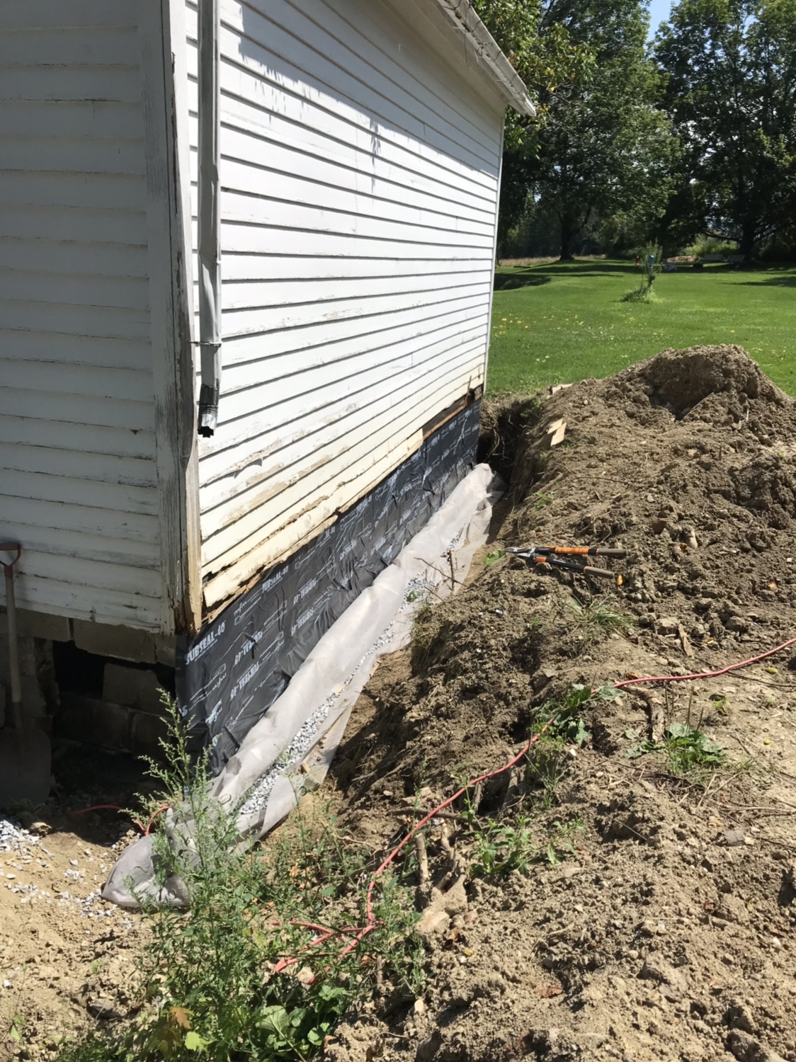

Patched the holes and bad places in the outer wall with concrete mix and cement.

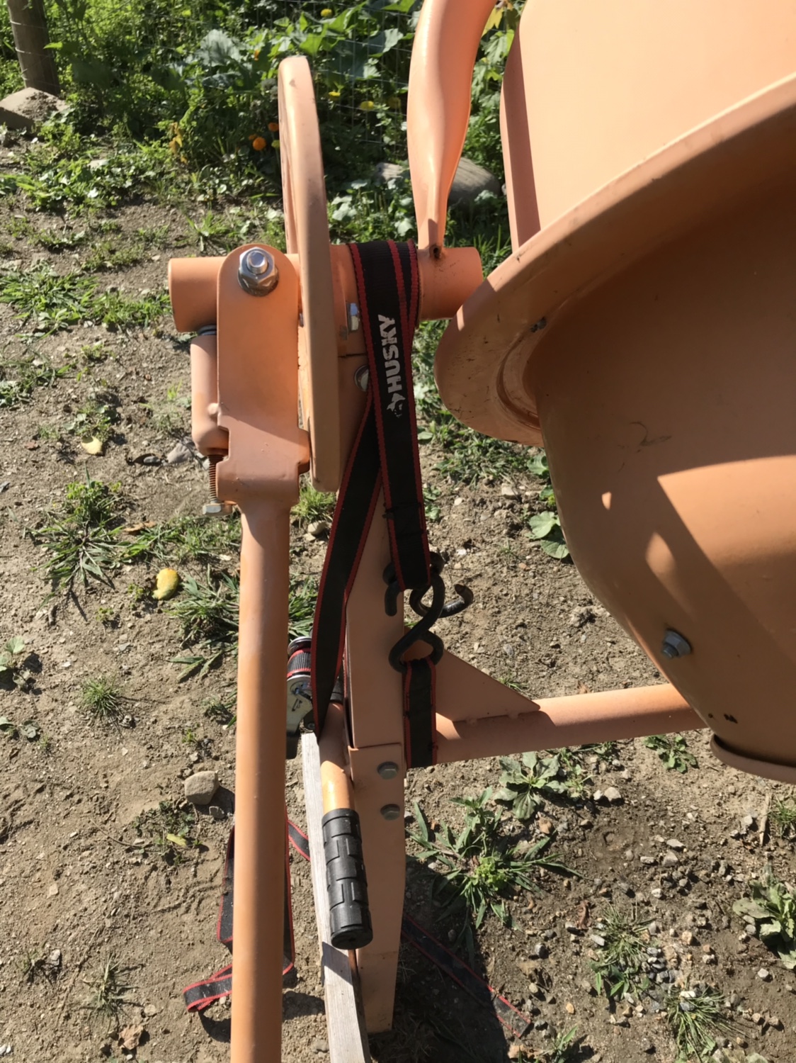

Had the first aww man... after the HF mixer tried to fall over on me. IMG_0789.jpgLooking at the certified repair you can see a bolt head sticking out slightly. (By the U in Husky).
The inner tubing broke in half around the bolt holes and when I went to dump a full tub, it pulled out dumping everything on me, the bucket, and ground.

Got the membrane on. HINT don’t be stubborn like me. Get somebody to help you roll and stick this. I caught h3ll on this by myself.IMG_0791.jpg

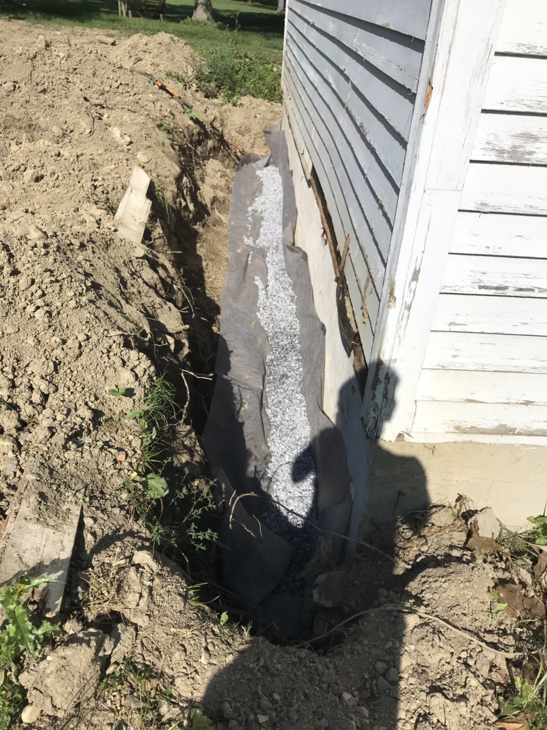

Laid about 6-8” gravel, then 4” perf pipe wrapped in landscape fabric. IMG_0788.jpgIMG_0791.jpg

Here’s a question. Should I fill the whole trench with gravel back up to grade or start covering it back with dirt?
This will be a gravel floored lean to eventually with gutters so water should hopefully not be a problem going forward.
