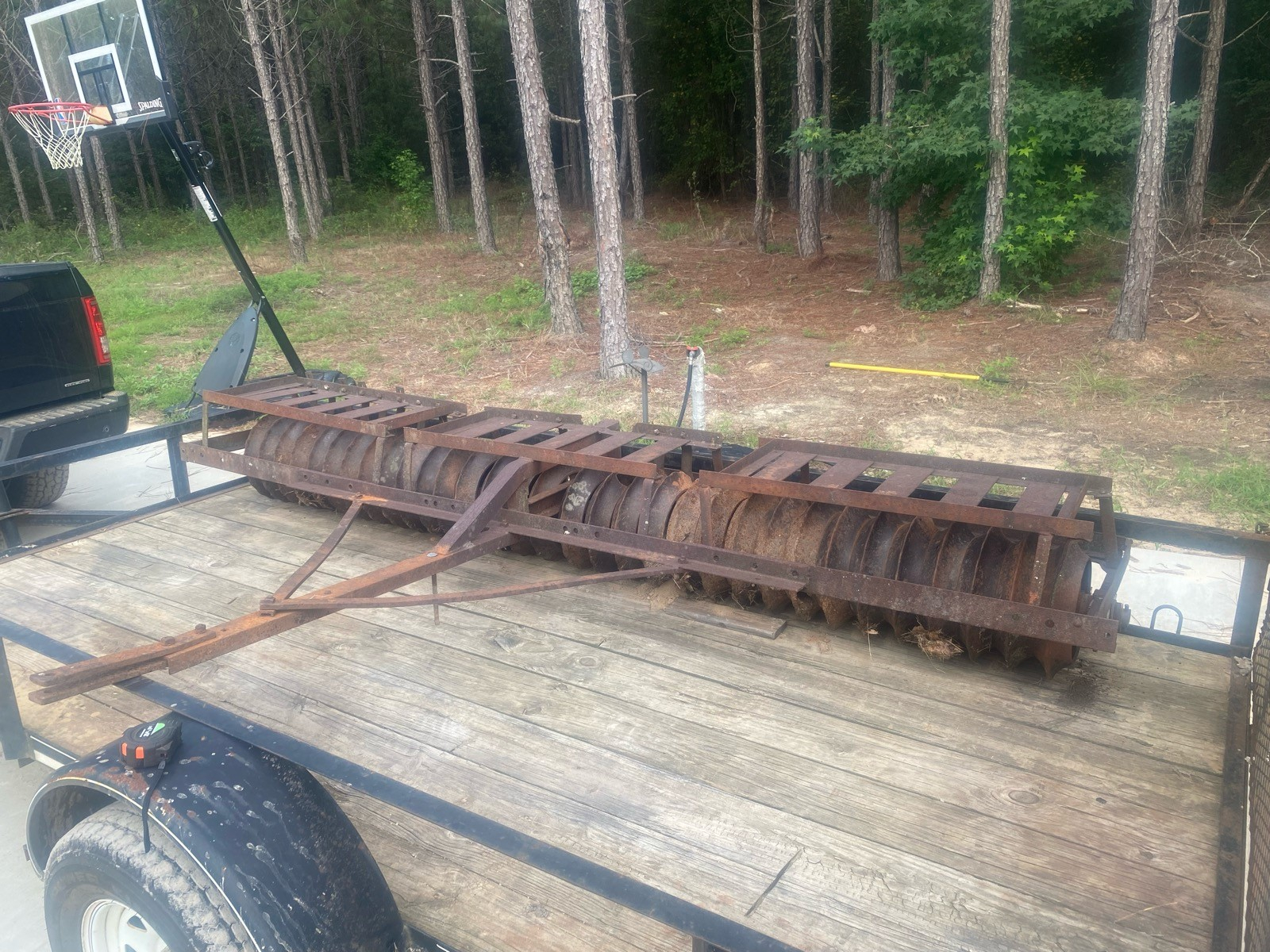

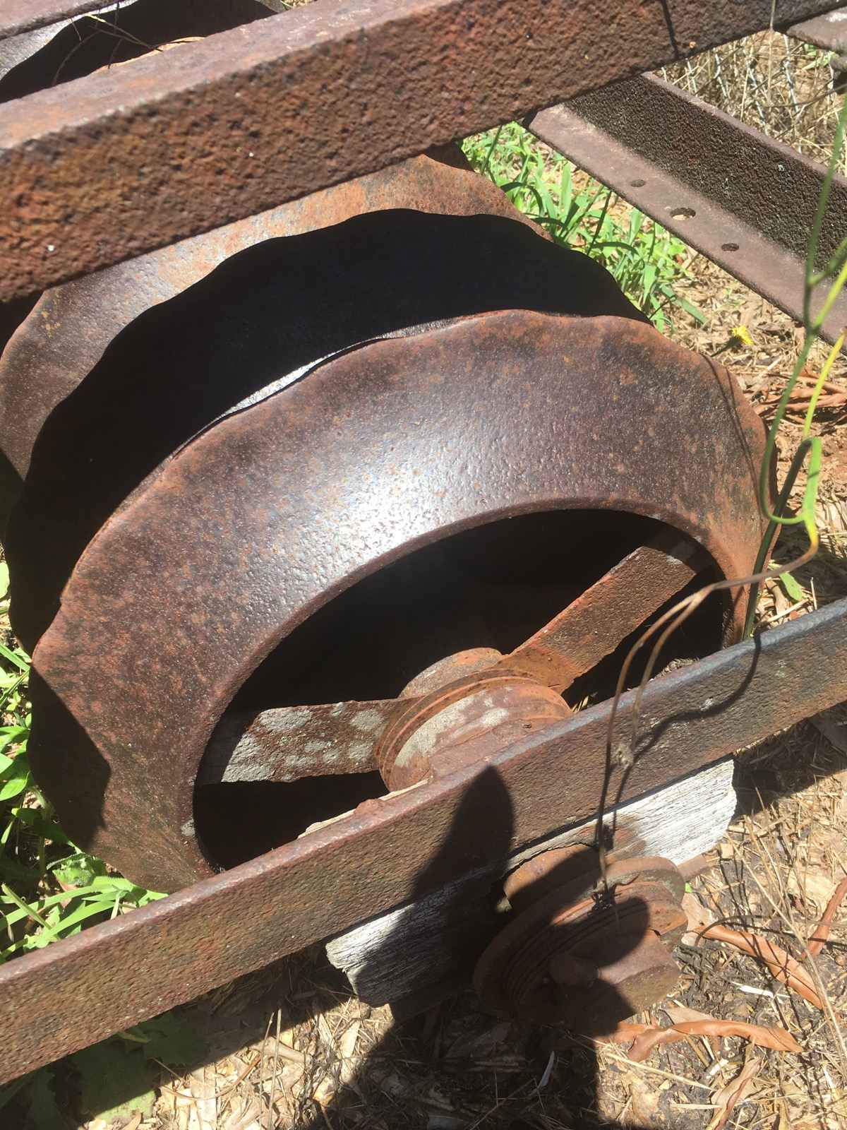

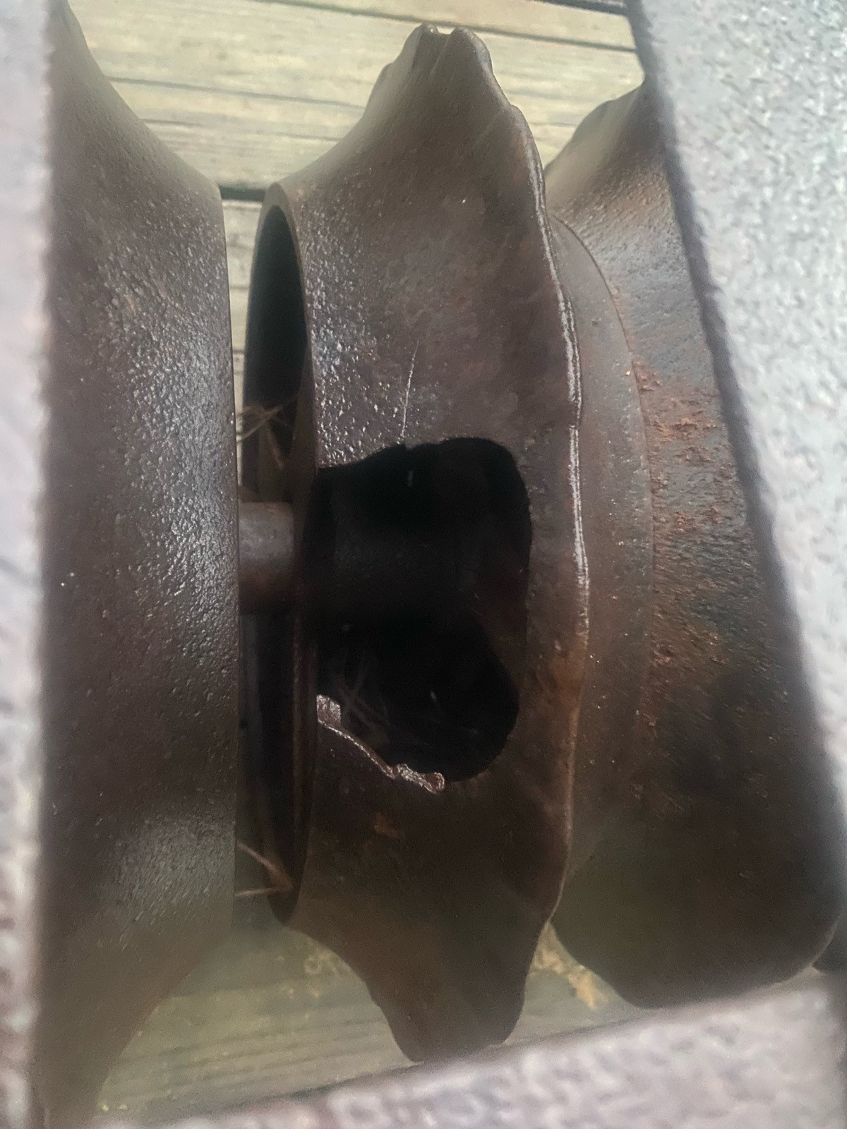

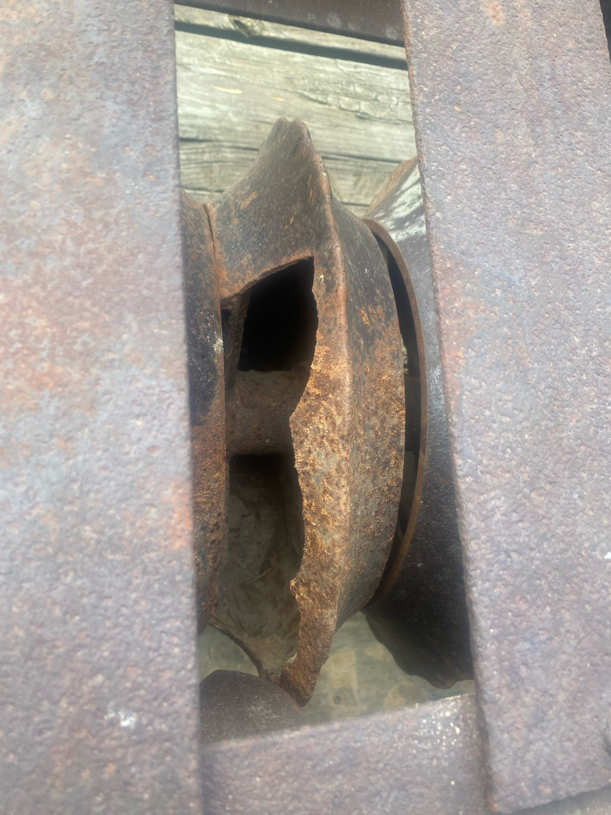

I recently bought this 10ft cultipacker. I got it for $600, made a good little drive to pick it up only to find out 4 of the 32 wheels are damaged. There is 1 other wheel that is damaged but it is very minor. I am debating on whether to take these wheels off completely, or try and find somebody that can patch/repair these wheels. I would really prefer to keep it 10ft and have them repaired. I am also going to be adding some rear tires on the back of the packer to transport,,,especially after seeing the damaged wheels. There's no way I want to transport it like it is. My question is how feasible is it to get these wheels repaired? And has anyone repaired cast iron before? I was hoping some 1/8" or possible 1/4" flat bar or something cut out of plate could be welded on there. Would certainly not need to be perfect, but something to cover up the hole and keep from having further damage. It has wooden bearings, which I will replace with pillowblock bearings.

The holes would be easily welded closed using steel to fill the holes.
Even a novice welder could do a nice job of repair of the wheels.
If you do not weld, this may be the perfect opportunity to learn,,
a success is the best way to learn, this would 99% chance be successful welding.

Welding cast is not as simple as it was made to sound. A good weld shop can do it, but it is involved. It requires pre-heating the cast and depending on the metal in the cast special welding wire/rods. As I understand most shops put the pieces in a forge to evenly heat.
Good Luck with it. Again a welding shop can handle it, but as a once in a while welder m, personally, I would not spend my time on it! I would find a shop.

I've done it, it not only has to be pre-heated, it has to be cooled at a sloooow rate, so like you said, not all that easy... Brazing is a bit easier though...
I don't know that I would bother fixing it in the first place...

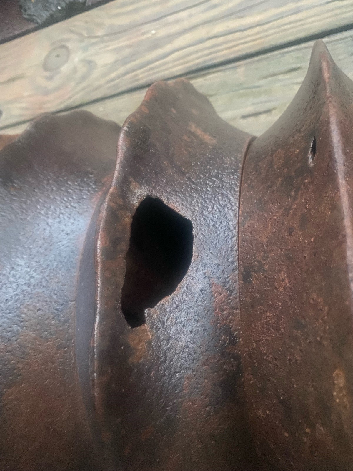

Here is a decent picture of the bearings. They are not solid at all. I originally planned on building my own Cultipacker and bought the bearings. Then when i bought this the seller would not acceot a return of the bearings.
I do mig weld but I am not that good, lol. I can get stuff to stick but this is out of my league.
If y’all recommend the wood bearings, should I stick with white oak? I do have some 1.5” white oak boards in the shop I save for building tables with.

Last set of wood bearings I made, They needed to be out of thicker than 1-1/2" boards...

I would discard the broken wheels, and make up a couple of spacers from steel pipe to take up the missing length. You only have a few busted wheels and a slightly narrower unit will do a better job of compaction.
I did a similar thing with an old 8 footer. Now it has a 7 ft width and works perfectly behind my 6 ft, 2 section drag. I made new wood bearings for it from pressure treated pine 4 x4's about 15 years ago. They have been working well on about 5 acres per year without any grease.
Last summer I saw another old 8 footer with bad bearings and a couple busted wheels about a mile down my road. I offered the widow $40 for it. When I have time, I am going to fix it up to leave at another property so I dont have to haul my other one back and forth.
As you have discovered, transporting them over the road cam be a pain. The 7 footers aren't too bad to carry with my bucket forks.

Those wheels may not be cast, they may be forged which is easily welded. Next, if you have a mig machine you can totally repair those yourself using silicon bronze wire. If you had an arc machine I’d find some 55% nickel rod
Grind each weld clean , pre heat in your kitchen oven or on a propane burner. You don’t need to make perfect fitting pieces you can either build it up with filler rod or chunks of steel then grind back down to shape
Cool down needs to be slow by burying it in a bucket of warm sand or putting it back on the heat source and reducing heat slowly.

I also think they are made of some alloy, and not totally cast iron. could be malable cast which is way different and you might be able to cut some patches and get them to stick for no more than you are going to be using it for. Now IF you were going to use it for serious work----then it needs to be pro- fixed.

I'm not sure about the basic alloy of the wheel, but not sure that it matters since we can see from the damage & holes that it appears a malleable alloy. My preference for this type job is the oxy/acetylene torch and that is what I would use for this job. That way I have pre-heat, post heat (if necessary) and braze/welding heat all available as needed.
Post heat is something I always do, but it isn't so critical with brazing as with welding. Just playing the torch over it as it cools should do it.
For the job I would definitely agree with high-nickel bronze brazing rod (much better than low fuming brass), I like a powder flux that can be applied as needed, and would make the patches of any type of mild steel.
It would surprise me if the repair didn't outlast the rest of the wheel. Why not try? What's to lose?

Make your new wood bearings out of hard maple aka sugar maple. Soak them in oil before installation. Hard maple bearings were used extensively in the early days for line shaft bearings, in water pumping windmills, all manner of farm equipment. Anything with heavy radial or shock loads.
