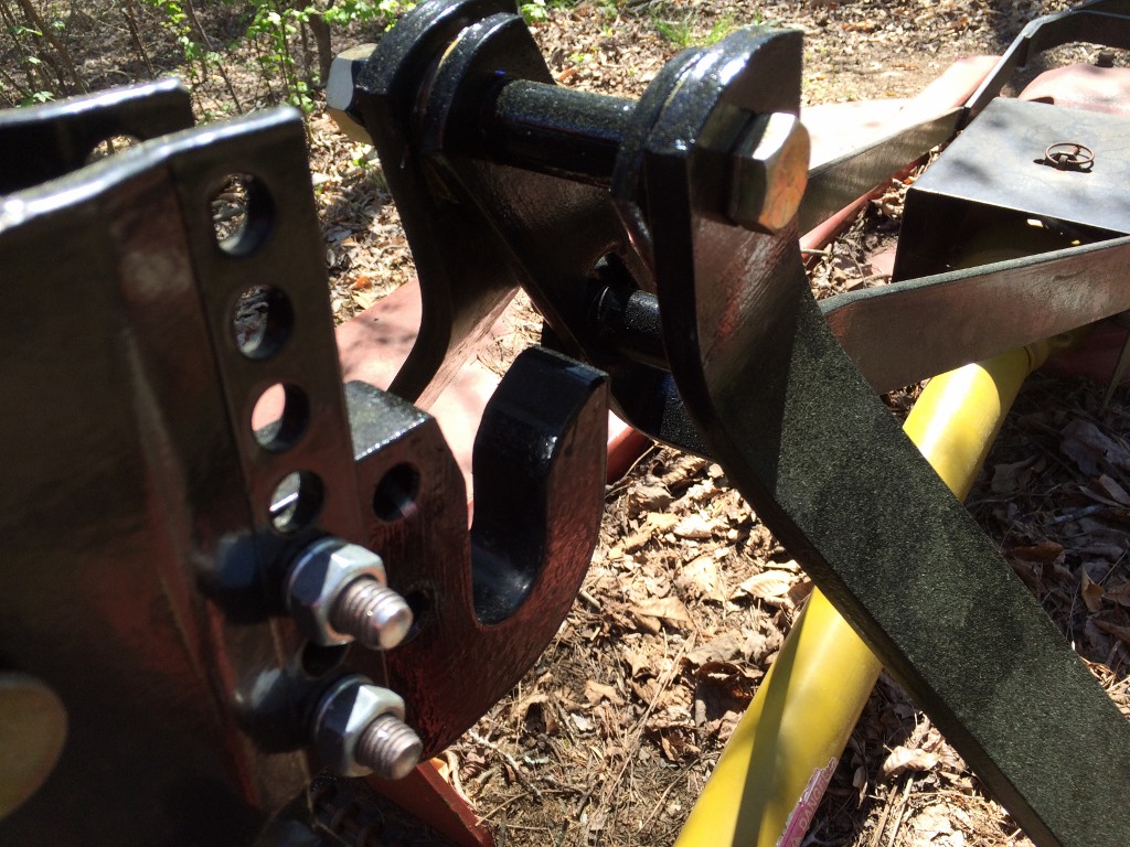

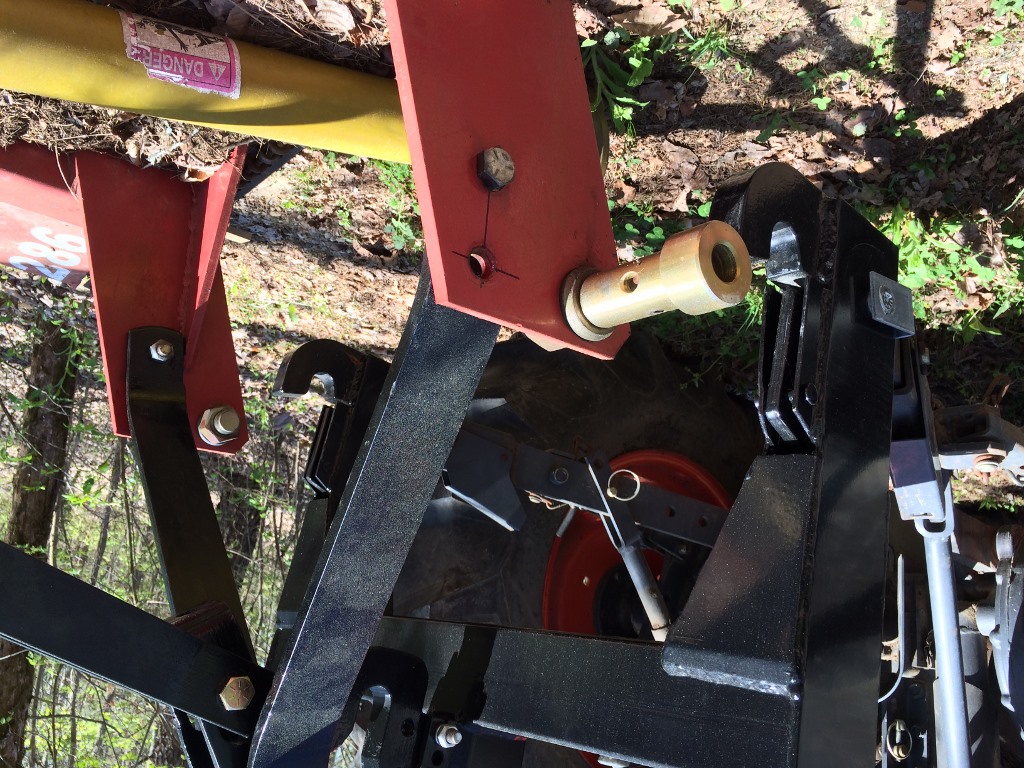

I modified my 286 to be QH compatible. Mostly just needed to drill a couple of new 7/8" holes for the uprights. Turned the "swivel" top link upside down and added a cat 1 to cat 2 bushing. I SHOULD have drilled the new upright holes about an inch farther back so that the uprights wouldn't interfere with the gussets. Also messed up my measurements and should have made them about 1" lower (future revision). I do have to pull the uprights toward the front a little when I go to hook up so that the top pin is easy to "hook".
