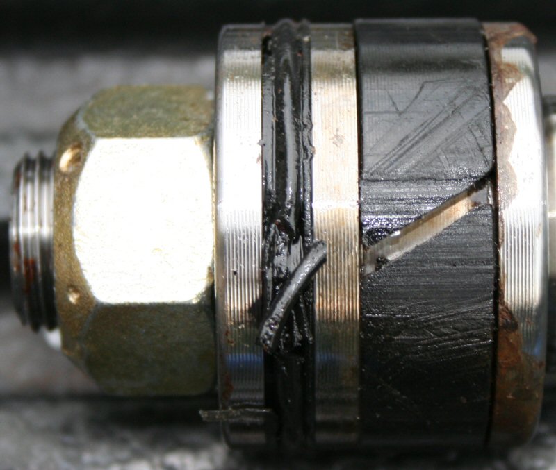

I got the wrench and it worked like a charm. I would guess it took somewhere between 100-150 lbs to get them loose. I didn't use a cheater and I didn't put all my weight on it.

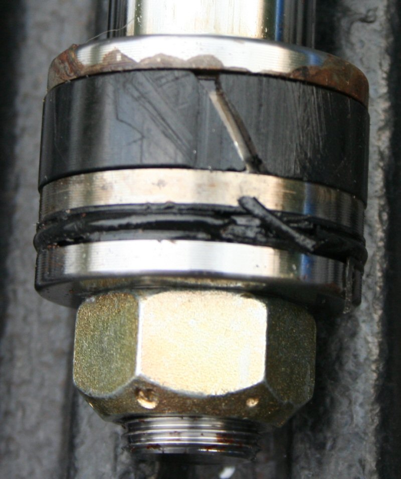

I have the cylinders apart and I'll probably put them back together tomorrow or Saturday. I have attached some pics of the broken seals. It's easy to see what the problem was. I think the small frayed seal in cylinder 2 was what was causing the initial slow leak down and the split larger seals in both cylinders are what happened this past weekend when the bucket would stay up at all.
One question I have is when I removed the caps, it looked like there was either some pipe thread sealer or some sort of Loctite on the threads. I don't have a picture of the cap threads, but the white stuff on the seals in one of the pictures is what I'm talking about. Does anyone know what this is? Do I need to put thread sealer or Loctite on the cap threads when I put it back together?

Glad you got it done. Looking at the pics, the seal scuffing is pretty extreme - have you checked for nicks and bumps in the cylinder? The chrome is also spalling and kind-of looks consistent with hitting the cylinder walls. The other possible cause of the destruction could be re-assembly - if there is a sharp ridge at the top of the cylinder. My bigger cylinders had a "liner" which had a very sharp top edge (sharp enough to shave a finger nail). I relieved the lip with a bit of wet-n-dry (and flushed it clear, upside down, with WD-40 after).

I noticed some rust on top side of piston check the bore of your cyl for damage for any pits in there. Pits will chew up piston seal (which is what you show in picture) maybe some water got in to cyl from bad rod seal (the one in the cap) and caused damage there?
usually there is an o-ring on cap before threads to seal the cap to cylinder I usually put a LITTLE nevercease on threads.

I'm pretty sure the scuff marks on the flat rings happened when I pulled them past the threads in the cylinders. I didn't take any precautions to not damage the seals because I am replacing them all. I did peek in the cylinders and didn't see any damage, but I am going to look closer before I put them back together.
I noticed the rust and wondered how something rusted in a bath of oil especially since I haven't operated it in the rain and it is stored inside. My guess is it's from the dealer as I'm sure it sat outiside for weeks if not months before I purchased it.
As I said, I'm going to take a closer look in the cylinders before I put everything back together. I'm also going to hit the rust with a scuff pad just to make sure it isn't causing any damage. I really don't think there is any problems in the cylinders because I know I was doing something I shouldn't have been doing when the initial slow leak down started and I was doing something else I shouldn't have been doing this past weekend when the seals gave way for good.

Ok I am confused. I know I have said this before in this post. Why are you so certain you did something wrong that caused this. I know people who do the same thing you describe in land that is very very very rocky. They dont have problems with buckets leaking down on new tractors. I have 50 hours on my montana over half of which is doing exactly what you are describing. I back with my bucket curled down and the front tires lifted off of the ground. If I hit a place where all 4 wheels start spinning I take some pressure off of the bucket. I have not had a problem with mine yet. I know people with other tractors that have been doing that for years with no problems.

Hmmm, I looked at the pictures. The thing that is cut at a 45 degree angle is a wear ring that keeps the metal piston from rubbing on the inside of the cylinder. It is split so that it can expand as it wears. All of the sealing is done by the thin stuff down by the nut. Be nice to that when you are putting it together ....
For me, it isn't an issue of simply pushing/dragging with the bucket curled down and slowly stopping because I had too big of a bite. In my case, I had the bucket curled down, moving forward at about half a walking pace, and I hit rock that didn't move that almost stopped the tractor. The bucket edge then scraped over the rock and the bucket sprang back the other direction. I'm pretty sure that these small cylinders on small farm loaders aren't built to withstand that sort of shock. After that, the bucket started slowly leaking down.
Of course, I couldn't see inside the cylinder so I can't say for sure that this shock was the direct cause of the problem. It may have been the straw the broke the camels back so to speak. I don't really see anything in the cylinder, but it may be that something in the cylinder is wearing the seals over time which then allows a significant shock to go ahead and break through. Or it may have been any number of other things, but both times I've had this issue with my bucket leaking down, I can point to a single event after which the problem started.
I do have to put some stock in the fact that my owners manual specifically says not to back drag with the bucket curled down. I assume that also applies to pushing forward. I have read several other posts in which people have said their owners manuals for other manufacturers loaders say the same thing.
That may be. I thought is was to much of a coincidence that the splits in both rings were almost identical.

The operation was a complete success. The cylinders did need a little work which surprised me given how long I've had it and that I keep it inside. I used a fine brake cylinder honer to clean the inside of the cylinders and a scuff pad to clean the pistons.
I put the cylinders back on the loader this evening and ran it for a while to get all the air out. When I parked it, I raised the bucket off the ground about an inch and left it. The last time I checked, about an hour after I turned it off, everything was still where I left it.
All in all it wasn't too bad. I have $25 in tools, $27 in seal kits, and several hours of work invested. It's a little more money (assuming the warranty covered it), but a lot less time than it would've taken me to load the tractor, haul it to the dealer, wait two weeks, then pick it up and haul it back. The good news is, I believe now that I've done it once, the next time it happens, I can probably handle the whole operation in less than a couple hours.
BTW john_bud...the rings you said were supposed to be split, the new ones were split too. I didn't notice when I first looked in the package. The only difference was the new rings were split straight across and not at a 45 like the old ones.

On the rings - the 45 degree ones are thought to be higher quality. They can't wear a slot in the cylinder like straight split rings can. In 25-30 years you may have a problem (lol!)
I really didn't think about the difference in wear between a straight slot versus a diagonal slot. I wondered about the difference, but they came from New Holland so I figured they knew best. BTW, I was wrong about the price, the seal kits were $16.91 each so my total was just under $60. For that amount and considering this is the second time I've damaged the bucket cylinder seals, I'm going to go ahead and get two more kits so I have them in stock.
