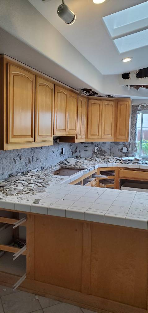

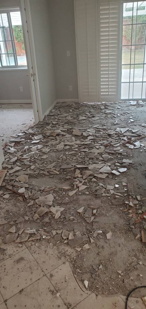

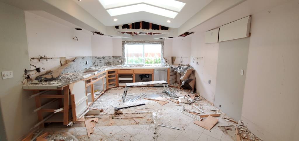

Day 2 demo... spent eight hours running a 20lb demo hammer and don't even know where I am at this point.
I knew going in that the entire kitchen backsplash and countertop was a full float... the best way to demo that is with a demo hammer. It shakes everything up and the tiles fall down. The counters are best to basically chop into sections and not try to break everything up. They'll be heavy but this is the easiest way I've found.
Kitchen cabinets were installed EXTREMELY well. Nearly impossible to remove without destroying as they were all screwed and glued together. So, sawzall was brought in for that.
Poked into the soffits above the cabinets to see how much trouble I was in for with electrical. As expected, one side is like grand central station and the other side is pretty empty. If I can i might just notch the studs, run the lines horizontal as they were, and cover with nail plates and move on. That is if it's too much to reroute everything.
Oh, here's a tip. When you're breaking up ceramic tile with a jackhammer, wear sleeves and a full face shield. We found pieces of tile flying up on to the second floor from the work being done on the first floor. Oh and I took a few shots in the face.

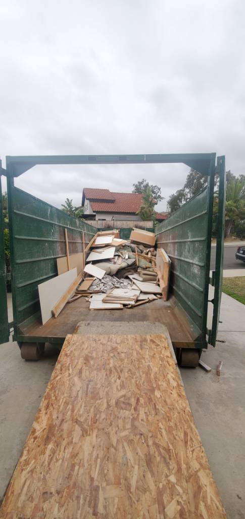

Dumpster filing up quickly.View attachment 670256View attachment 670258View attachment 670259View attachment 670260View attachment 670261
Oh thank god, I was worried you were gonna leave that floor tile. Kill it with fire!
