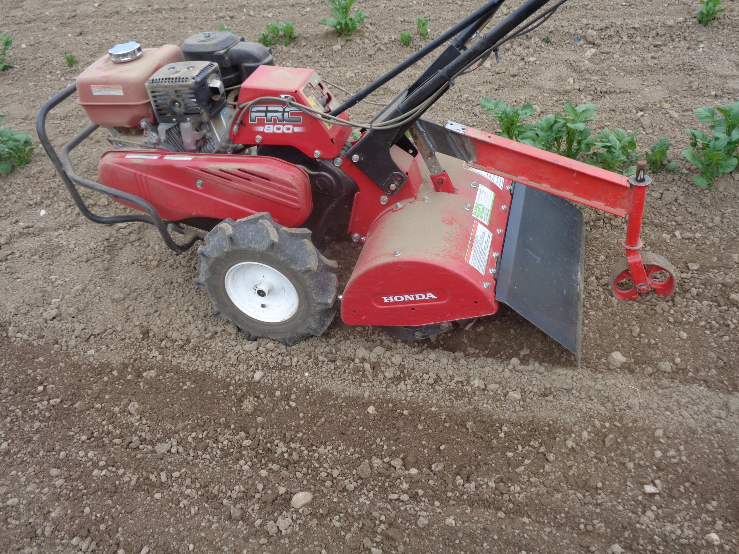

I also use a David Bradley walk behind tractor to cultivate my row crops, not use a walk behind tiller, at least most of the time. The only time I use my tiller, is when plants get too tall, or rows grow in, and get tooo narrow to use the D-B. But, I made a tail wheel for my tiller, and only till the top 2" of soil. Just deep enough to grubout most weeds, and leave them on top to dry and die. Any deeper, you're only bringing more weed seeds to the surface to germinate and grow. I originally built it to till through the leaf mulch, when I'd get weeds growing on top of the leaf mulch in wet years. Weed seeds came from some weeds that grew alongside the leaf pile, and deposited seeds in the leaves. Just wasn't proactive in keeping them mowed off, or sprayed. But, I've found the tail wheel works great for shallow tilling on bare dirt.
