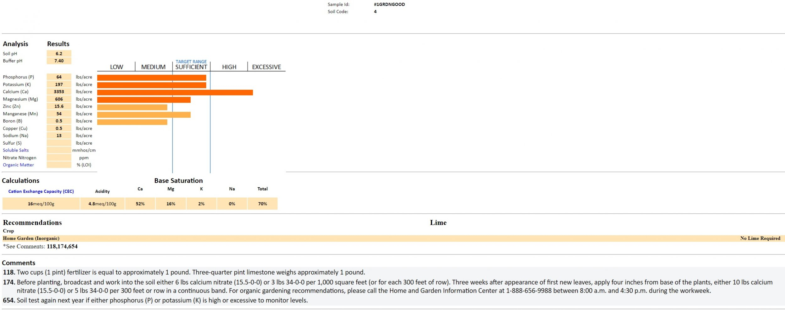

I did a couple soil tests on the garden. Good01 and Bad01. The Good01 was taken from a part of the garden that still actually does well, while the Bad01 was taken from a part of the garden that won't hardly grow anything well anymore. I plant corn or okra, for example, in a long row and it does great in the "good" part of garden and then the plants get smaller and smaller as the row approaches the "bad" part of the garden. The results of the soil test didn't appear that different to me, so not sure why the two areas perform so differently - unless I'm just not reading correctly.

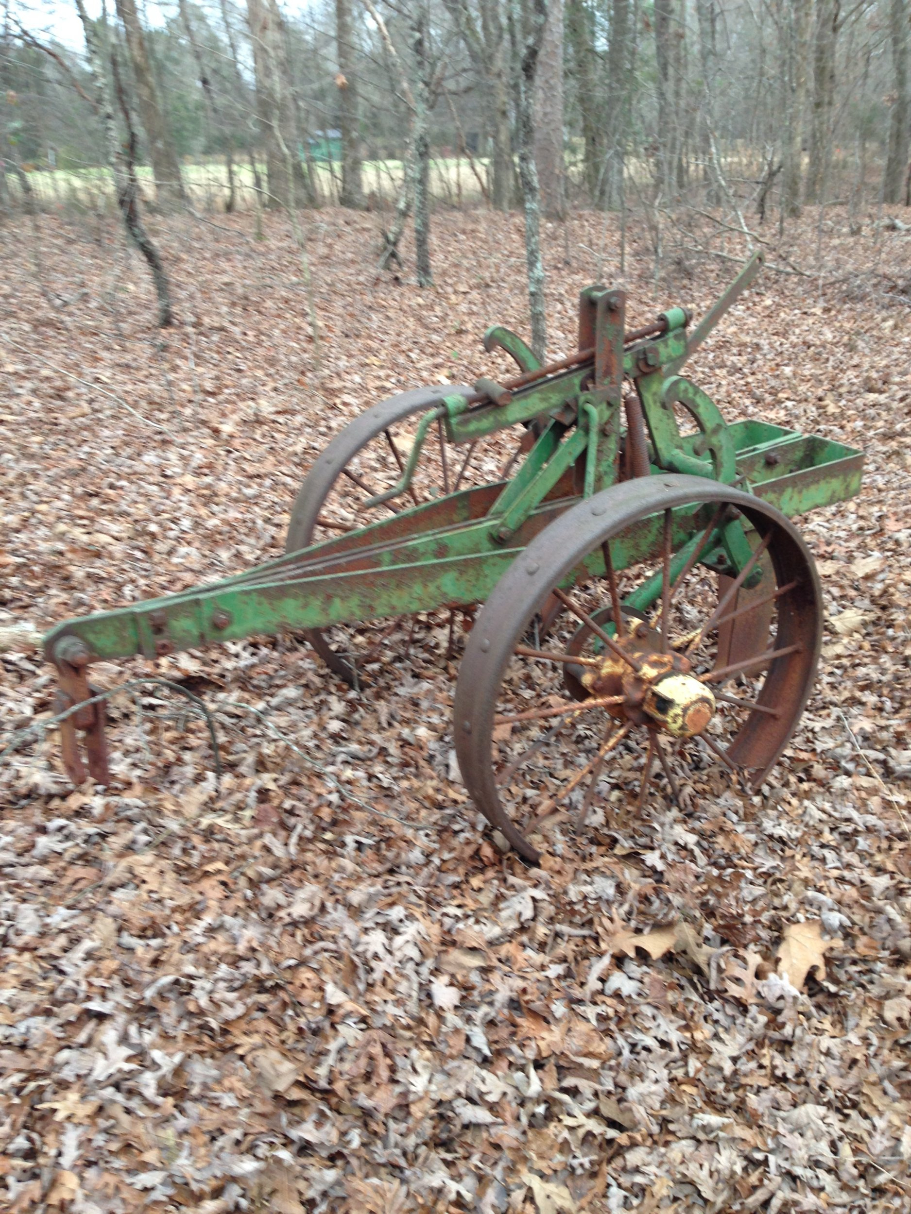

I have a really old John Deere subsoiler I inherited but have never used it. Not sure if and how well it would even work, and whether I might damage it trying, so am nervous about trying. Thoughts on whether this might work on back of my Kubota? I may also want to sell at some point - not sure how much of a market there is for this kind of thing.

Oooooh....... Ahhhhhh.....
" I don't have a subsoiler attachment, but I suppose I could buy/rent one".
Why were you fooling us?
Your implement is a subsoiler, which pins to your tractor's rear/center drawbar via the pictured front yoke. As this (gauge) wheel mounted subsoiler can articulate independently from the tractor, the subsoiler will maintain an even soil depth as the tractor passes over minor bumps and through minor swales.
The "controls" are to adjust subsoiler depth and to lift the foot free from the soil at the end of a row, when ready to turn about, then subsoil in the opposite direction. There is probably a shear-bolt in the mechanism somewhere. Your subsoiler controls may need a Blaster solvent soak to loosen rust, then greasing.
You are lucky to have this old-school, iron implement. Implement weight is an advantage in ground contact work. Your 4-WD tractor will pull it 'no sweat'.
Possibilities in random order:
1) Lack of nitrogen
2) Excess Calcium
Why does my soil have too much calcium?
Normally, the higher the calcium level, the greater the soil clay content. Recent limestone applications may result in higher calcium levels. If the soil pH is maintained in the recommended range for the crop grown, calcium deficiency is very unlikely.
Can you give vegetable plants too much calcium?
Too much calcium in your garden soil can go hand in hand with a high pH, which means the soil is too alkaline, which then affects the absorption of the macronutrients contained in other fertilizers. The way to determine whether you need to add calcium to your soil is a professional soil test.
What plants need a lot of calcium?
Calcium is essential for all plants, but the following are especially responsive: apples, broccoli, brussels sprouts, cabbage, carrots, cauliflower, celery, cherries, citrus, conifers, cotton, curcurbits, melons, grapes, legumes, lettuce, peaches, peanuts, pears, peppers, potatoes, tobacco, and tomatoes.
(( Corn and Okra are NOT on this list.))
3) Compacted soil limiting root growth.
4) Too much lime applied.
I am not an experienced farmer. I am an experienced gardener. Above results from Google searches.
