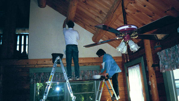

When we brought this place it had some of the world's ugliest wallpaper. The wallpaper was on the second story of a cathedral ceiling. We set up the ladders and scored the paper. Then we used the paste enzyme. Waited and then scraped. Very slow going and hard work.
My wife got fed up and brought a Wagner steamer for 50 bucks from Walmart. Well the steamer worked great. Much faster than the enzyme. But one BIG caveat. The enzyme actually destroys the glue. The steamer only softens it. So as we scraped the paper fell on the floor, ladders, the dogs, etc. Then it hardened back up and stuck fast. So we created twice as much work.
So use the steamer but be sure and use a dropcloth. Also when finished we washed the walls with enzyme to get rid of all the glue.

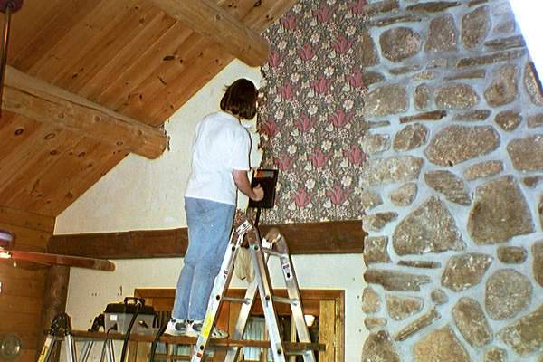

Whoops - wrong pic on above post. This one shows the acclaimed world's ugliest wallpaper.
