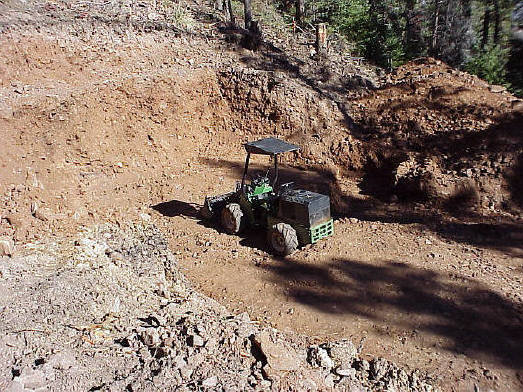

Here's why they call where we live the Rocky Mountains; if geologists are correct, this is what you area will look like in 80 to 100 million years.
But, given the average lifespan, it's probably OK to continue to pick up and dispose of the rocks.
Sure wish I could remember what soil looks like! /forums/images/graemlins/grin.gif
