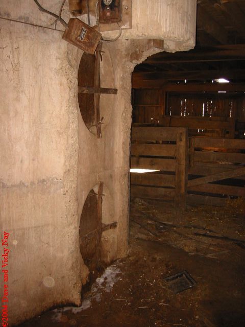

Here's a picture at the base of the silo. The old silage is up to a little above the level of the third hatchway, which is up inside the ladder/unloading chute.
There are also more pictures here. showing the series of unloading hatches, the whole base of the silo and the dangling equipment (which is undoubtedly the unloading auger).
Dave

What is the texture of the rotting silage? One of the pictures looks to me like an auger that may have been used to move the silage from a wagon into the silo. If so, there may be a farmer in the area that can help you clear it out. In this area most grain farmers use "portable" augers to load corn into dryers, bins, etc. If this could be done, you might could find a neighbor that could use some winter work who has the necessary equipment to move the silage. If it would work it would save a LOT of shoveling.

That piece of equipment hanging on that cable is a silo unloader.I used to install them but probably not that exact type. if it is operational that would be the easy way to get the silage out. otherwise take a 6 tine fork and get to work, then fork it up again into a wheelbarrow to get it out of the barn. Just spread it out in a field somewhere and let it go back into the soil.

I don't think it's at all operational. It's stuck in position, and all the electrical has been torn out.
