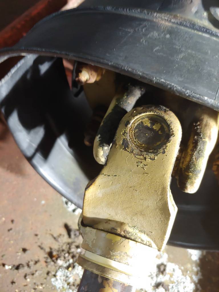

Hello,
New to tractors and this forum. I just purchased a 60s ish MF 135 from my father in law. It's the diesel version and runs great, just needs a little work.
He gave me a brush hog that needs a new PTO shaft. I'm trying to disconnect the yoke from the other yoke (correct me if my terms are wrong) that attaches to the slip clutch.
I've removed the 2 clips on the PTO shaft yoke. Do I need to remove clips on the inside, then hammer it out? All the videos I've seen use a vice or a press which does me no good since its attached to the gearbox. The gearbox and blades move easily for being outside for 10 years. I realize a new mower may be better, but I just want to cut once and then worry about it next year.
Appreciate any help.

I may be all wet, but I don't believe you want to disconnect one yoke from the other yoke. I assume the entire joint needs to come off the gearbox input shaft that we can't see under the plastic housing in your first picture.
Edit: On 2nd look, it looks like that universal joint connects to a slip clutch that then connects to the gearbox input shaft.
/ Removing PTO from bush hog
The shaft plastic is broken and slid down. So the metal part where both shafts meet was exposed to the elements for 10 years. Tried a bunch of PB blaster, chained it to a tree and reversed, and it will not budge. Its about 3" too long to hook up to the tractor PTO. Not sure if its bent, I didnt hit it too hard for fear of further damage.

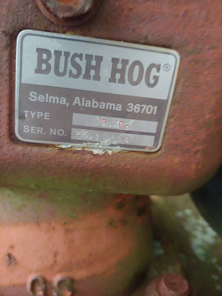

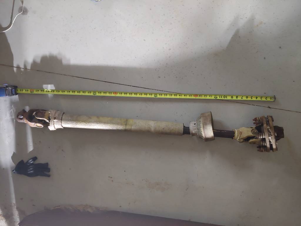

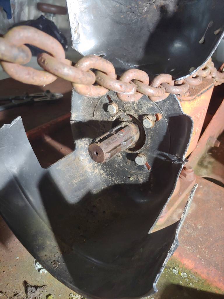

Here are some pictures. Everything look standard? Spline on both ends. Total shaft including clutch is about 50". Will order a new cover also.20190905_200307.jpg20190905_200100_HDR.jpg20190905_200057_HDR.jpg

Here are some pictures. Everything look standard? Spline on both ends. Total shaft including clutch is about 50". Will order a new cover also.View attachment 619998View attachment 619999View attachment 620000
Does the spline on the gearbox look just like the PTO shaft on the tractor? If so you can use a shaft with the spring loaded pin on each end. If not the challenge might be finding a shaft with the same type end you have on the clutch end of the shaft. The safety cover should come on a new shaft.
Gearbox spline would need the relief like the tractor PTO shaft to use the spring pins on both ends. You would need a 60" shaft minimum if that shaft is about the right length to connect as it's frozen. Connect the tractor to the bush hog and measure from spline to spline. Add the length of both splines and a foot or so to determine new shaft length.

Wasn't the problem that it was 3" too long? If so, free everything up, adjust the slip clutch and cut to the appropriate length. Or, spend $161 if you like.
/ Removing PTO from bush hog #18
The issue is it's frozen in place and he can't get it to free up. It's 3" too long as it sits but that is a moot point. If he could get the shaft free to slide it would easily slide in to the correct length. He said he tried chaining it to a tree and couldn't get it apart. Could be 10 years of rust has made it unrecoverable by any means.
If it were mine I would attempt to cut the plastic off, heat the tube with a torch, free up, and lube. In the process I would have ruined the temper of the metal and risked having the tube twist during use. Some folks don't have a torch or the inclination to do all that so a new unit would not only solve his problem but would also give him a new unfrozen clutch and a new safety sleeve.
