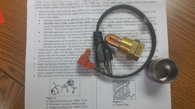

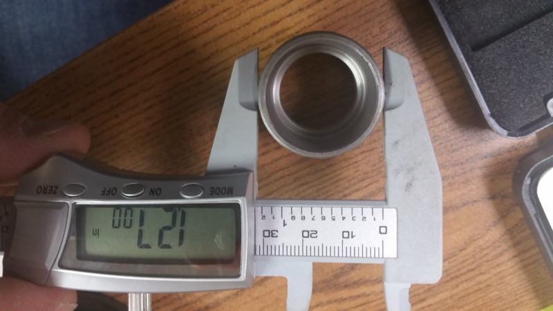

Here is a soft plug heater application I'm installing in a Kubota that is too shallow to allow an internal heating element. It uses a nipple that is installed in the bore providing room for the heating element. You might ask your dealer if this would work if the correct size is available.
Not finding any info on this part. What is it called or where did you get yours? I have a Yanmar 2210D that is too shallow for the block heater.
   / Removing Plug to Install a Block Heater - Need some ideas #27
I can't remember the part number. I ordered it from my kubota dealer. Its just called a block heater or soft plug heater.

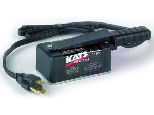

Scotty I feel your pain.... On my 2210d I don't have many options, so I use a 2 magnetic Kat heaters, one on the side of the block and one on the bottom of the oil pan. All last year that worked great for me. On my newly purchased 155d I had a heck of a time removing a plug just like you have. It was in tight location, ended up removing the oil filter, starter and air breather to get a wrench on it and still was tight due to the fuel lines. I had to put heat to the pug and block 6 different times before I finally got it out of there and I ended up rounding the edges a little too. Maybe get a lager flat jawed vice grip and use heat again to get it out of there, or use the Kat's heaters like I do on my 2210d.200-watt-magnetic.jpg
