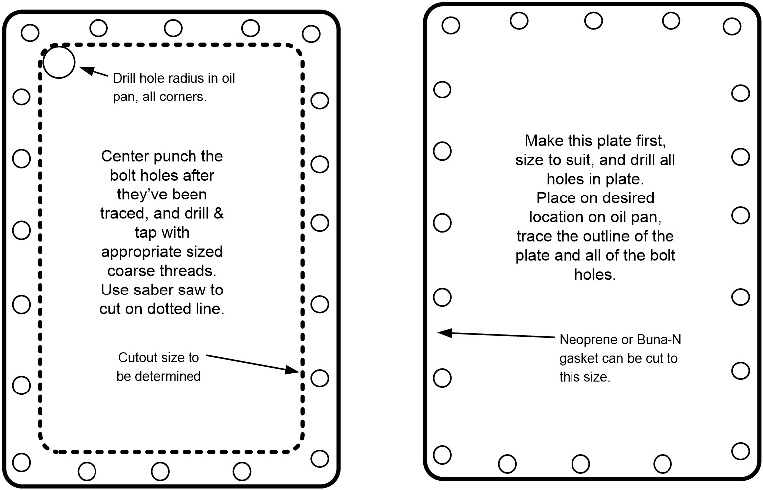

Wow, that's crazy. I'd be real tempted to cut a hole in the bottom of the pan and make a gasketed cover plate, providing I knew exactly where the pump was, and how it is mounted.

Yeah he said I didn’t need to put those 4 bolts back in and just to use rtv heavy there on reassembly . He said others have done this and it’s fine. It would be much easier if I didn’t have a loader attached . That has to be completely taken off .
   / Removing oil pan on a Y385 on a Agracat 2940 engine build date 1999. #14
In case you're interested in not splitting the tractor. The oil pan surface should be perfectly flat.
