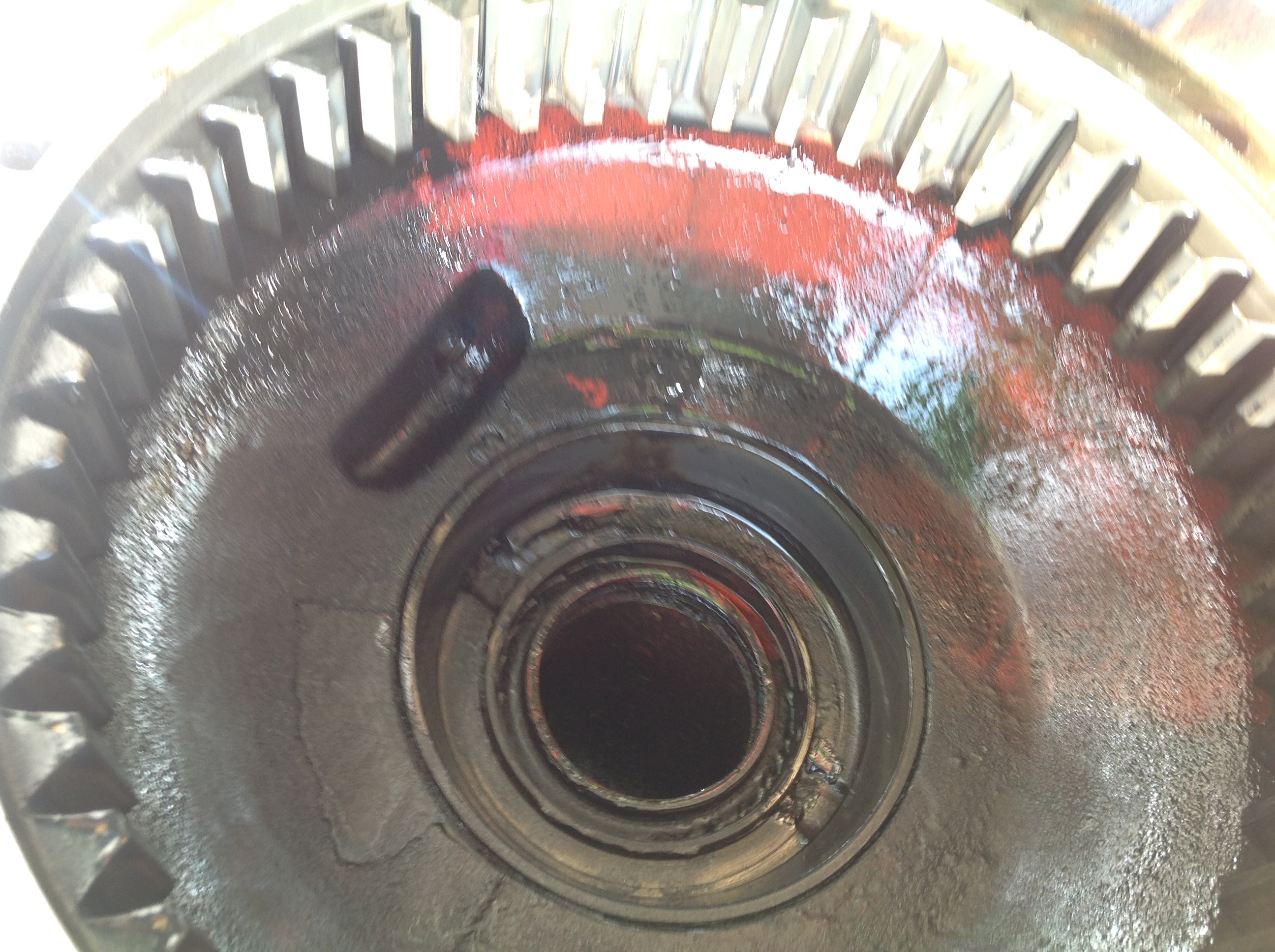

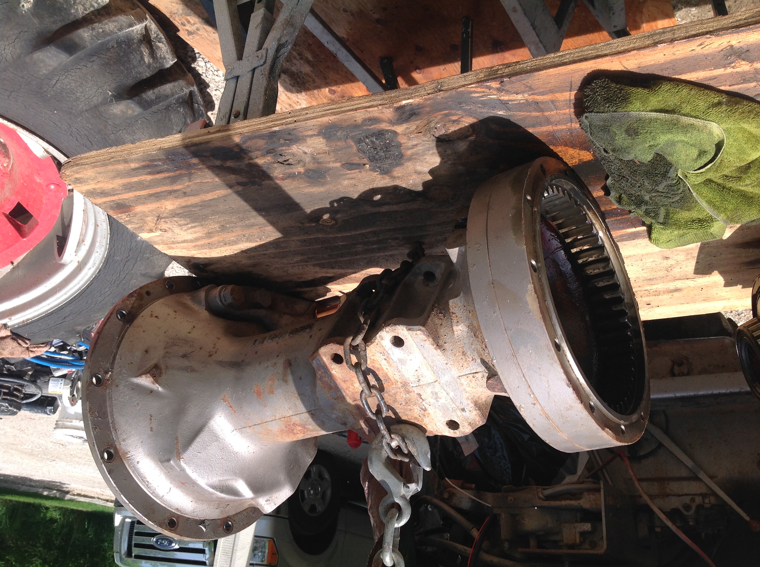

Jun 15, 2018 / Removing MF 165 Axle Seal #1 Robg165 New member Joined Jul 12, 2017 Messages 13 Location Komoka, Ontario Canada Tractor Massey Ferguson 165 Does anyone have any tips on removing the axle seal on a MF 165 or similar tractor? Attachments IMG_5185.JPG 1.5 MB · Views: 644 IMG_5186.JPG 1.8 MB · Views: 1,322

Jun 25, 2018 / Removing MF 165 Axle Seal Thread Starter #3 OP Robg165 New member Joined Jul 12, 2017 Messages 13 Location Komoka, Ontario Canada Tractor Massey Ferguson 165 Thank you for taking the time to post the info from the manual. It is much appreciated. I ended up using a slide hammer puller and it worked really well in removing the axle seal.
