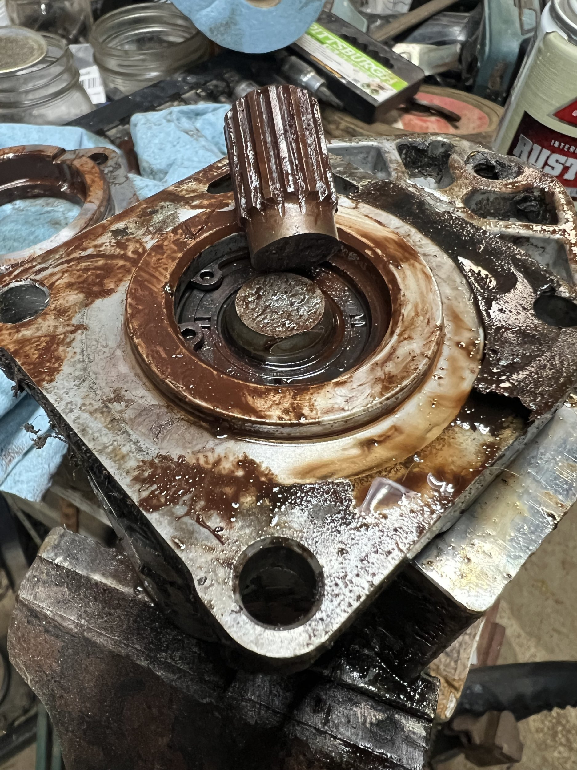

Well, this did not go as planned. The same situation as described. The hydraulic pump would only move back about 1/4 inch. The PS pump slid right off. I got some wedges and went to work. I eventually got it up to about 3/4 inch but that was it. There is a plate between the pump and housing, which was moving out with the pump. So I started working on the area between the plate and the pump. Quickly it separated explosively. When I saw the pump was off without the shaft I expected that I would have a long night in front of me chiseling the shaft out of the housing but nope it just slid out. This is absolutely not what I expected nor I have seen anything like this before. Yes, seen a broken shaft. Yes seen a stuck device with a shaft. I have just never seen anything like this.. its almost like the shaft was broken and the housing was what was stuck.
