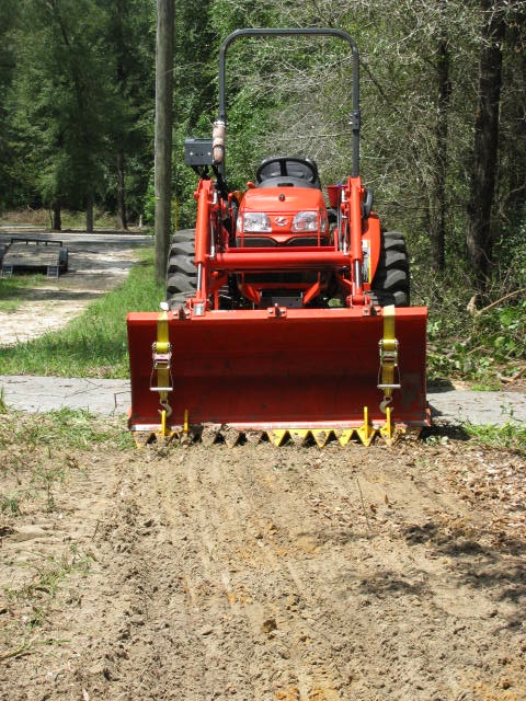

Anyone know if the rachetrake is better at removing heavy brush than the bolt on piranha toothbar? I like the idea of an edge that is bolted to the bucket rather than relying on straps.
BXpanded Piranha Toothbar
   / Removing Brush #22
You cannot dig with a Ratchet Rake. However, it has two rows of dissimilar spaced teeth which are used to grip brush. The lower teeth, which are used more for tearing out brush in reverse, are relatively close together. Metal is uniformly thick, not tapered.
Ratchet Rake is great at piling brush after it has been ripped out. Fine for minor grading and leveling.
Piranha has one row of SHARP teeth. Excellent for digging, especially on 48" buckets on light tractors. On wider buckets your minimum hole is as wide as your bucket. If you want to dig, buy the Piranha.
Focus on your task. As long as the attachment stays on the bucket you are good. I have used one Ratchet Rake for seven years on two tractors (1,600 engine hours) and thus far have broken off one tooth, easily welded back on, and replaced one of the wire ropes which go under the chin of the bucket. I have cleared acres and acres of Florida jungle with my Ratchet Rake on both a 2,600 pound and 3,700 pound bare weight tractors.

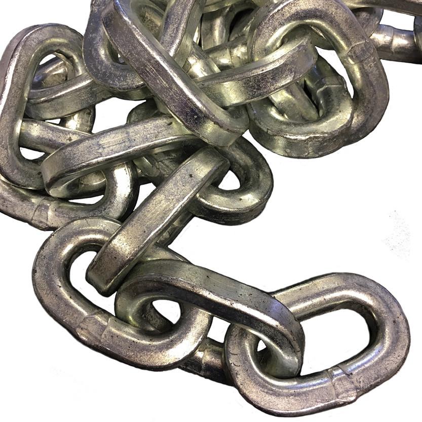

I've been looking for a piece of square security chain to try, but new is too expensive and yard sales and 2nd hand stores haven't had any. I suspect it will slip less than conventional chain.
