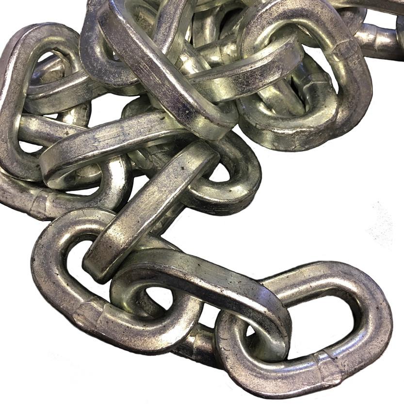

I've been looking for a piece of square security chain to try, but new is too expensive and yard sales and 2nd hand stores haven't had any. I suspect it will slip less than conventional chain.
