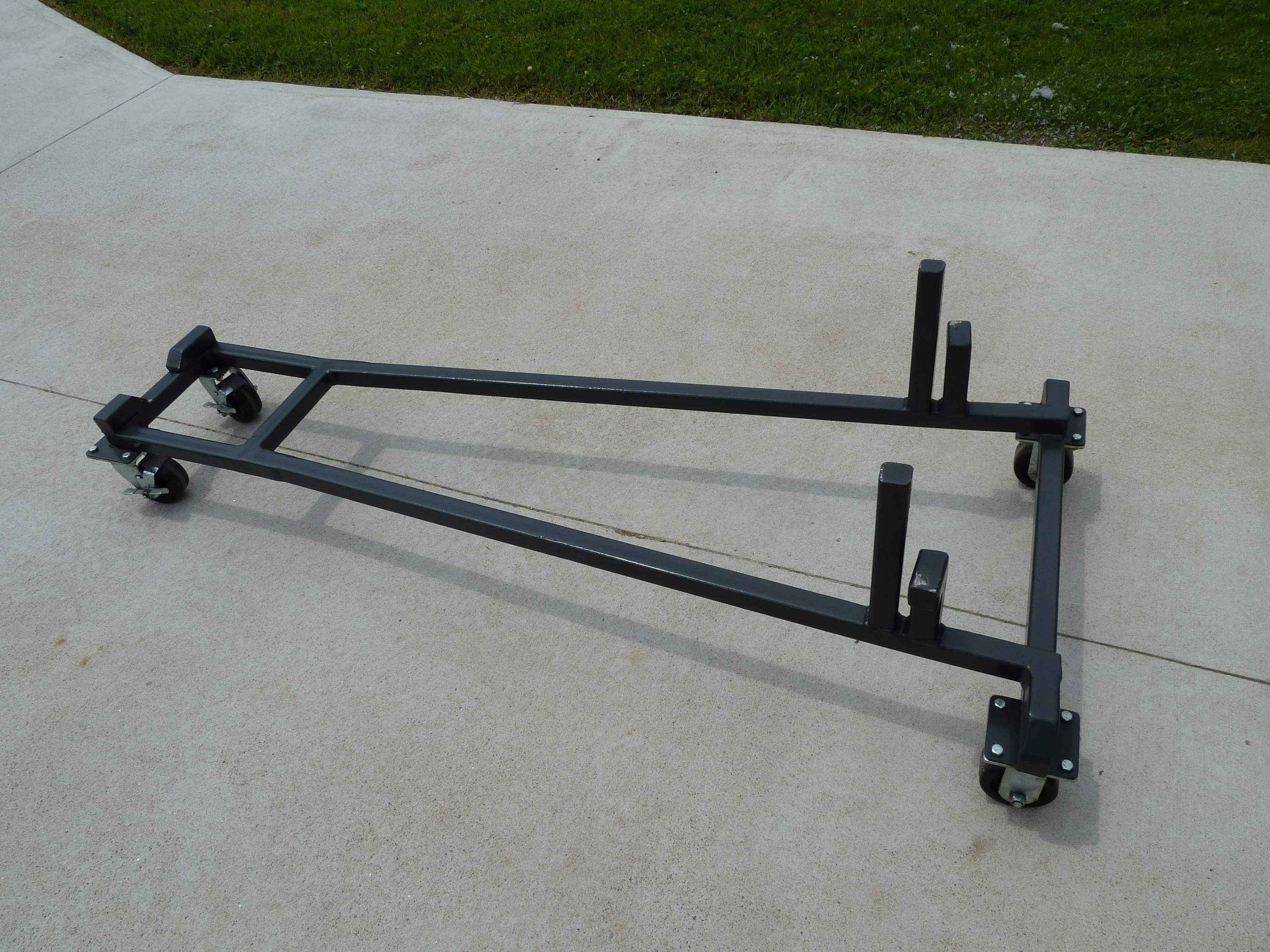

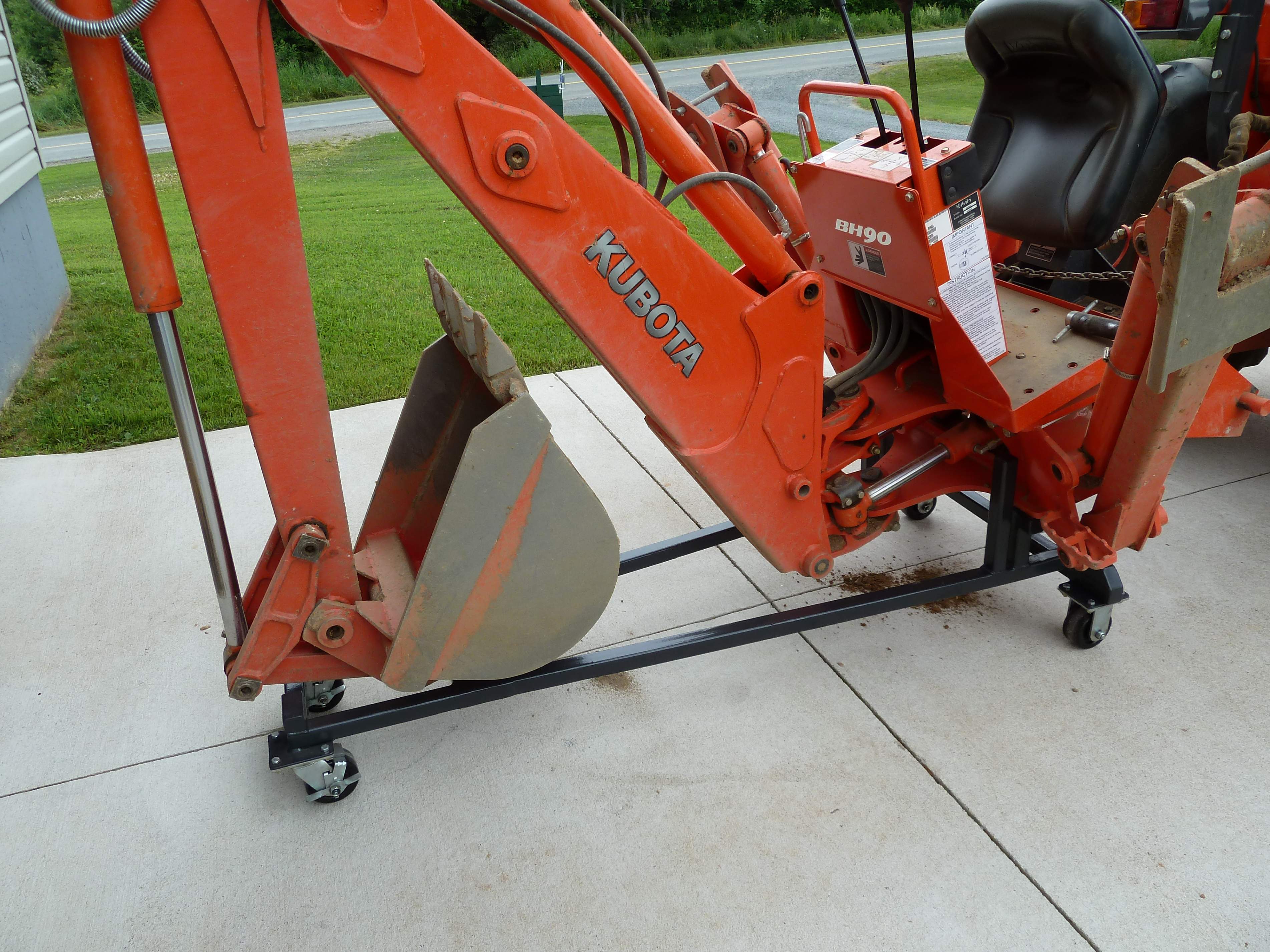

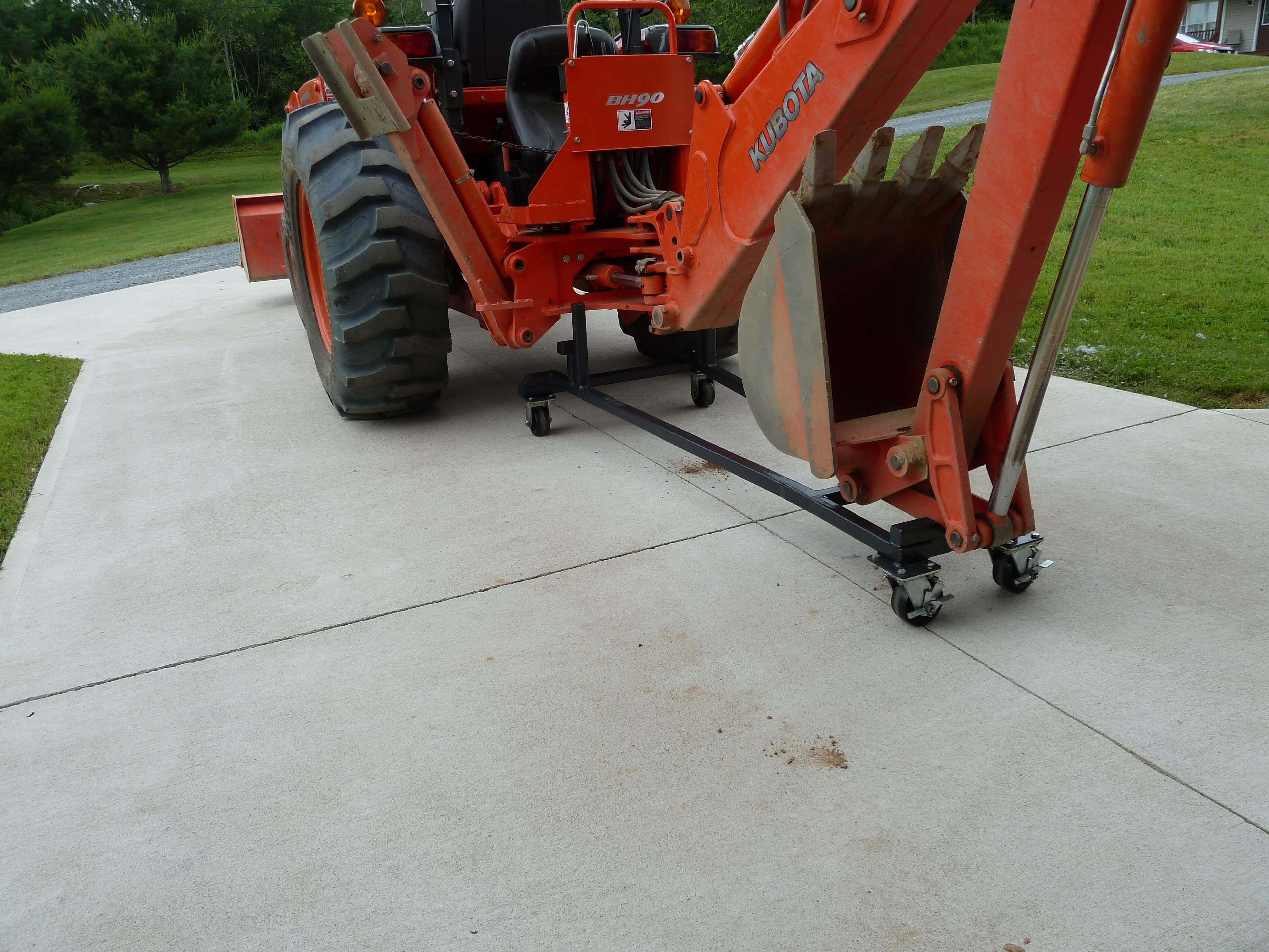

I know it won't help you now but a dolly will make the job way easier.If you will be removing the BH on a regular basis it is certainly worth the effort to make one or have one made.I have a dolly that I made for my BH90 and it makes the job almost effortless and very quick.Also the dolly allows the outriggers to stay up which requires less space in your garage and the whole unit can be wheeled out of the way.

/ Removing BH77 #20

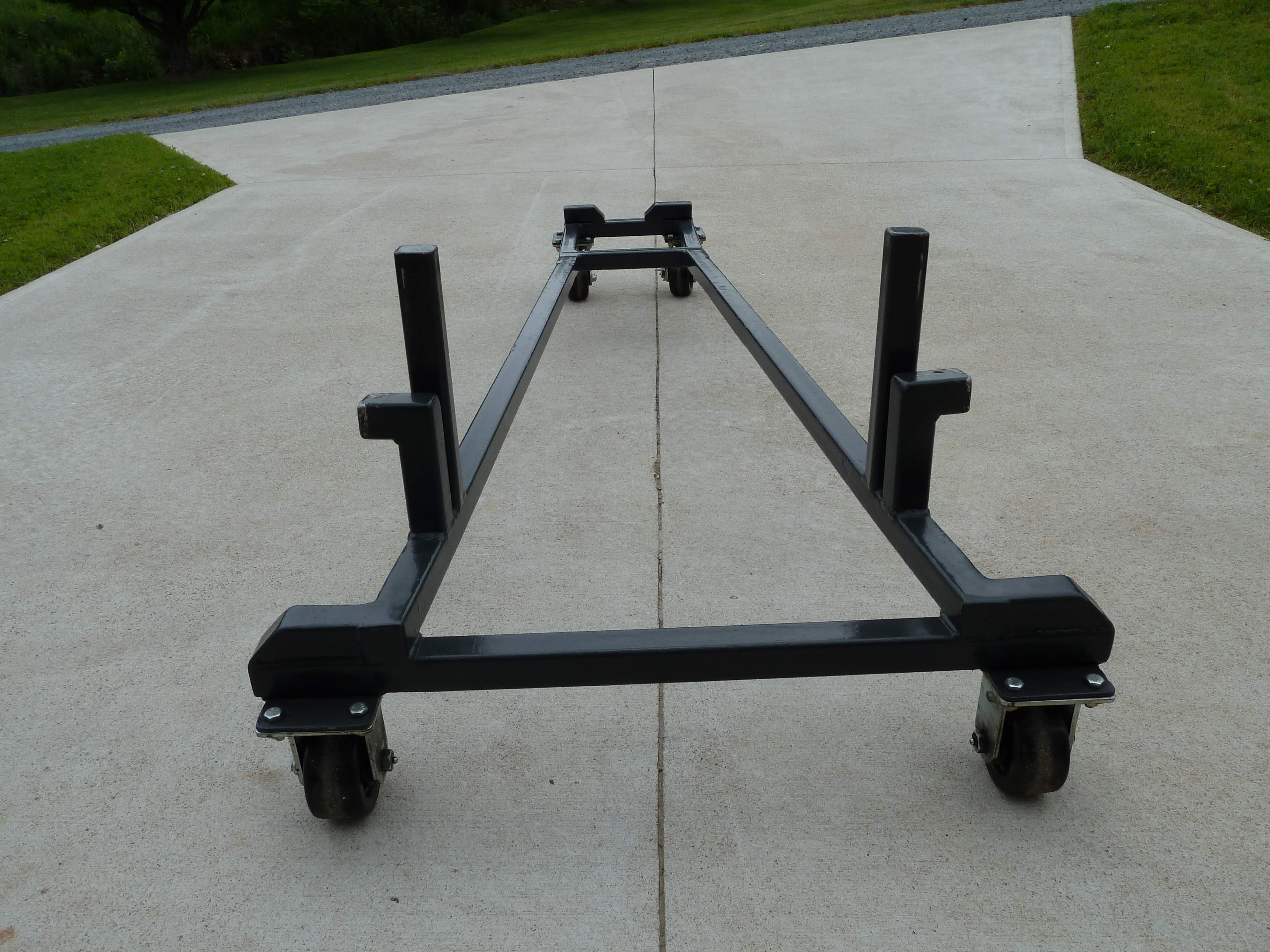

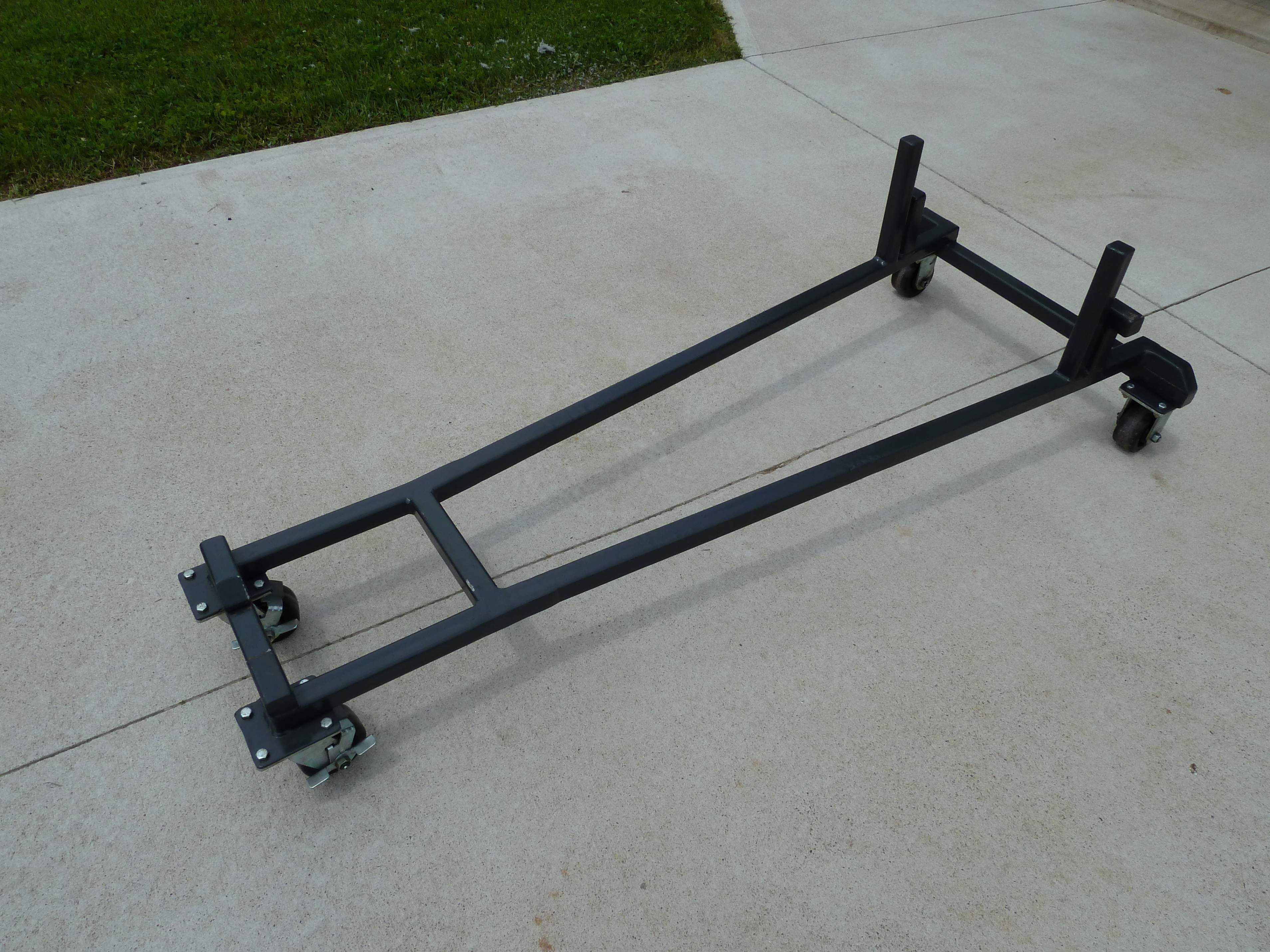

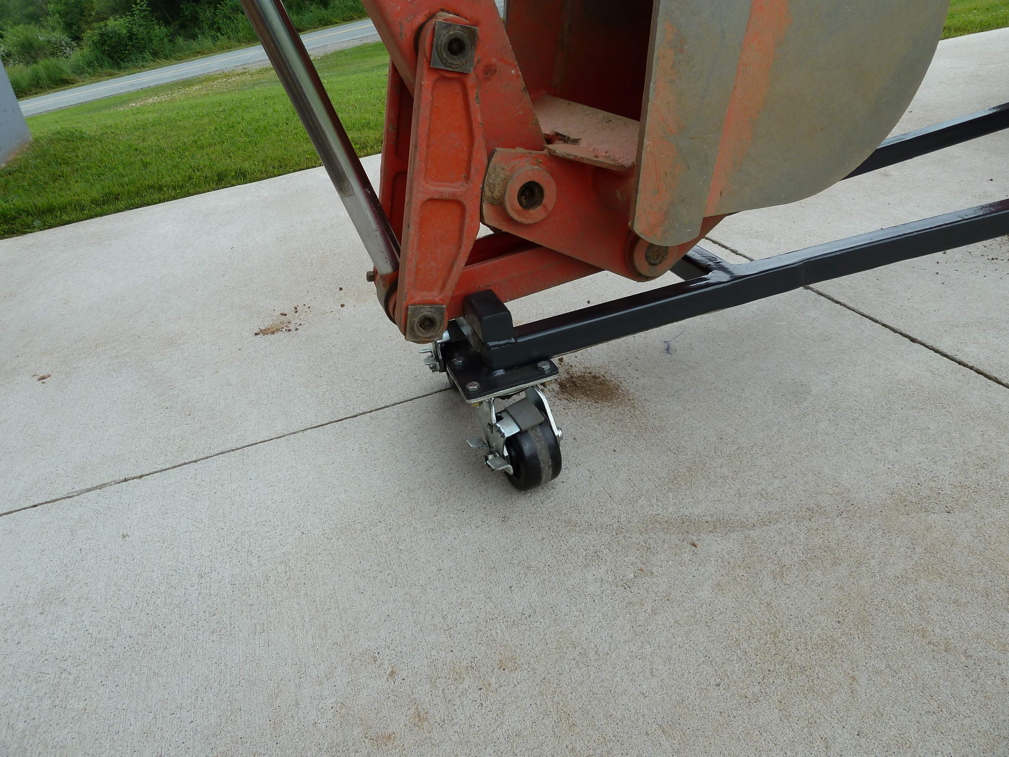

Kcender
Could you please post some pictures of your BH dolly??
I finally got some pictures of the dolly,been kind of busy.It is made of one and a half inch square tubing with three sixteenths walls.The casters are four inch because I already had them but they could have been six inch.There are different ways to make a dolly but this is my version which seems to work fine.
