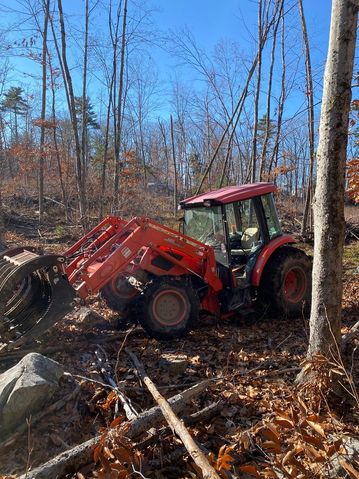

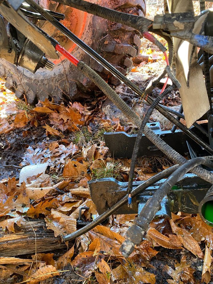

Here's what can happen, even with a subframe if the tractor is stressed beyond design. Note his subframe sitting on the ground in the first picture. These pictures were from a post earlier this year. Apparently, this owner was logging too. I call it a Dead Kioti.

Looks like a good reason to leave it on
   / Removing a Subframe from a FEL. Issues? #17
I support the thought that if the sub frame is in the way of ground features, you're driving your tractor over ground for which it is not intended. If you're tip toe delicate doing this, just to get from A to B that's one thing a little not ideal. If you're skidding out logs while traversing such ground, that's a lot not ideal. Perhaps keep the tractor where it's intended to be, and winch the logs out.
I think I saw this for sale on Facebook or craigslist! I think they got it put back together... I think I'm convinced.
