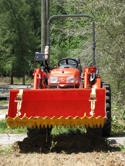

If you are seeking an excuse to purchase a new attachment, a Ratchet Rake bucket attachment is excellent at removing sod and smoothing small gardens.
You can purchase a Ratchet Rake through the tractorbynet.com STORE, button at top of this page.
Kubota B3300SU tractor-loader package in photos is almost identical to your L3000.
