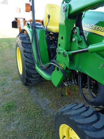

I realize this might be a resurrection of this thread-so be it. When you (or others) rout the hydraulic hoses from the rear remotes and you are now at the FEL post and your tractor has a FEL disconnect feature, do your hoses break there too? Not that a lot of us will ever remove the FEL but what if you ever need to?
kennyd,
Your posted photos of the FEL/grapple plumbing on your JD are how we all would want ours to look like! You are truly a mechanical surgeon. Now don't tell us that some tractor shop did that for you-unless it's your tractor shop.:thumbsup:

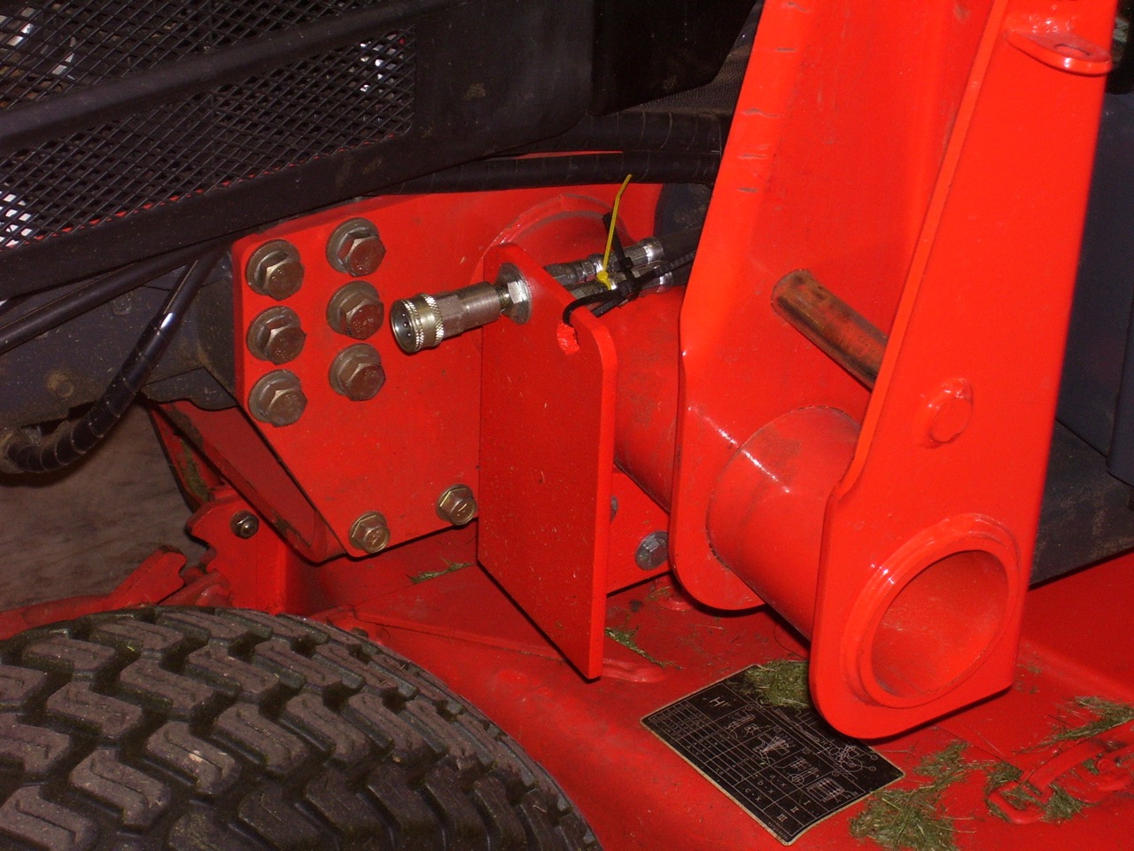

Here is how I made the break at the loader. NOTE: Only showing one disconnect as I was waiting for the second one as it was backordered.
Nice job srs, I see a hex nut that appears to be locking down the QC on the bracket. Does that allow the QC to go through a larger hole and then nut down? Silly me-I thought that maybe I would have to take the bracket to the hydraulic shop so they could thread it on before swedging???
When detached, do you have plastic caps covering the connector-I don't see one.

kennyd,
Thank you very much NP:eek: I assure you it's all my handiwork!
NP, just like J_J said and I do have the plastic caps now installed but not shown in the pics.
